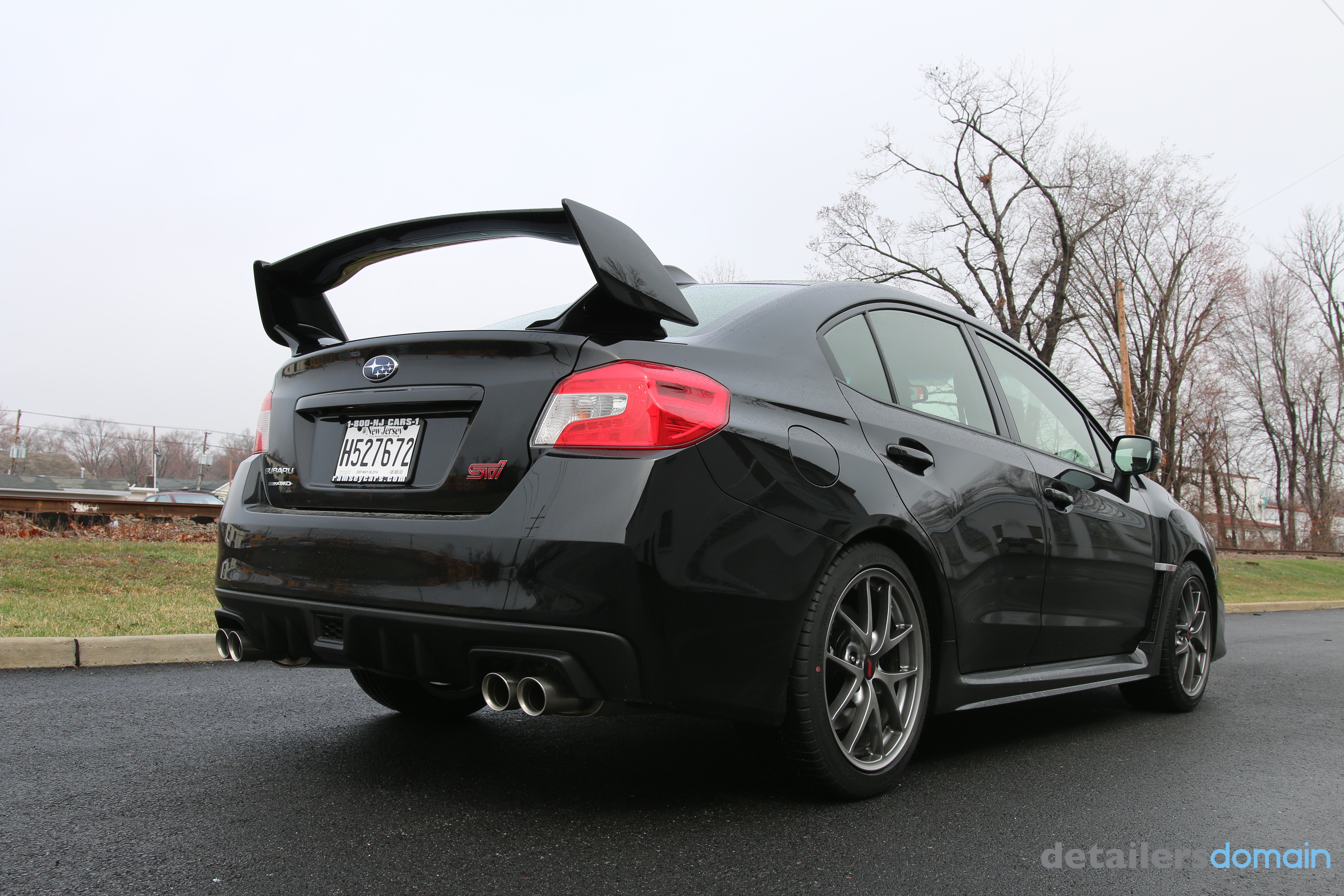

A very good customer of ours picked up his new Subaru STI, at delivery he already noticed that it was in pretty bad shape, but he knew he was coming in for a new car prep and Opti Coat so all was well.
That being said I'm still surprised at how dealers just don't understand how to deliver a car. Why not train your crew to do it right?

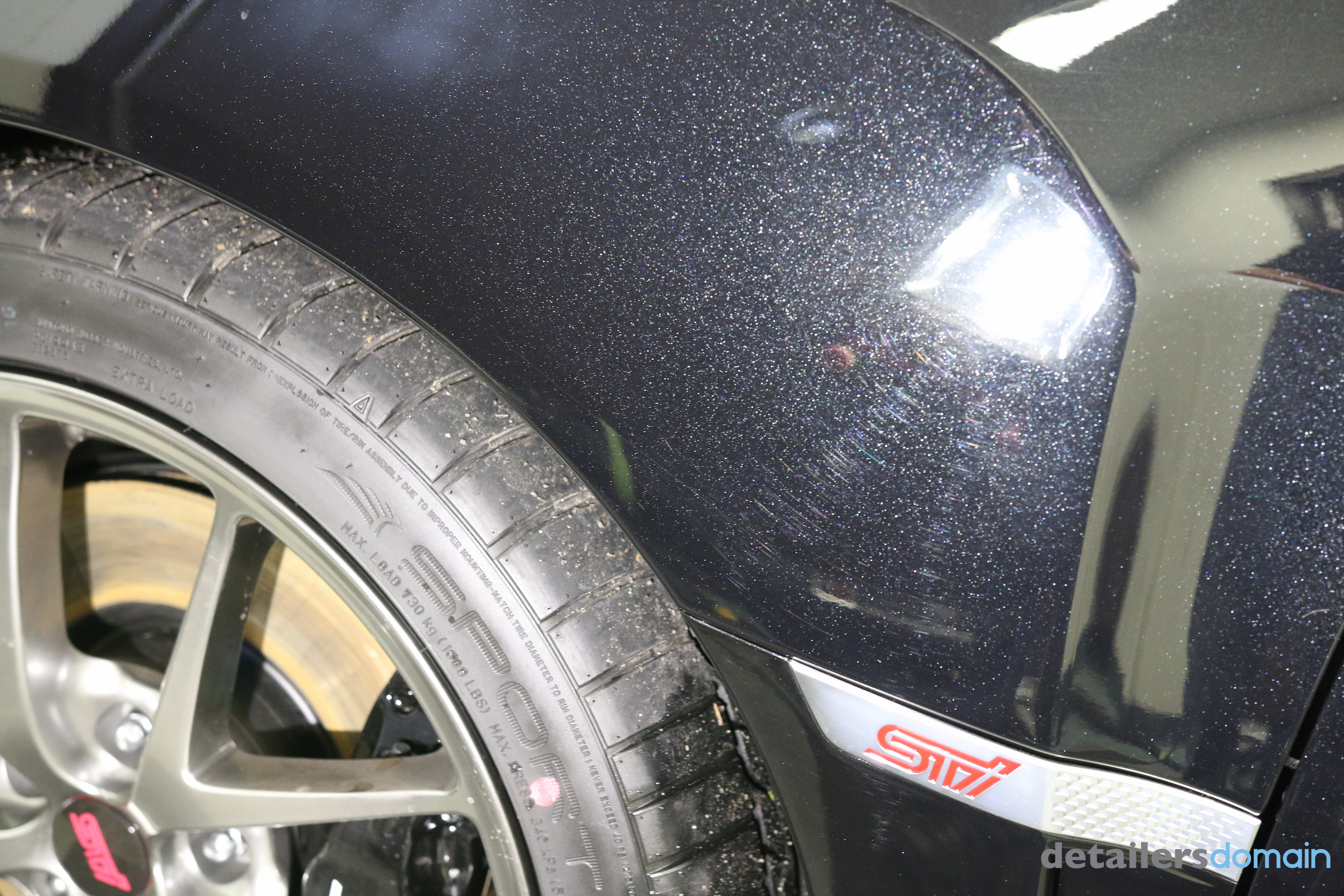

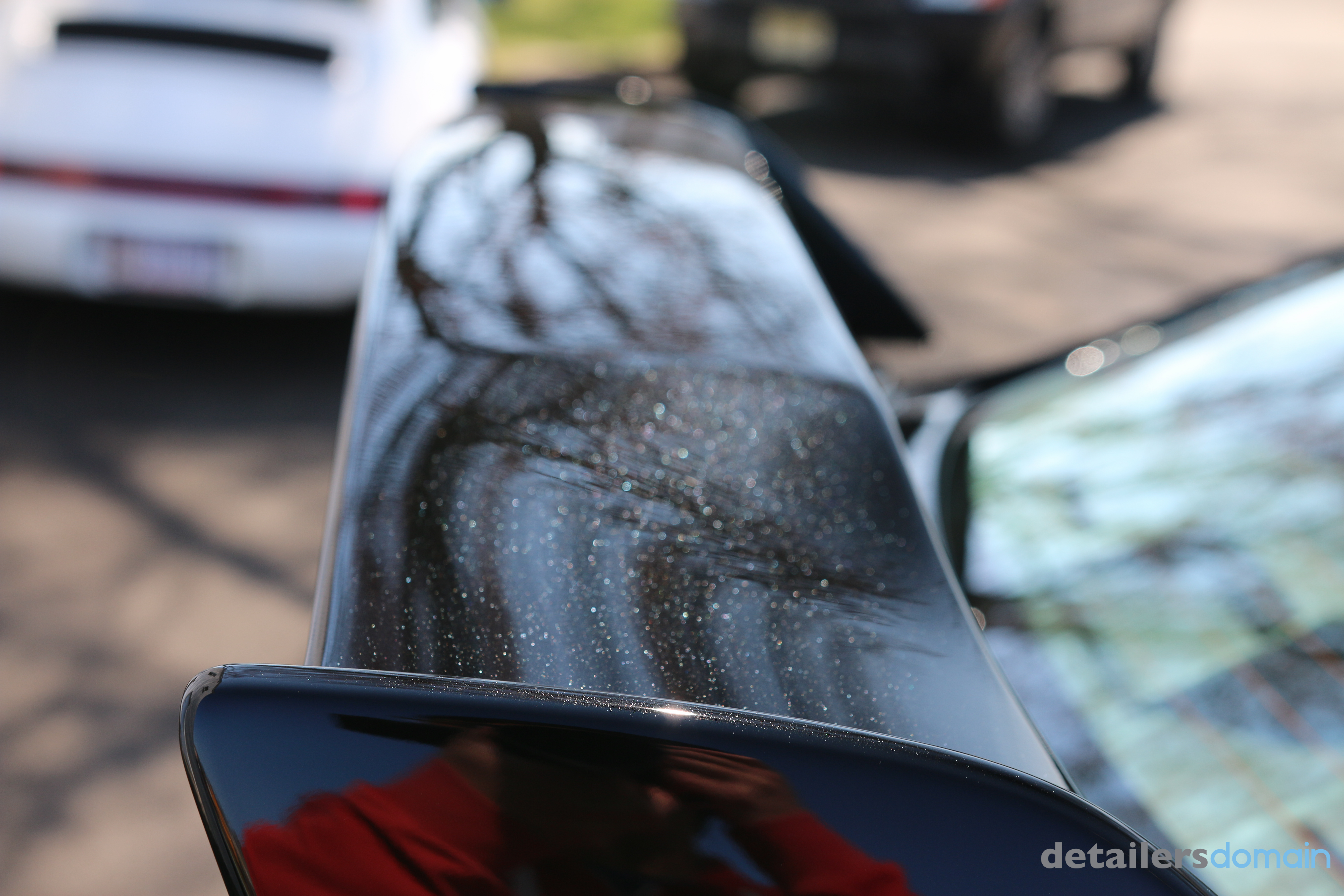

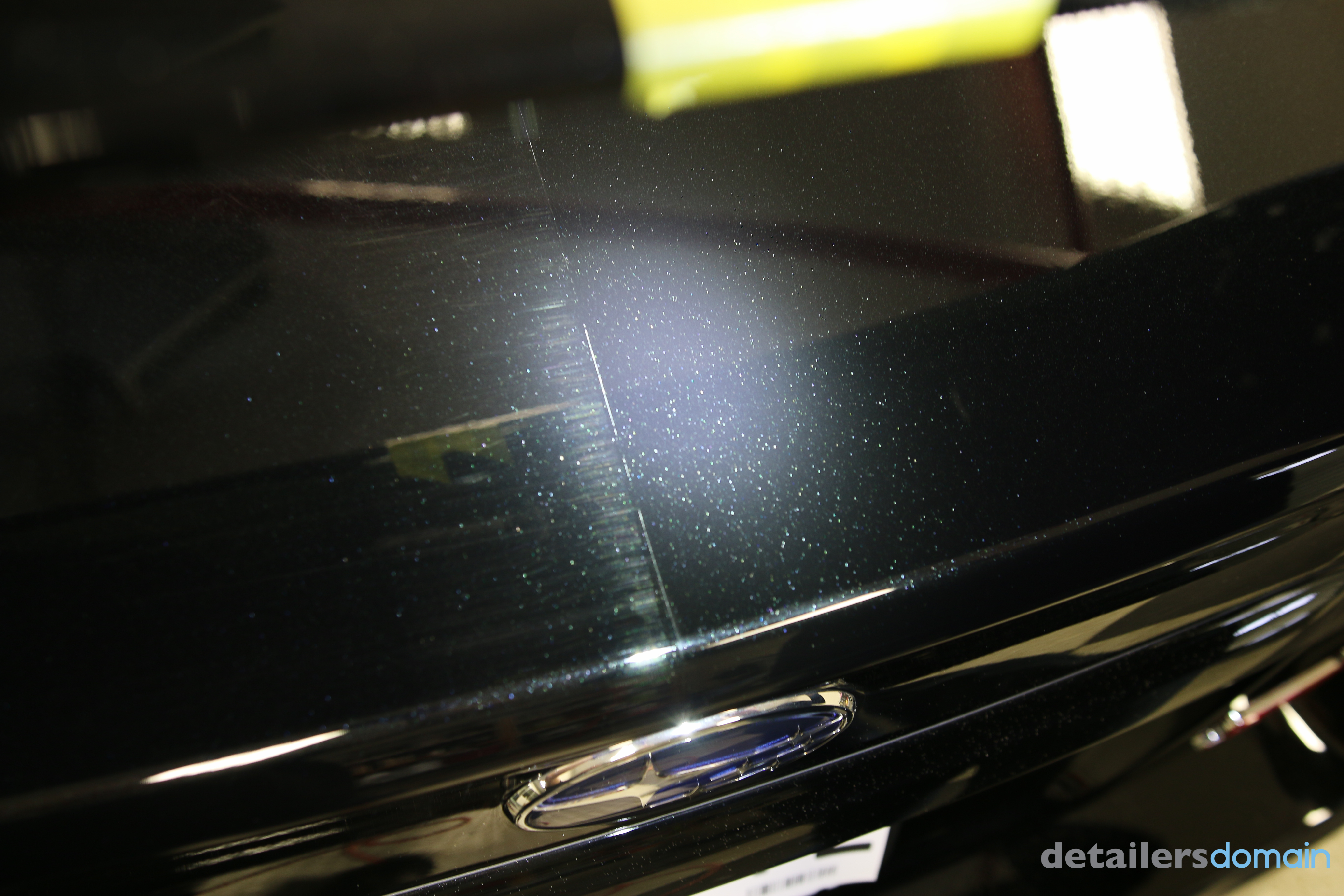

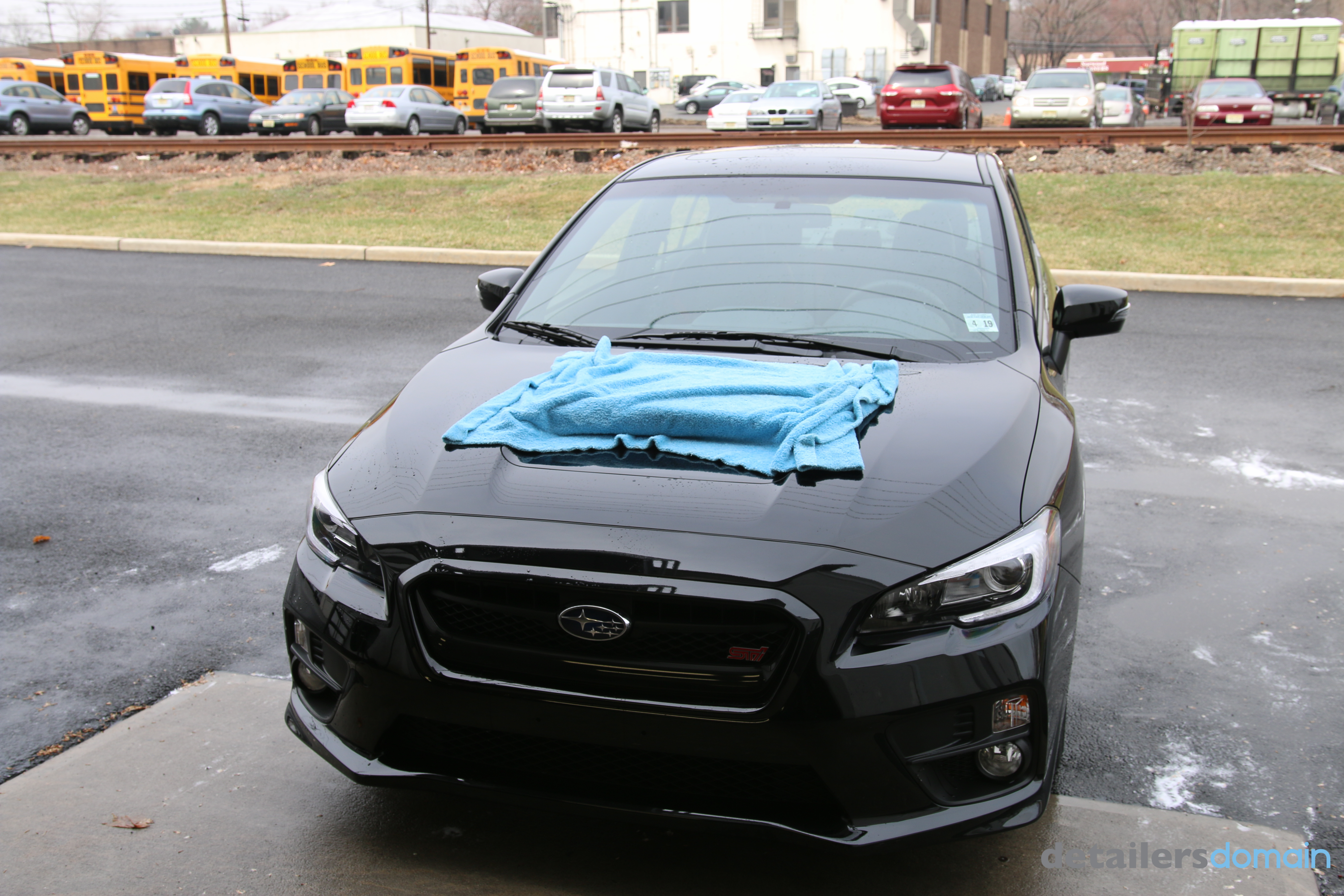

Before

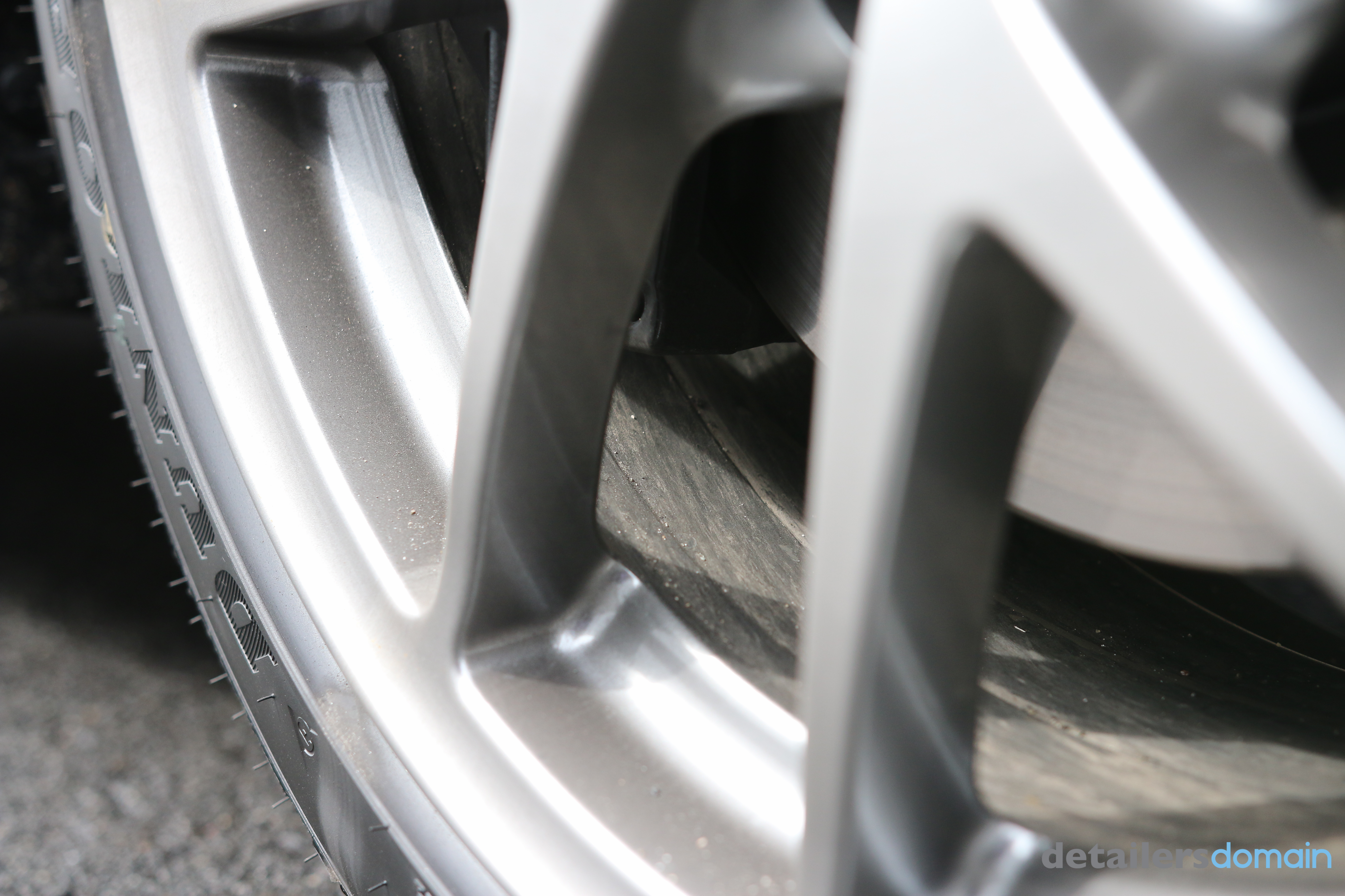

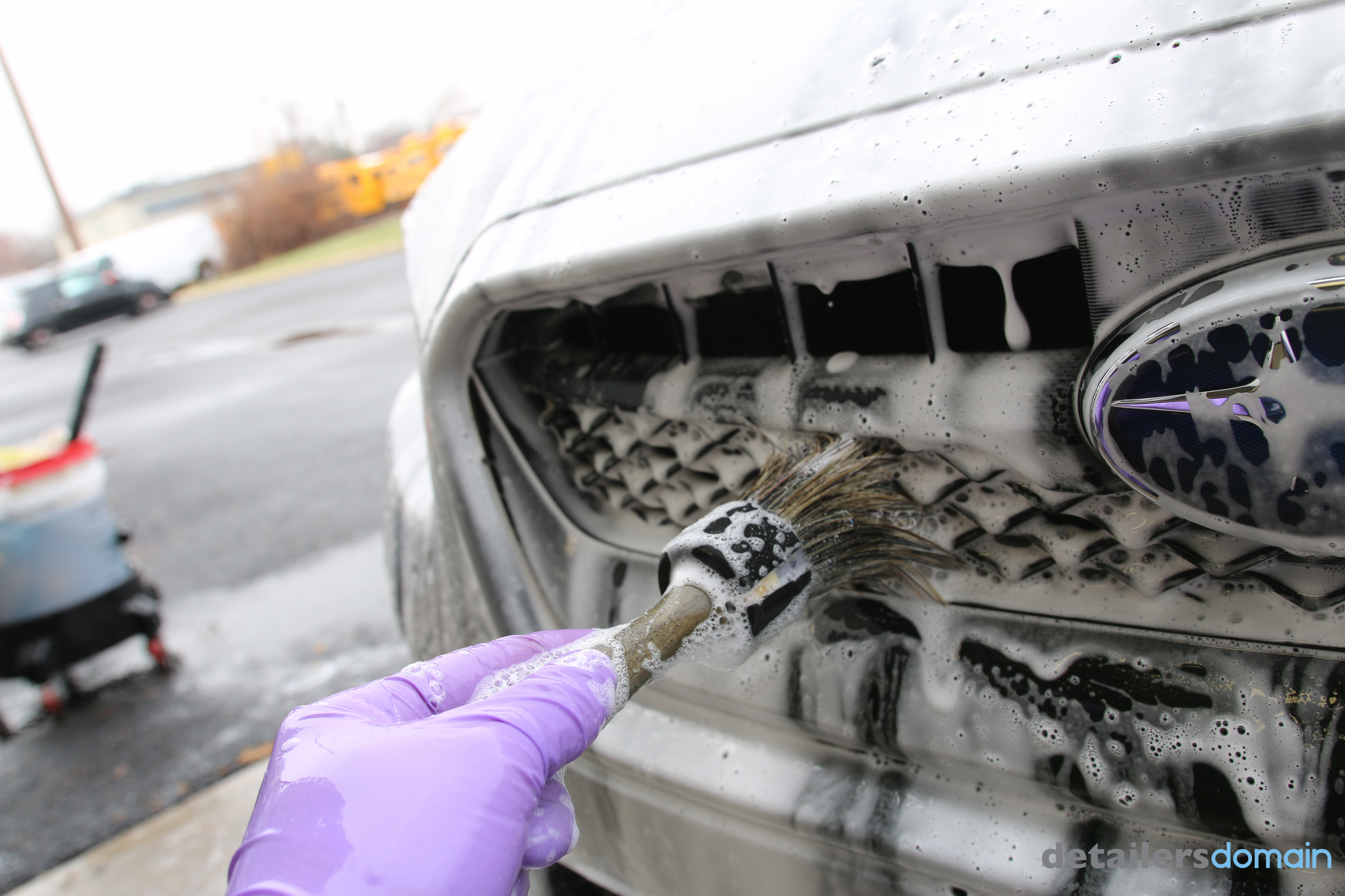

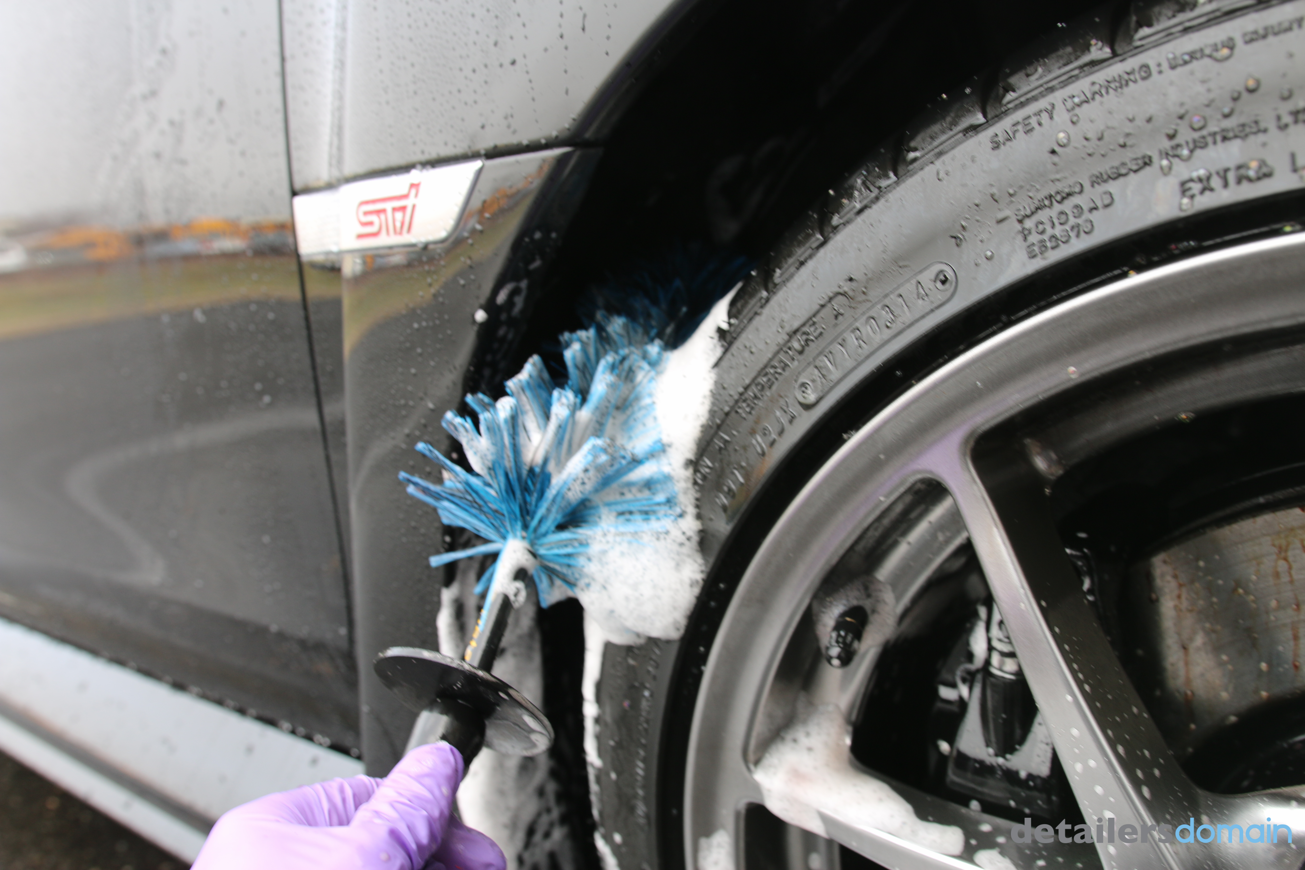

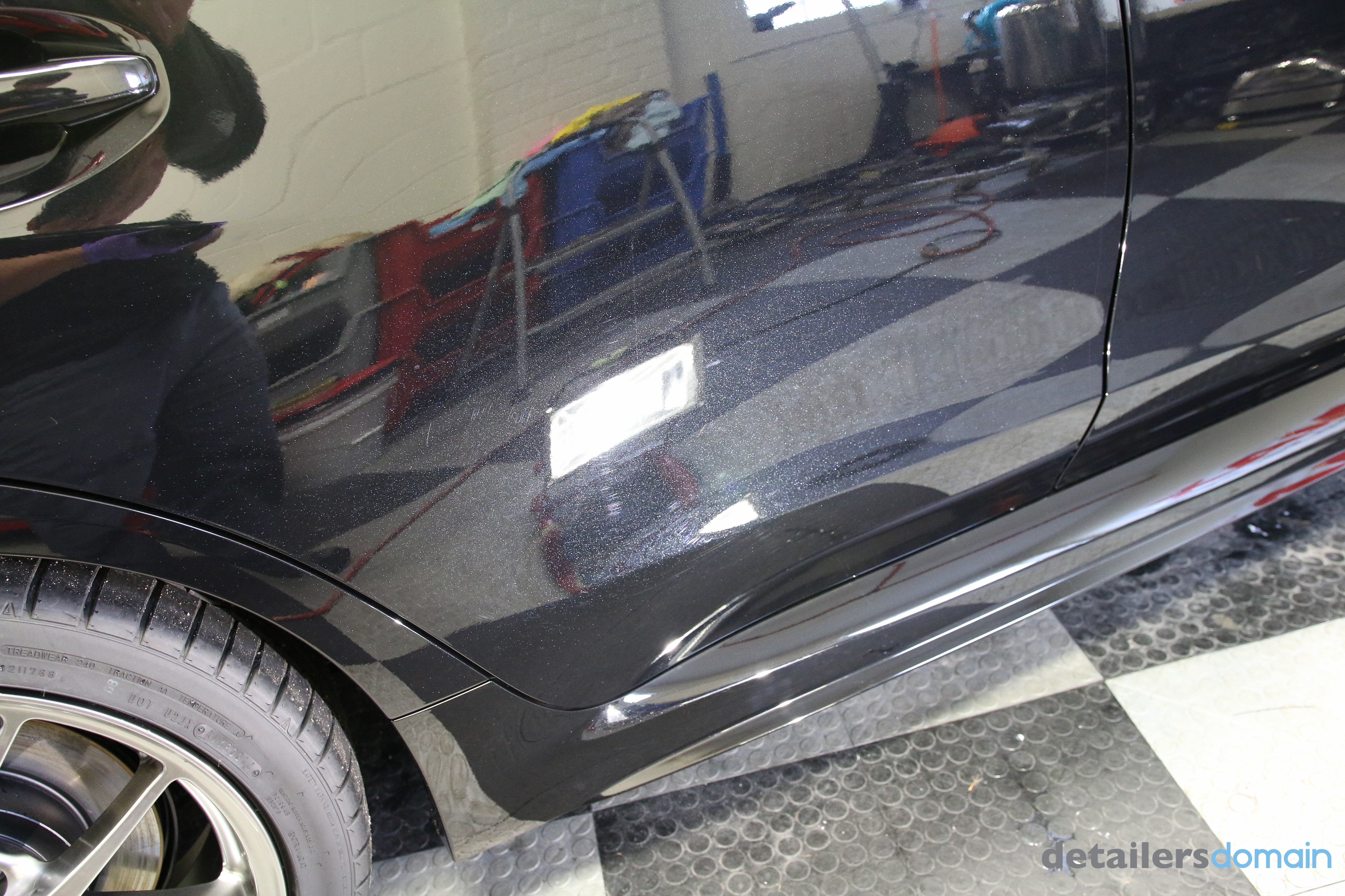

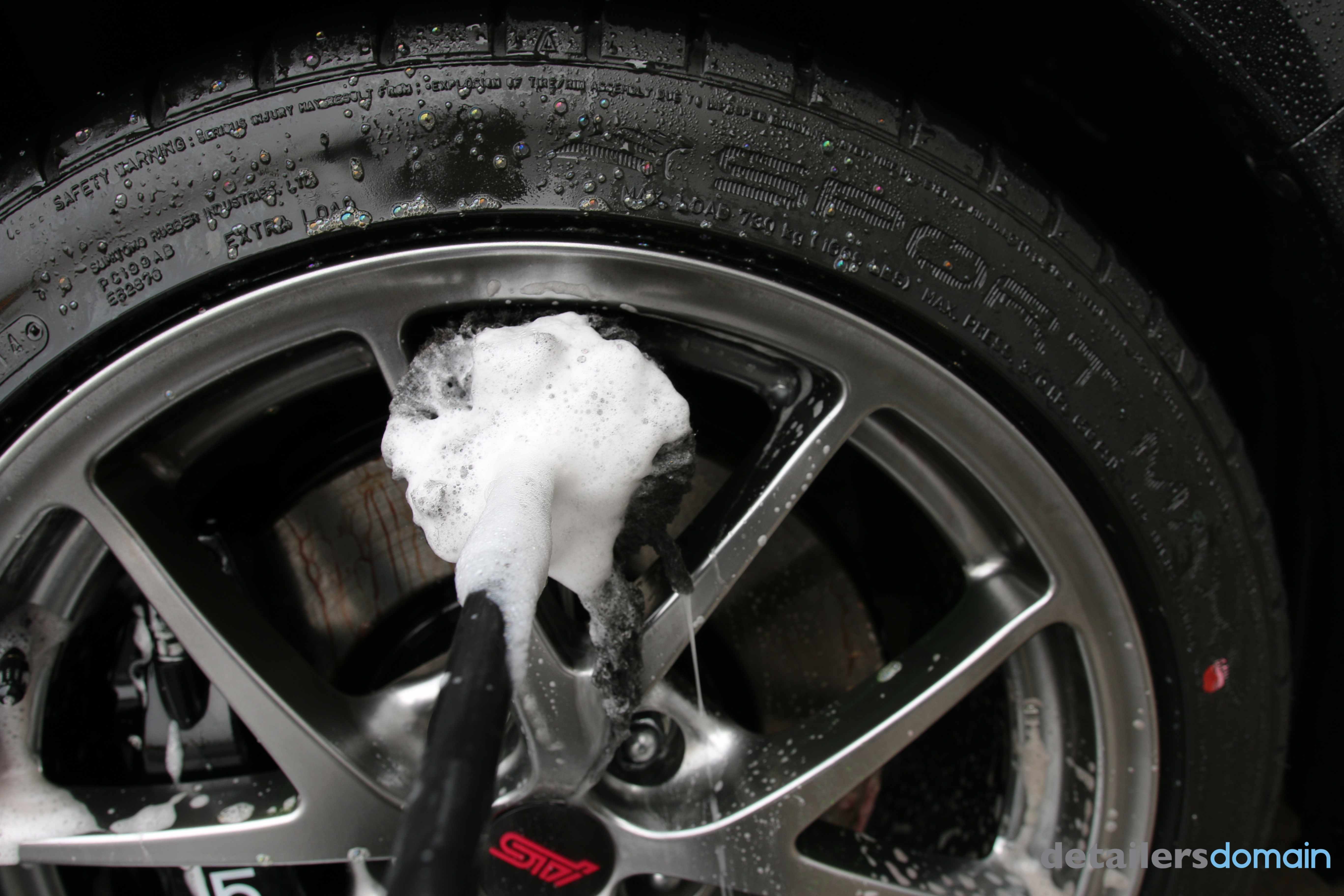

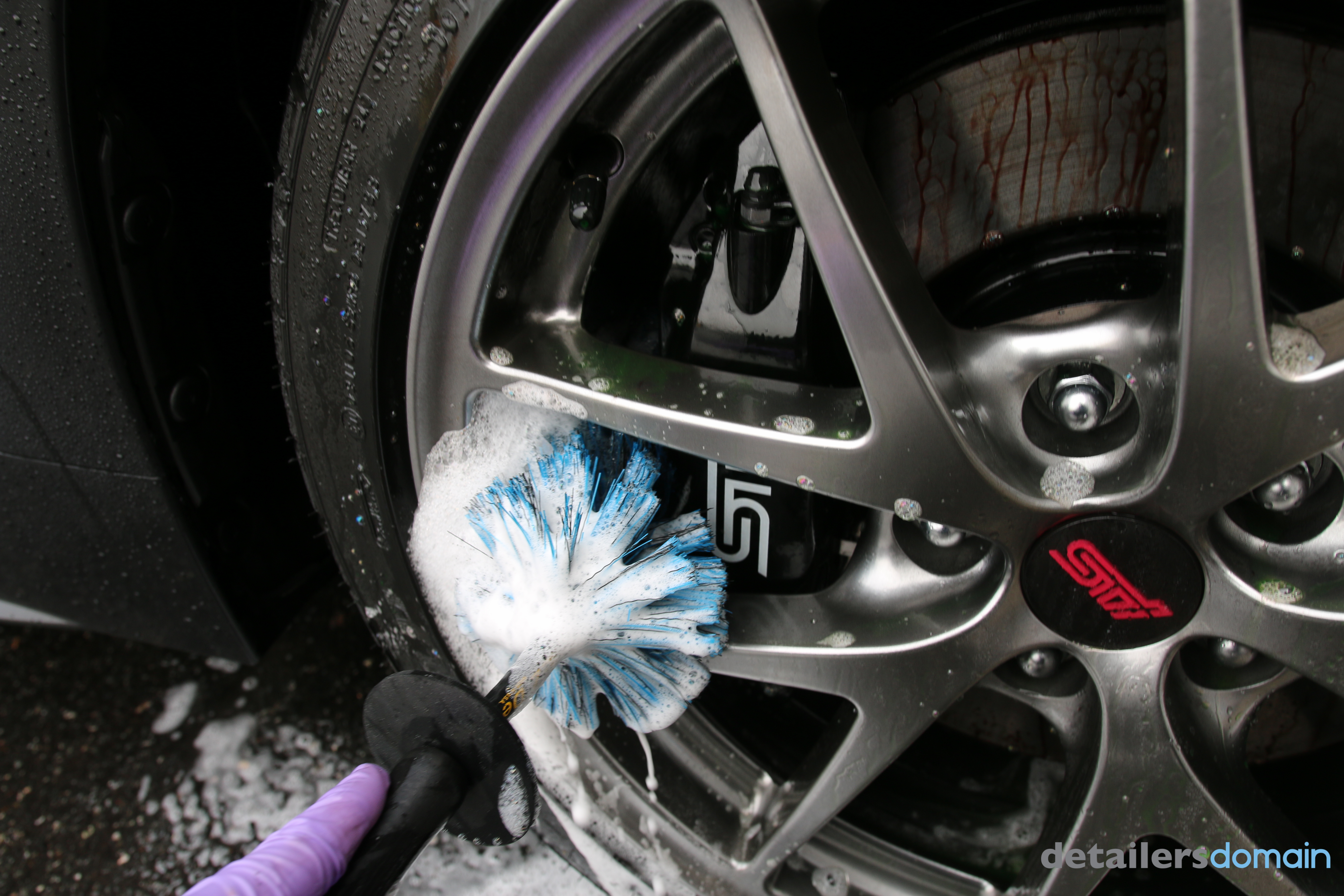

Prep - wheels, tires, wheel wells cleaned up - car washed, decon'd, and clayed.

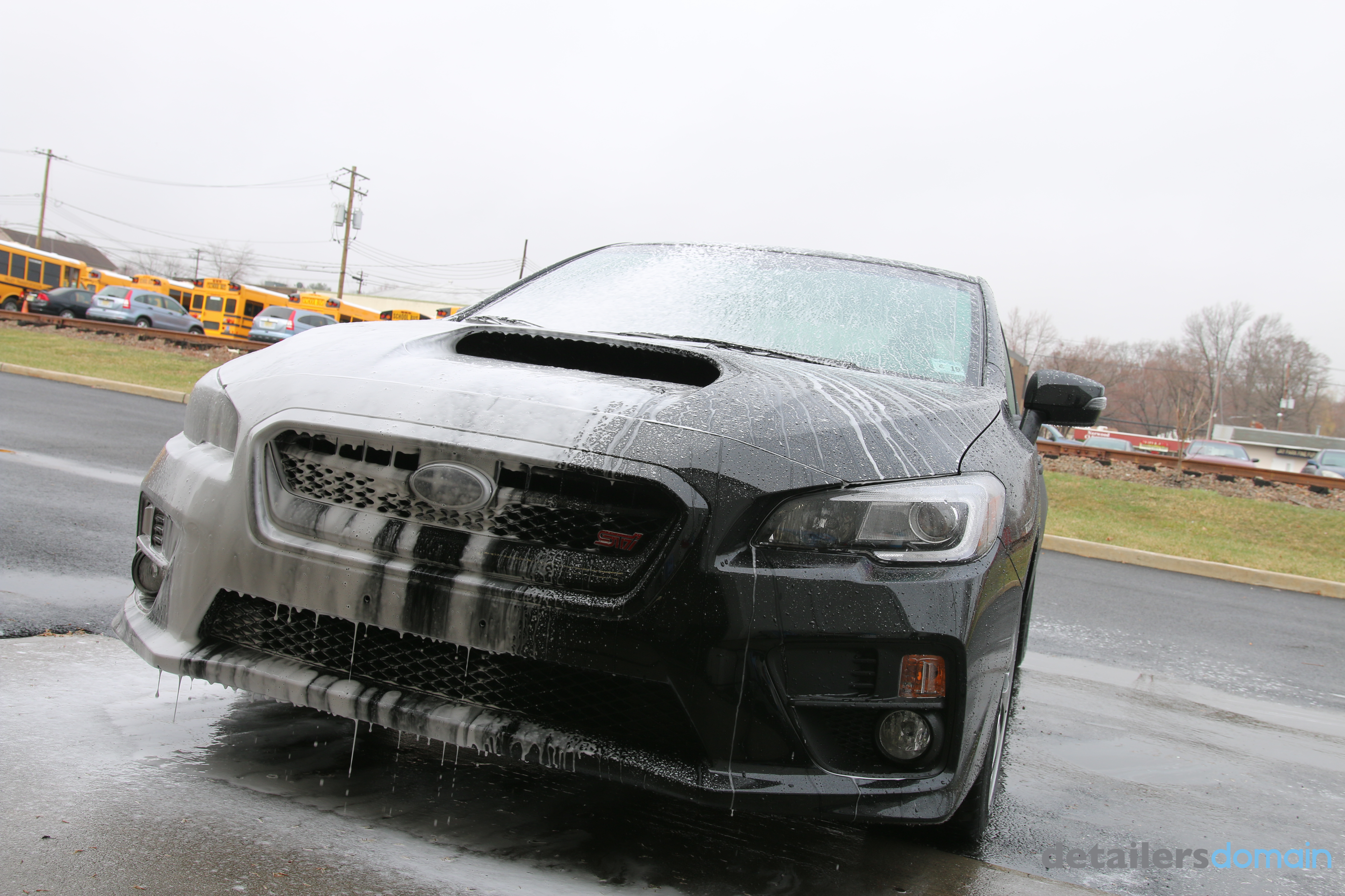

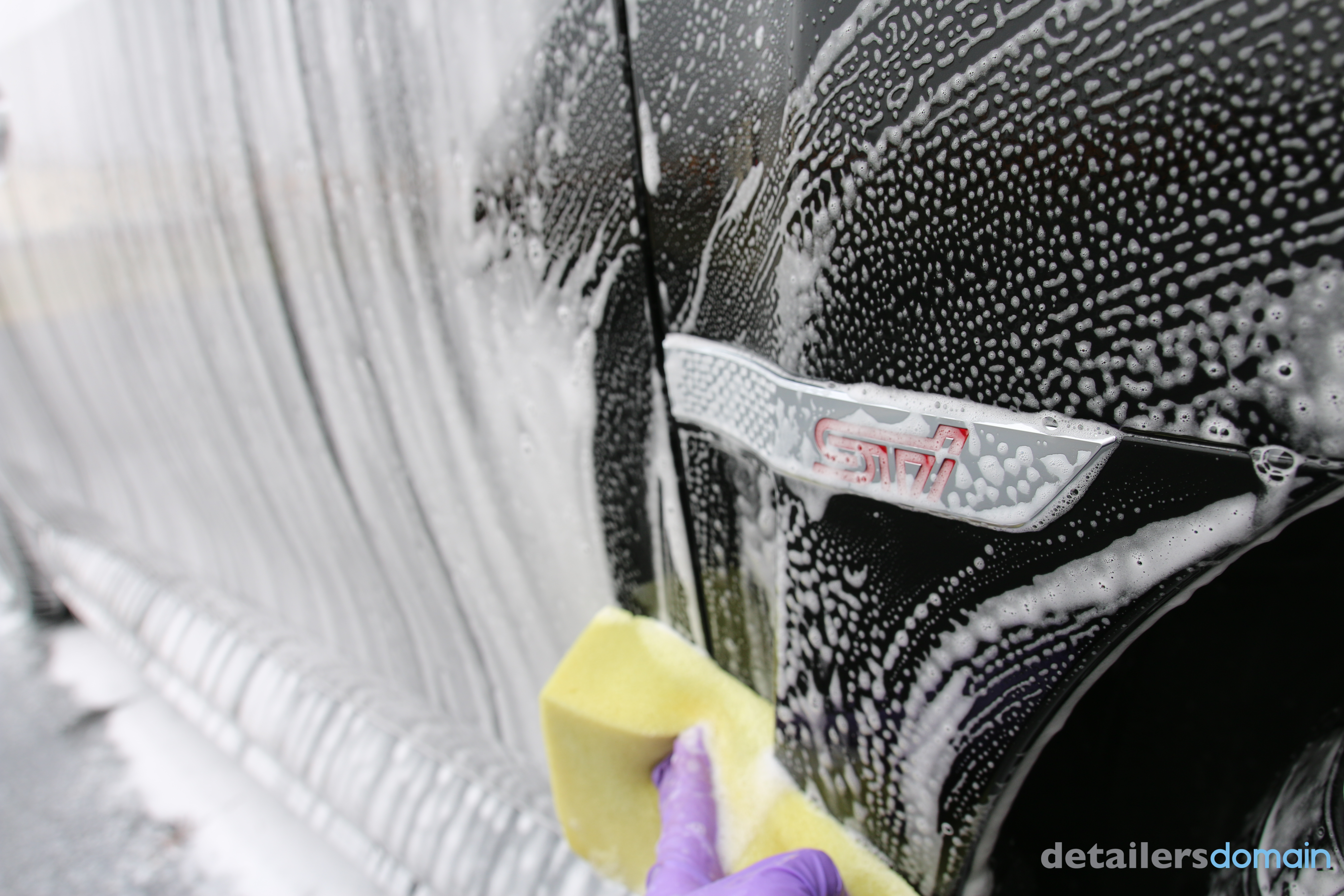

Using the Uber Wool Wash Mitt for the tops and the Uber Yellow Wash Sponge for the bottom of the car. We do this to prevent dirt getting into the mitts and potentially scratching the paint.

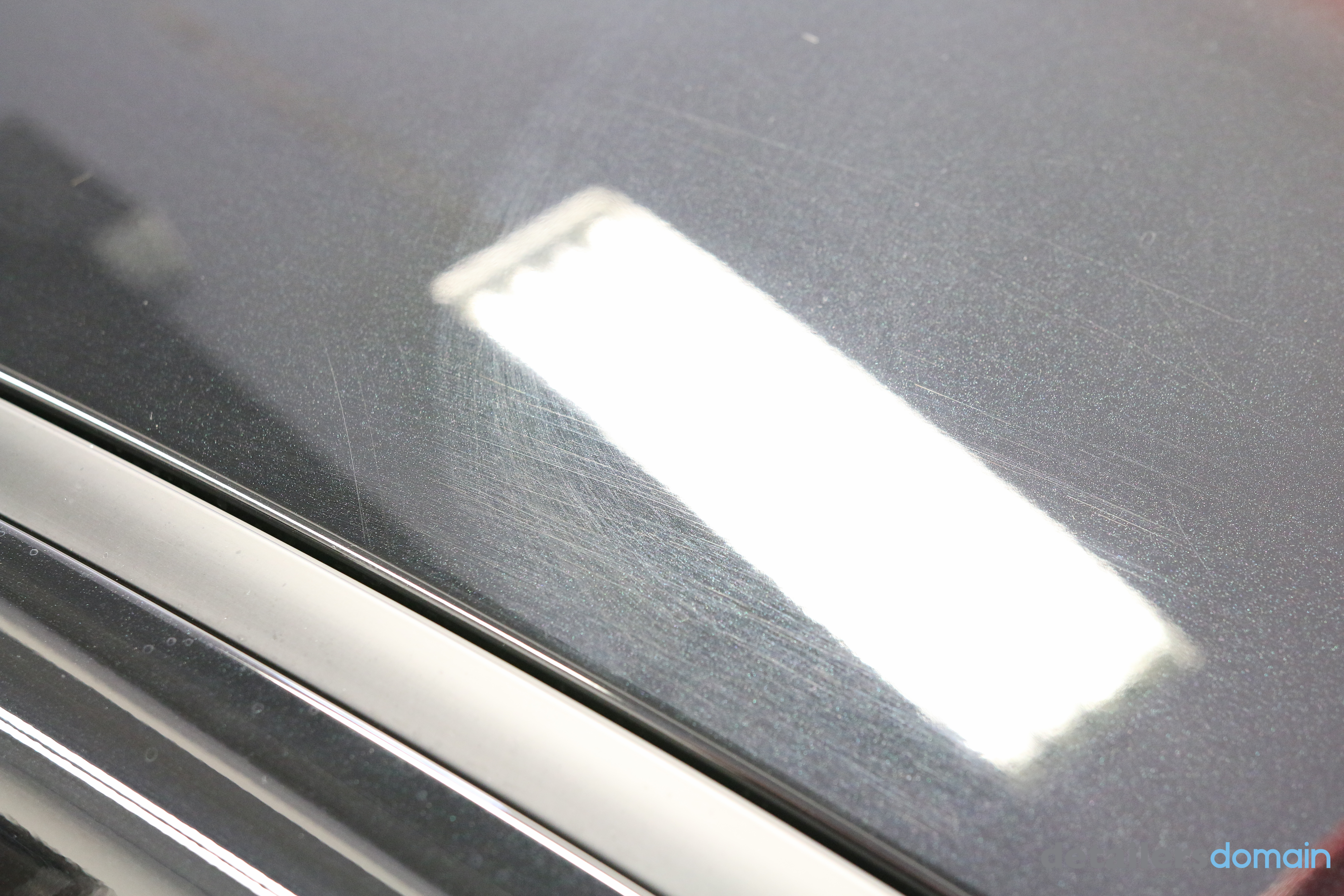

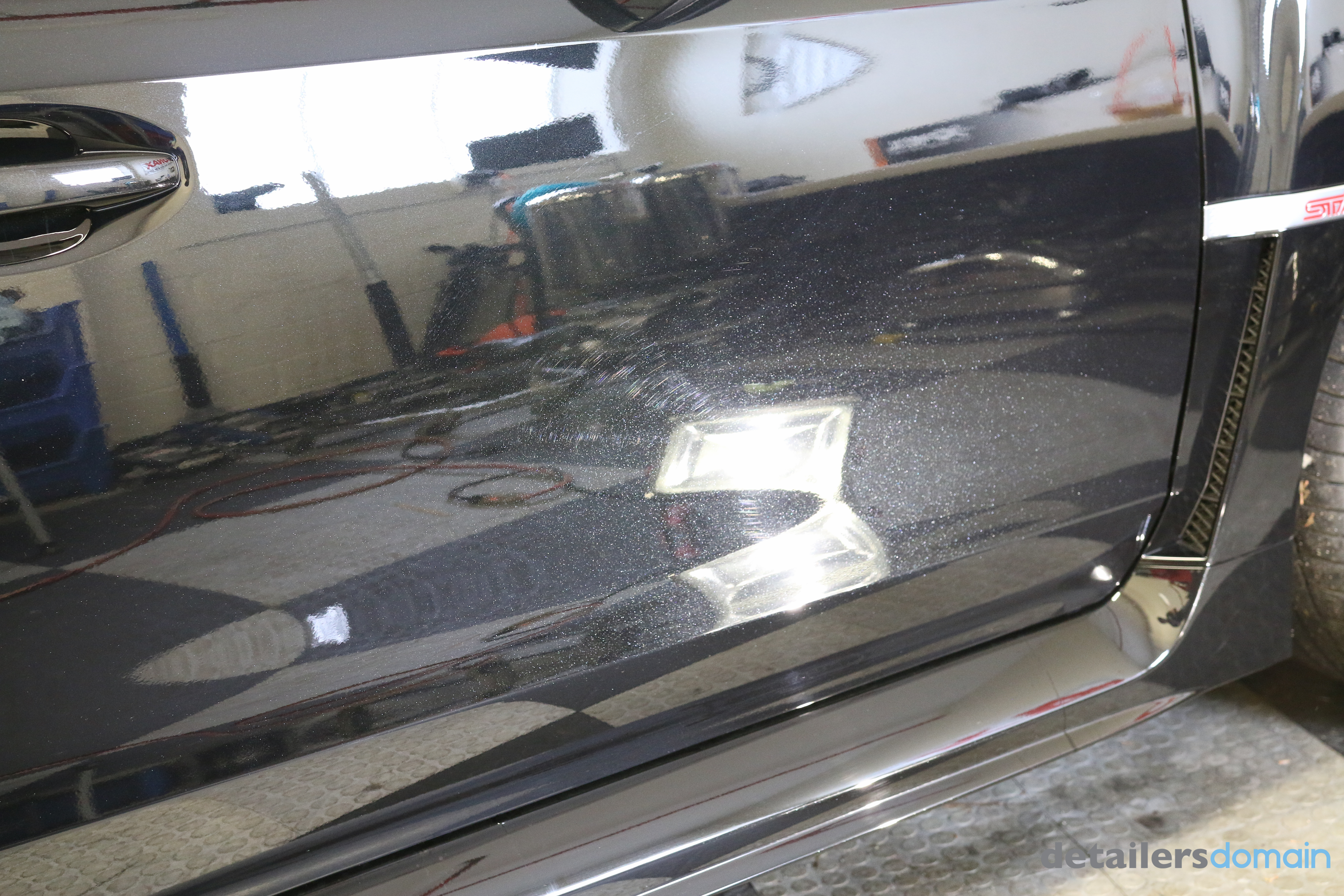

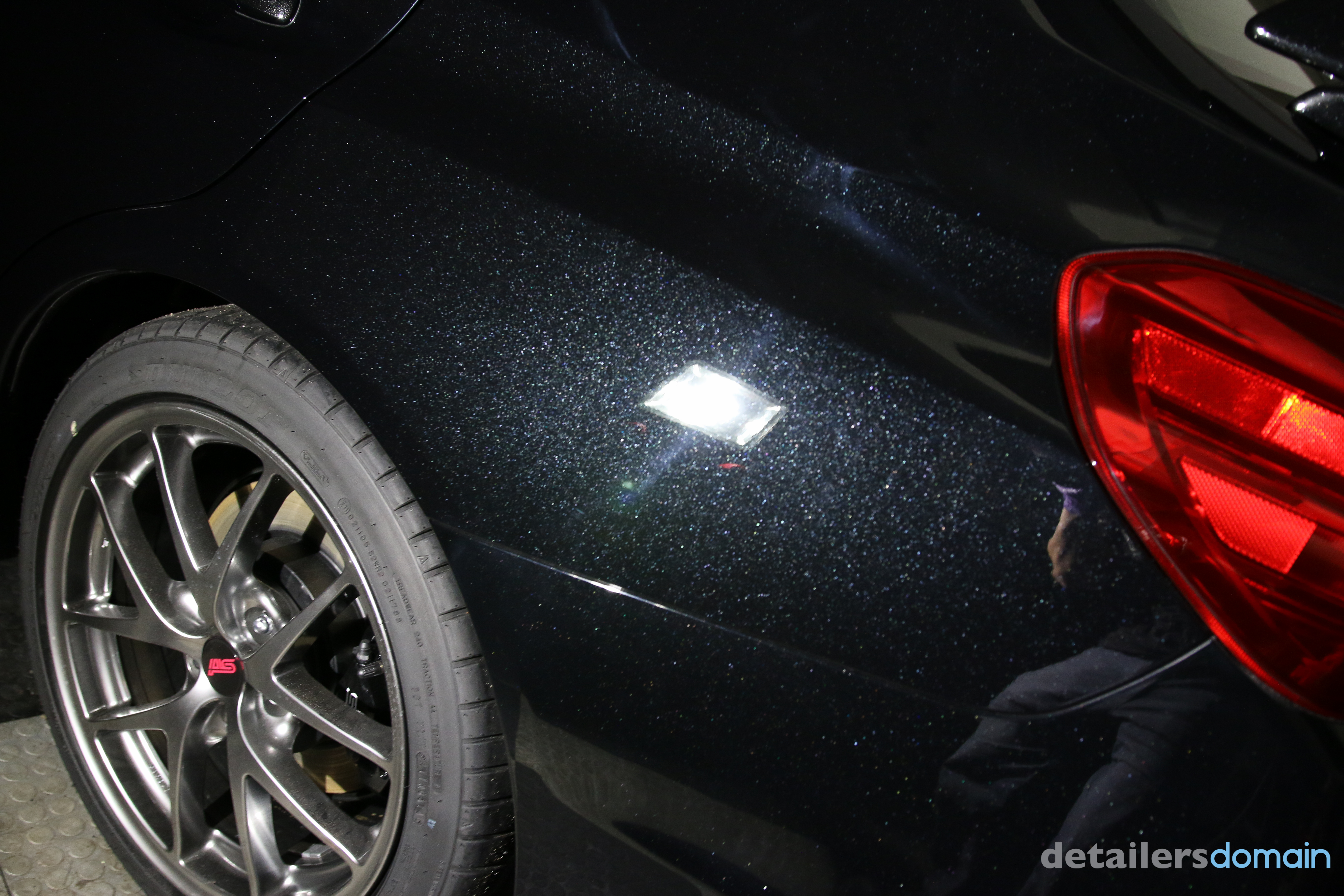

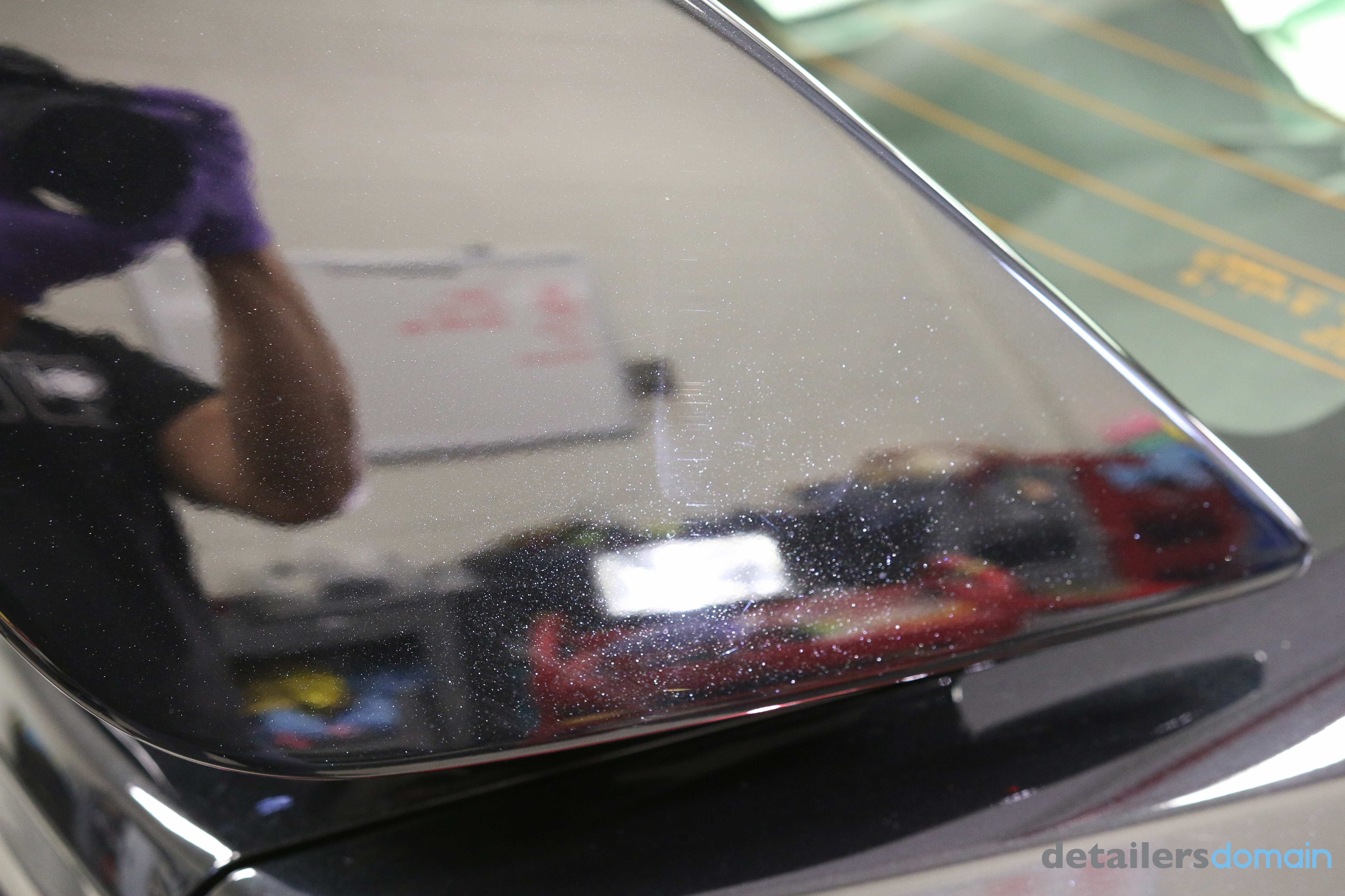

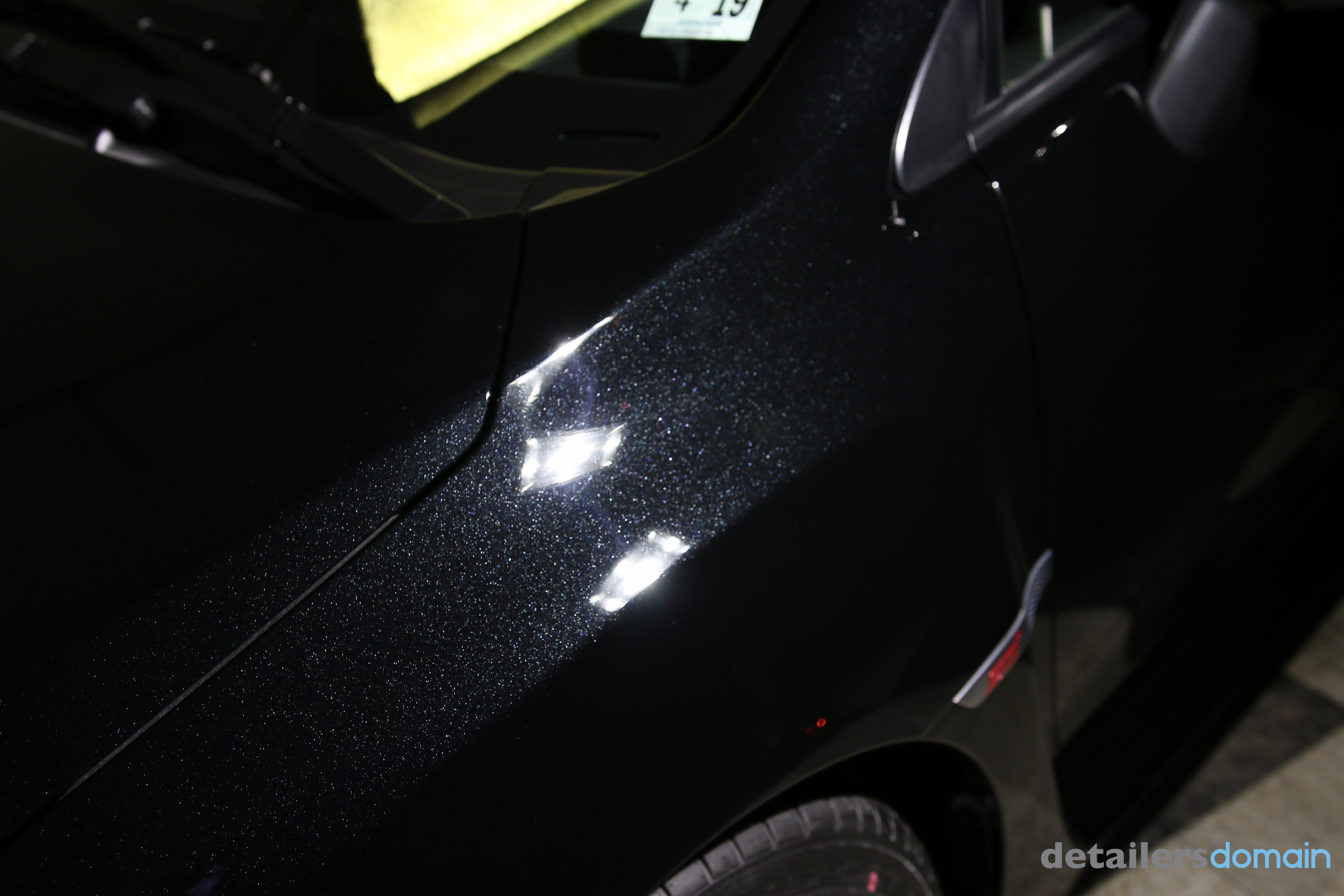

Paint correction

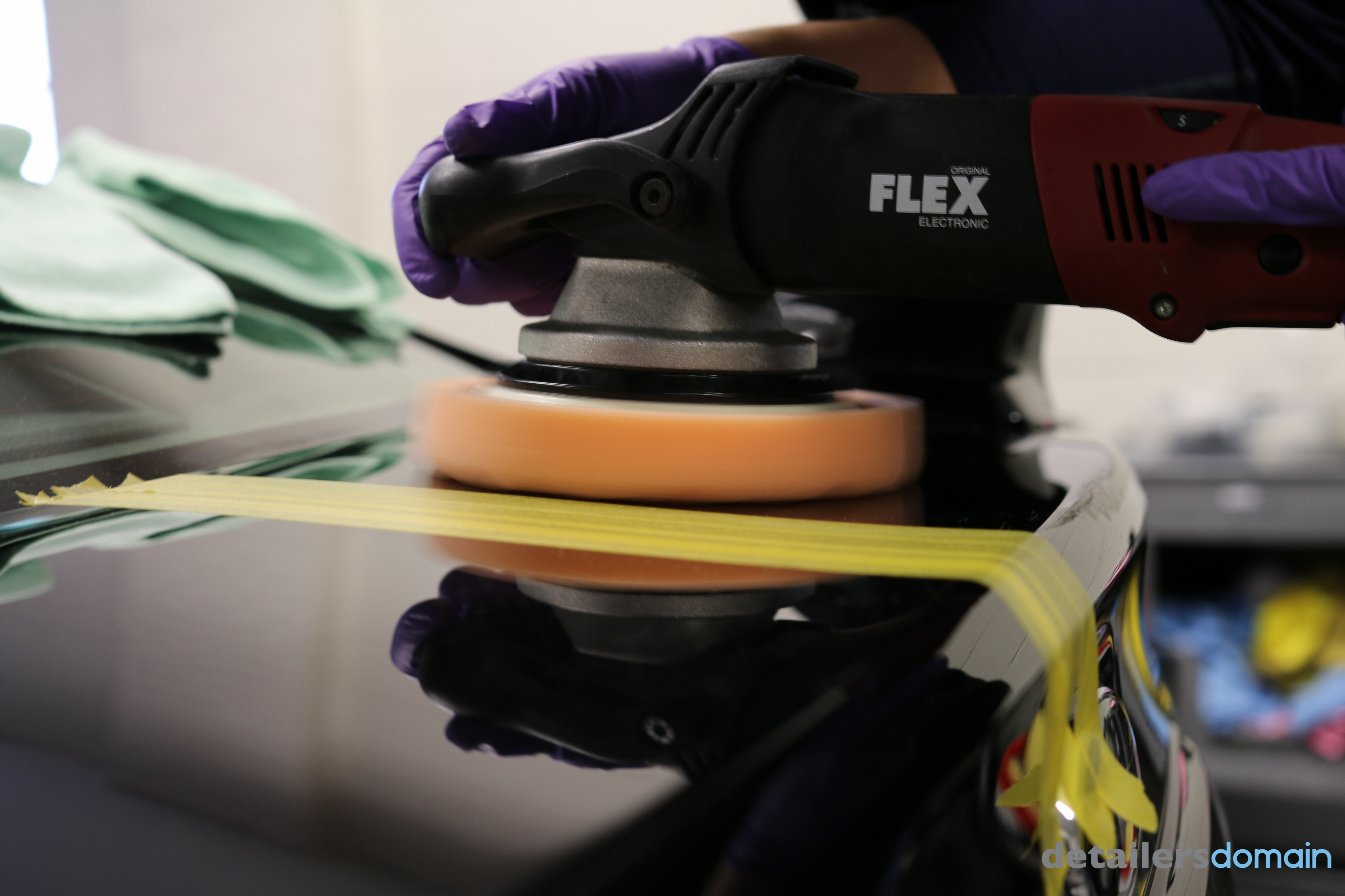

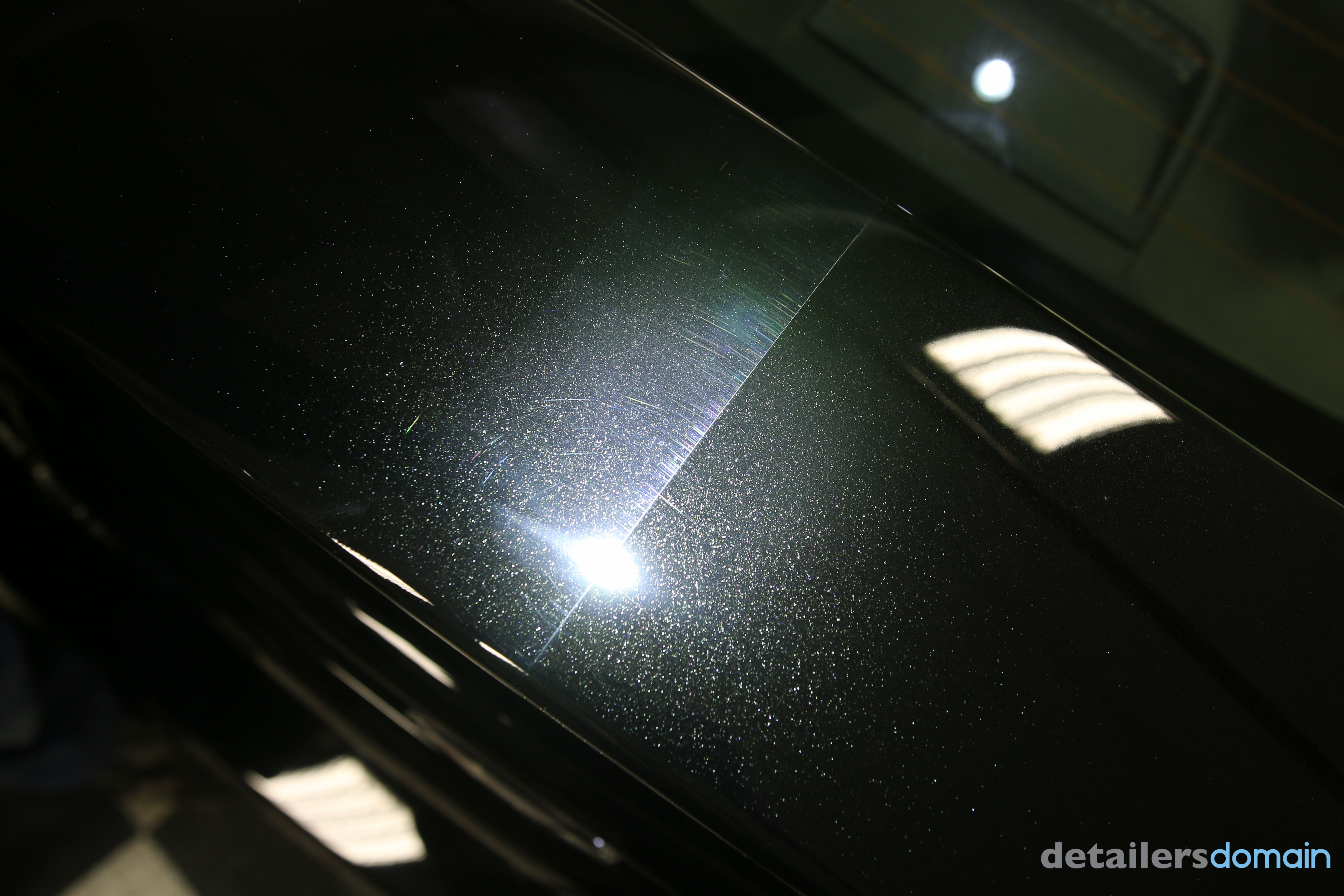

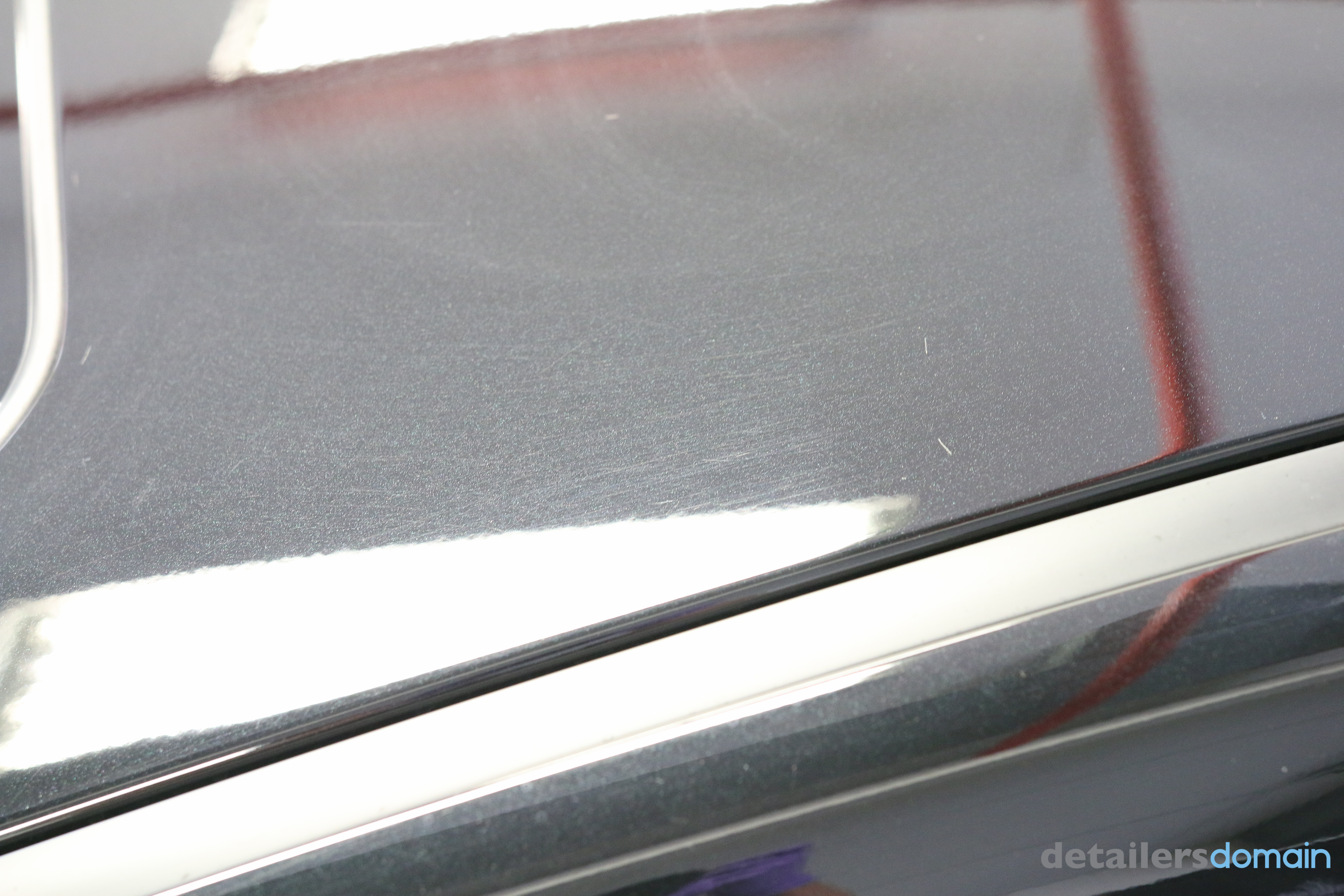

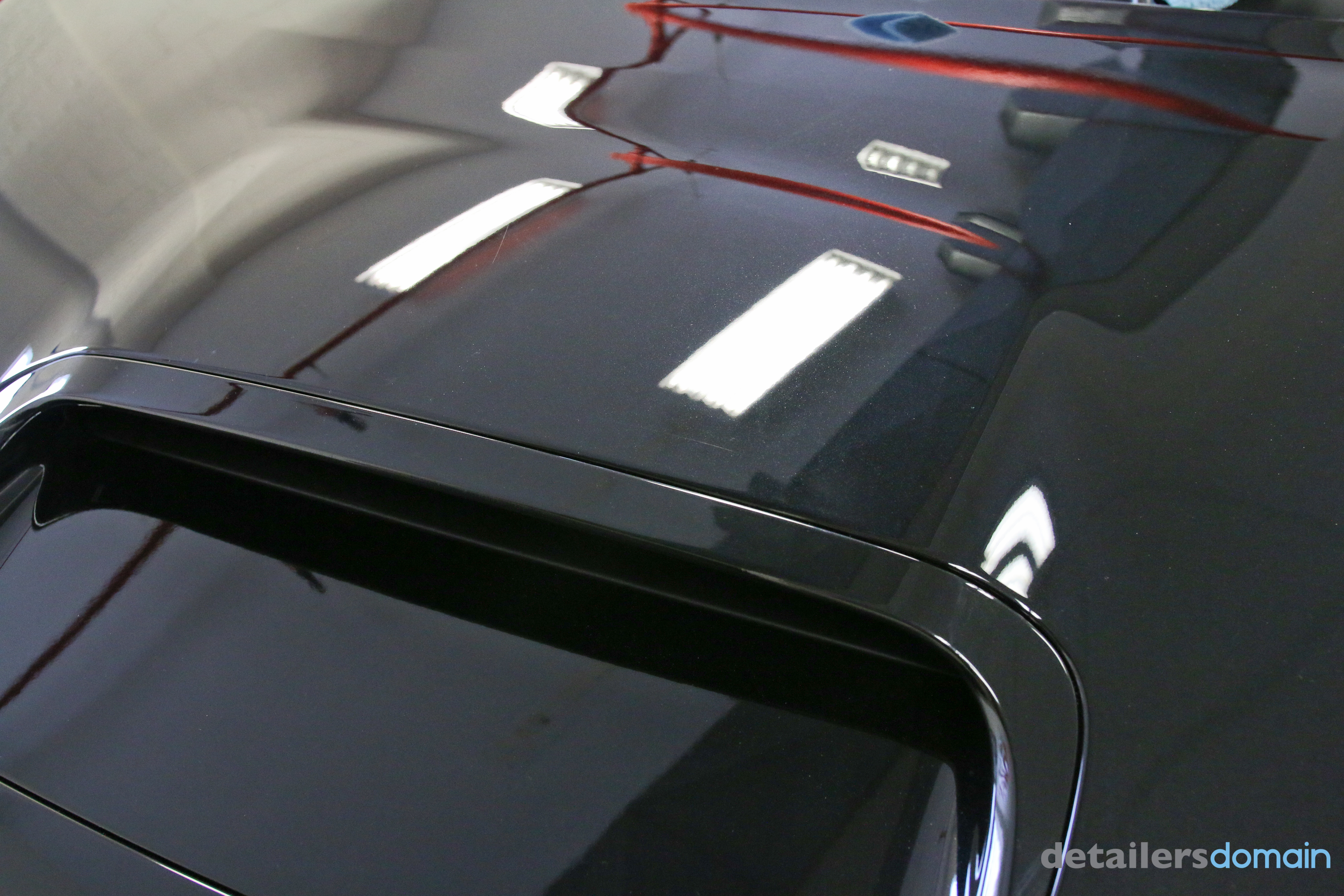

Using the Flex XC3401 to get linear scratches off the wing and rear deck lid.
Using an Adam's Orange Pad and Adam's Paint Correcting Polish.

50/50 shots - left side before - right side after.
Surprising how dull the paint was on a brand new car.

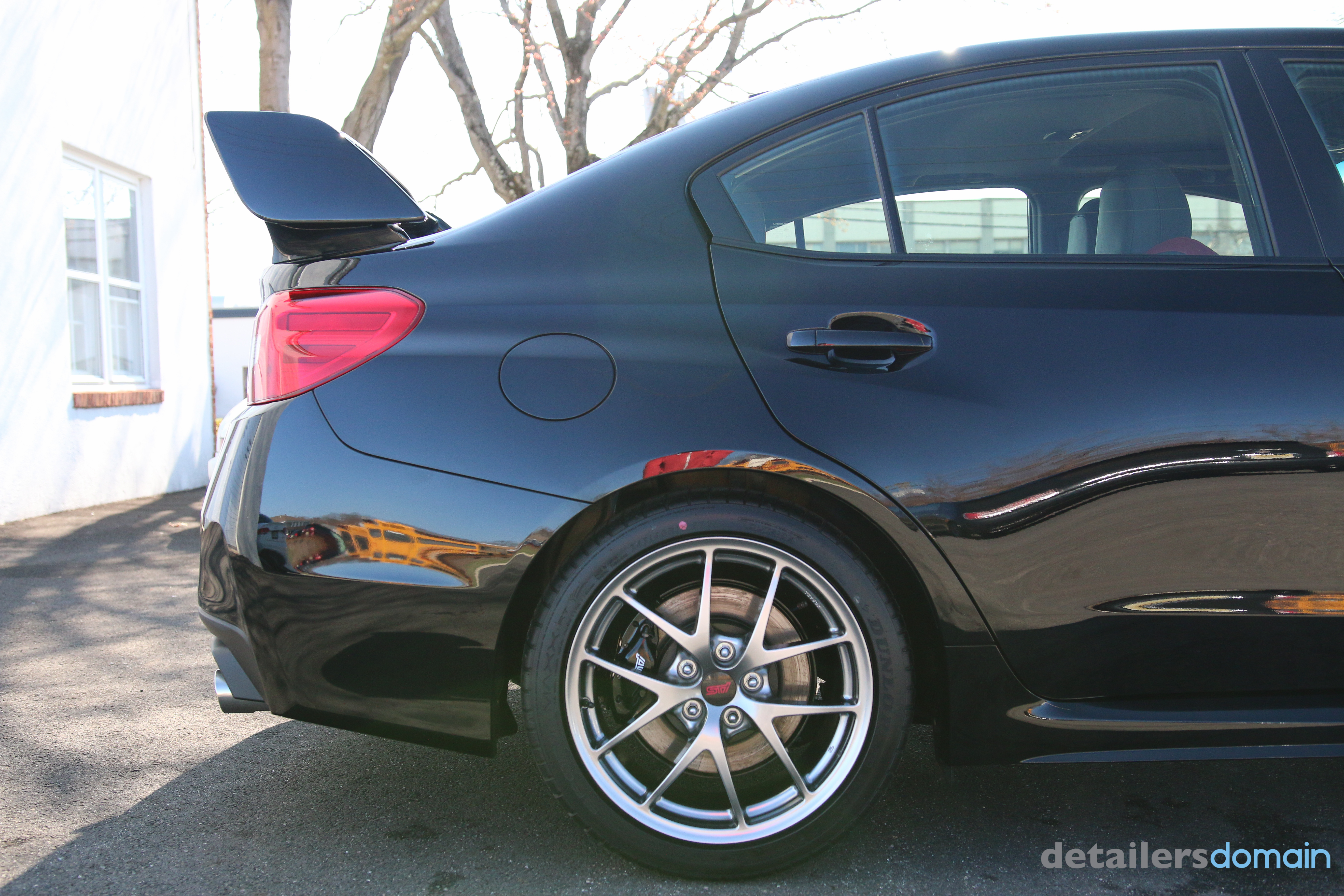

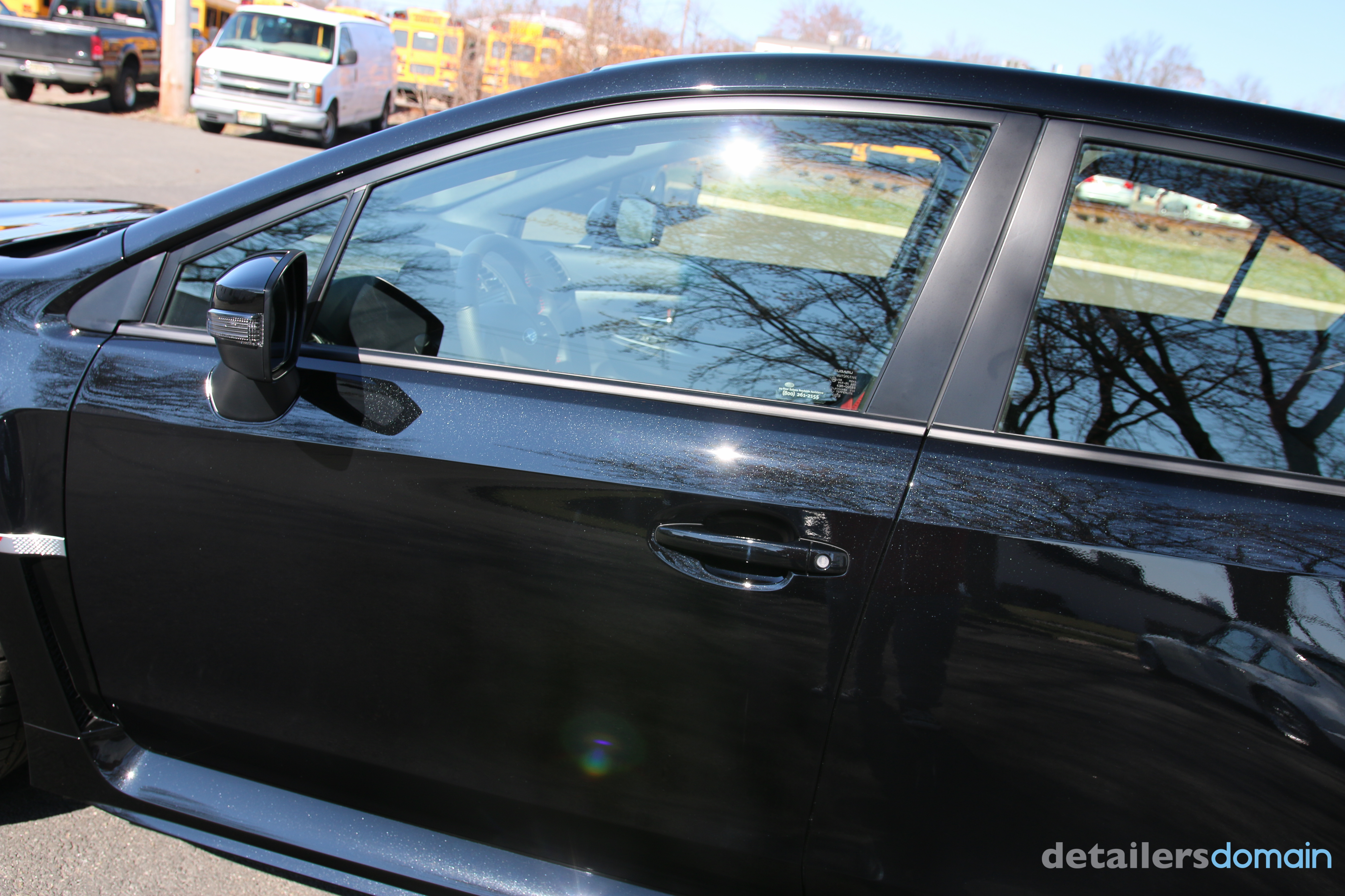

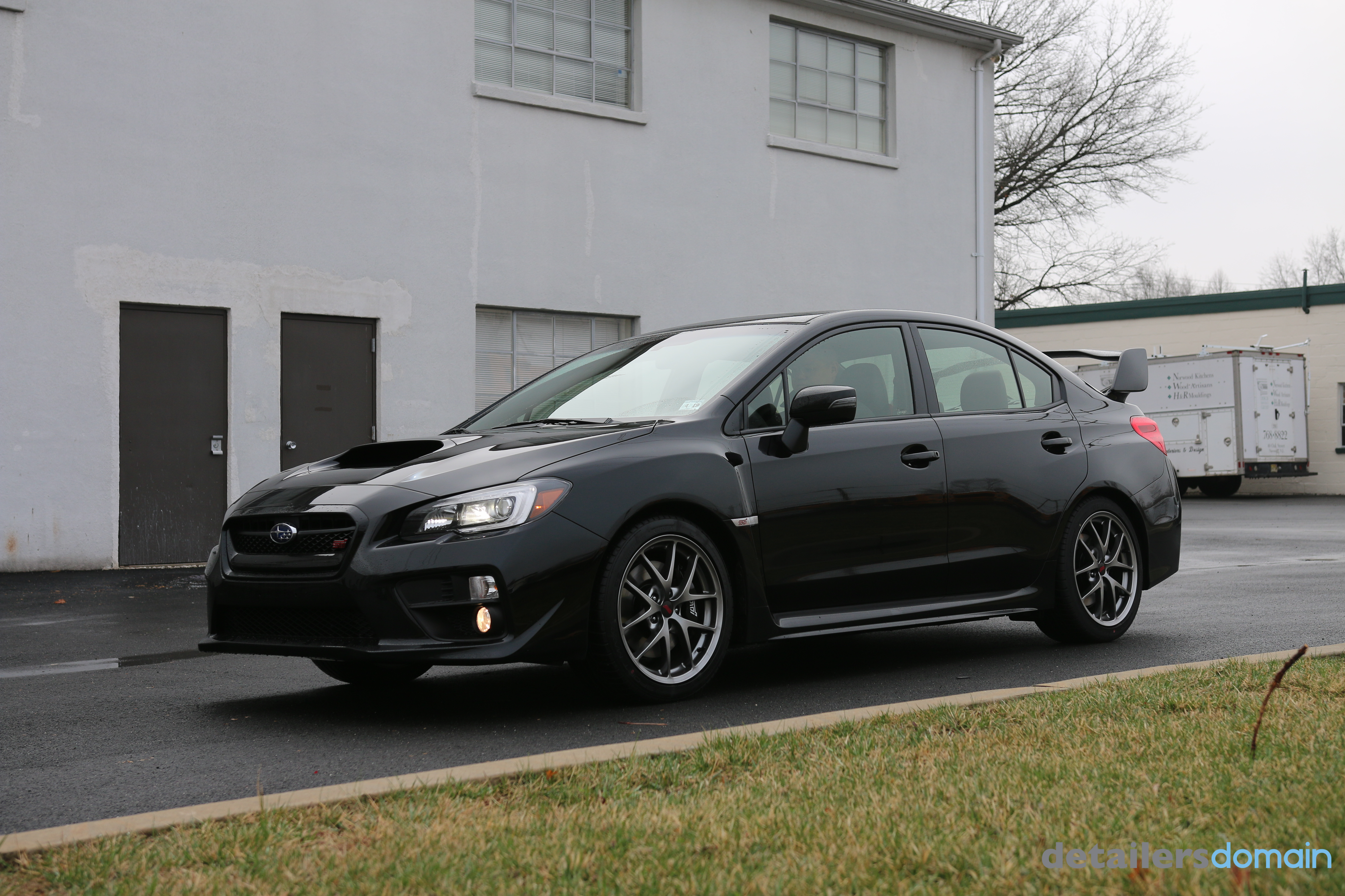

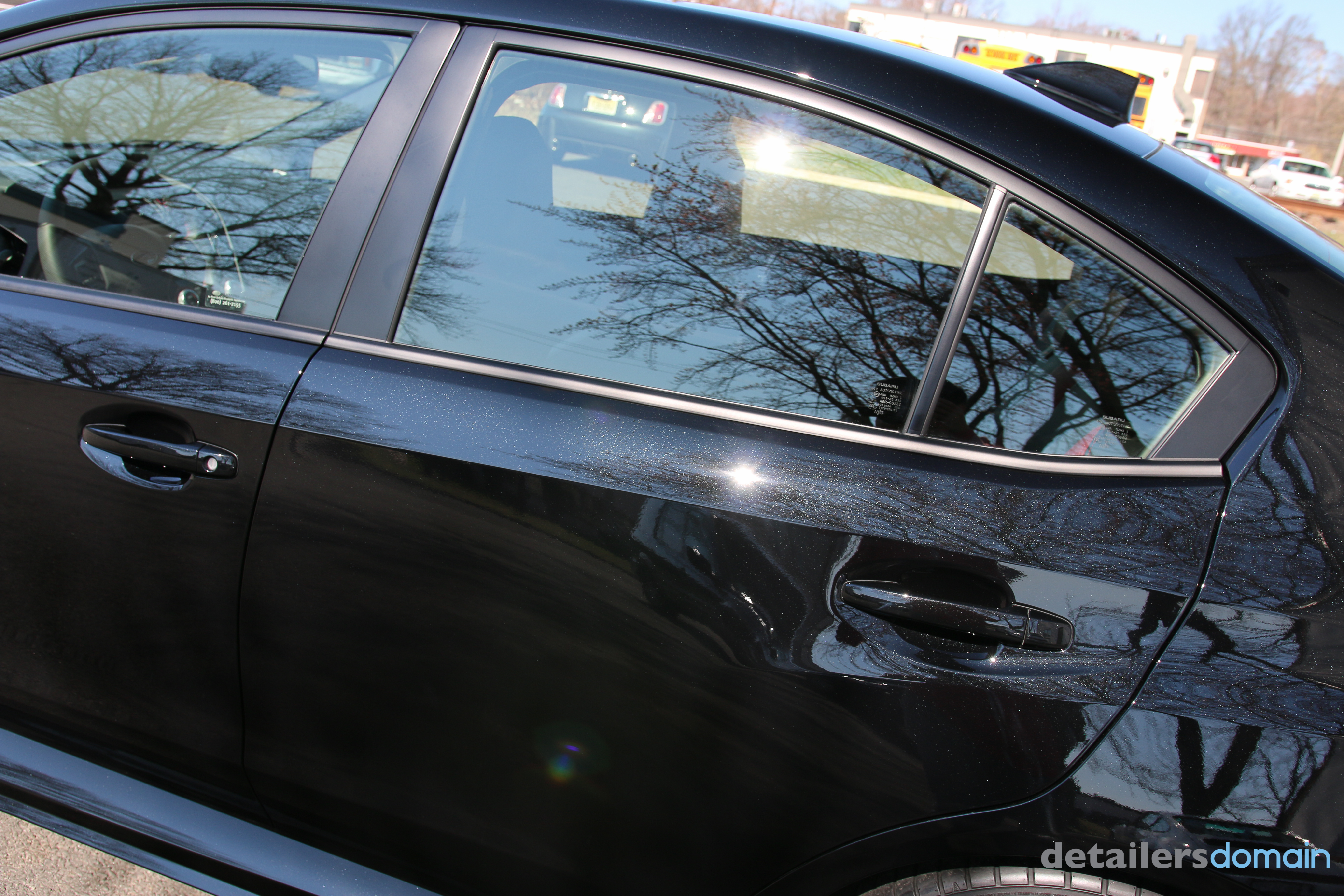

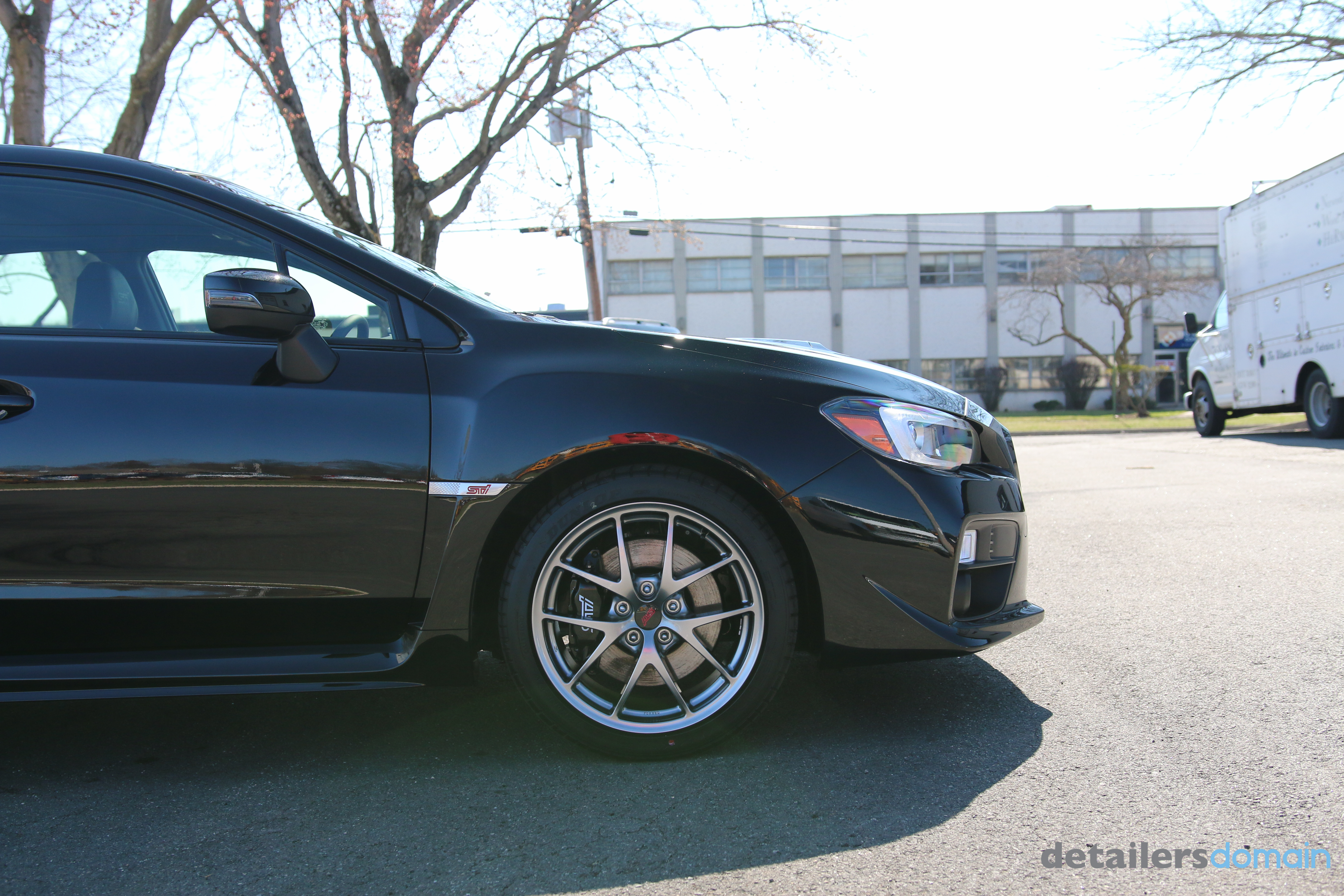

After
