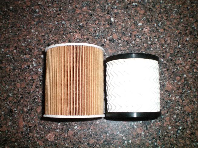

that picture is a GEN2 OE kit .....
hopefully you'll actually get the right one and not what in the picture
GEN1 left, GEN2 right
WAY's current price on the filter is $9
+1
Looks like they are picturing the gen2 filter with a gen1 date info...and MARKING IT UP EXTRA $$.
I would looks elsewhere...pretty good chance when you get it, it might be wrong.
Still, IMO stick with OEM, or a good euro brand like MANN....Quite a few folks have reported they have used NAPA GOLD (apparently made by WIX) without issues.
