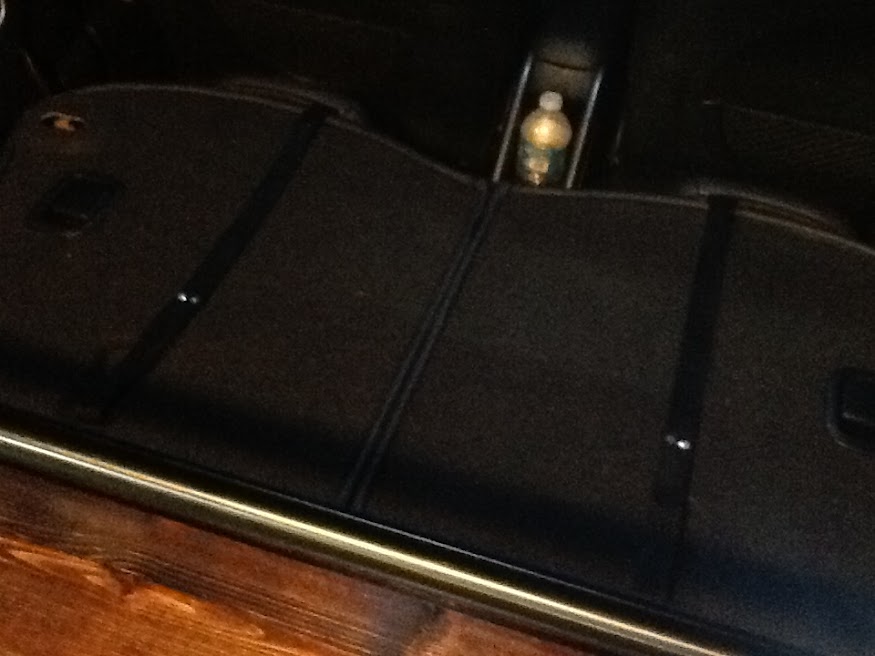

and, in the spirit of DIY and cheapness, i decided, hell, i can make those for way less $$!... so i did!
total cost: about $6, depending on what you have laying around
Tools:
Rivet Gun
Scissors
Lighter, soldering iron, or similar
Materials:
walmart: lashing straps from the boating section: $5
lowes: D-rings : $1
misc: rivets and washers
1. cut straps to a good length, enough to fall to the bottom of the seat, then add some more for a handle. use something Hot to seal the vinyl, to prevent fraying (i used a cauterizing tool, from the hospital, dad works there).
2. Make some holes for the D-Ring. Rivet in place using washers for a backing to prevent the rivets from sliding through the straps.
3. measure where you want your loop / handle to be. repeat step 2 for holes and rivets.
4. Do steps 1-4 again for the 2nd strap!
5. remove headrests on back seats, place the D-ring around the headrest post.
Whalah! you know have pull straps for your rear seats! Enjoy
