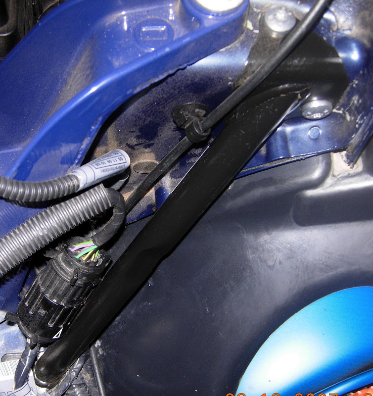

While at MITM I had a new mod installed by my friends at Custom Mini Shop. Very quick and easy to install on all 1st Gen Mini's built after Mini started building convertibles. Funny I don't see much talk of this easy and inexpensive mod. Less then $55 in parts. The mod is adding the Convertible Braces that come standard on all Convertibles.
This ties the strut tower to the engine support beam. On all Mini's built after convertibles were introduced the holes are already in place and tapped. It's a simple matter of removing the plugs and using the bolts available from Mini to install.

I've been curious about this mod for some time. Have you noticed any increased rigity?

Originally Posted by curv872
I've been curious about this mod for some time. Have you noticed and increased rigity?
Not really. Already have Under Strut bars, upper bars and welded in triangulated roll bar. I figured this couldn't hurt, weight is like nothing, less then a pound, cost was low, and I needed a mod, I was modless for weeks.

have you thought about doing the diagonal underbody rear braces from the Cabrio? I think it would be the same.

What are the part numbers?

Those are surprisingly heavy... couldn't believe how much so when I had mine off...
Call Brad @ Custom Mini Shop, they have some sets in stock.
the ones under the car? yeah.....easily 20+ pounds for the set.

The rear braces will run about $300 for all the parts. For my car I don't think it's worth it considering I have a triangulated roll bar.
Here is a picture of them on RealOEM http://www.realoem.com/bmw/showparts...93&hg=51&fg=80
