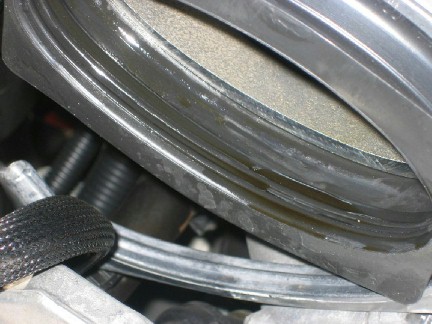

Ok, I'll admit it - I caved. I was there, and the Alta catch can in it's nice red color was there, and Randy Webb was there (he had just put on my Alta 15% pulley) and I caved in and had him do the OCC too. I just didn't want to futz with having to wonder what size tubing, where to put it, how to make a bracket to hold it, etc.
Below is why I decided to do it. I had him take the IC off and this is a shot of the out-take side of the IC....
