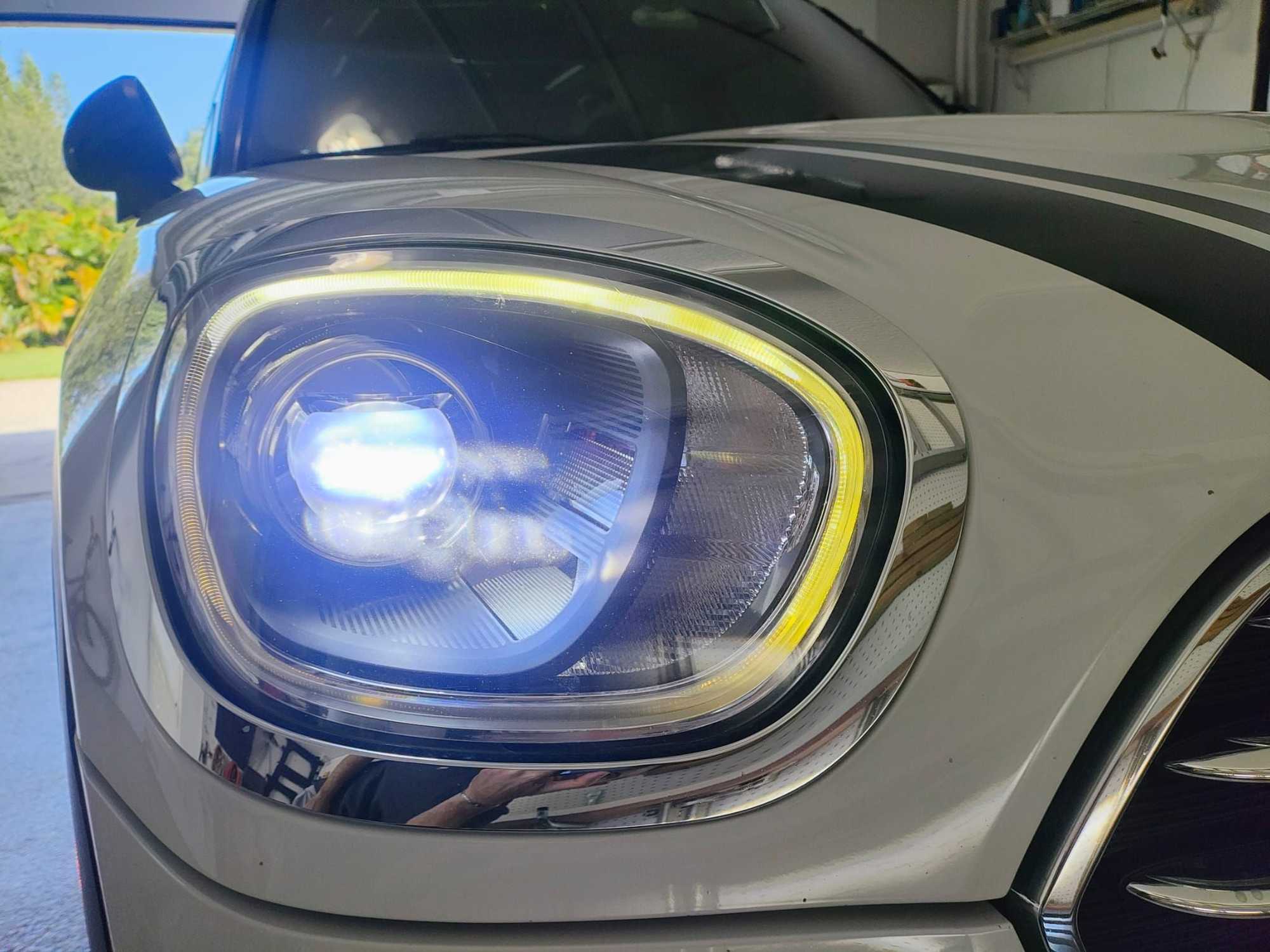

did anyone experience having the LED strip light around the main headlight 50% not working.
Please see attached picture.
Thank you
Valerio
Thank you
Valerio

It should dim a bit when the main projector headlight is on. What does it look like with the headlight off? If it doesn’t match the other side, the LEDs that illuminate the ring are failing, and, unfortunately, the headlight needs to be replaced. The LEDs are not replaceable.

Bet its that led module or maybe the those LEDs
https://www.ecstuning.com/b-ind-part...-f5x-ydrl~idd/ these are for the F54-F57 cars till 2021.
Have not looked at the chips for the F60 ?
We have other LED modules and BMW and MINI like to share. see what that chip looks like and post a picture.
