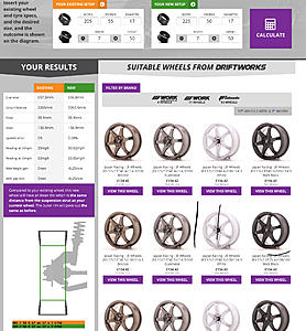

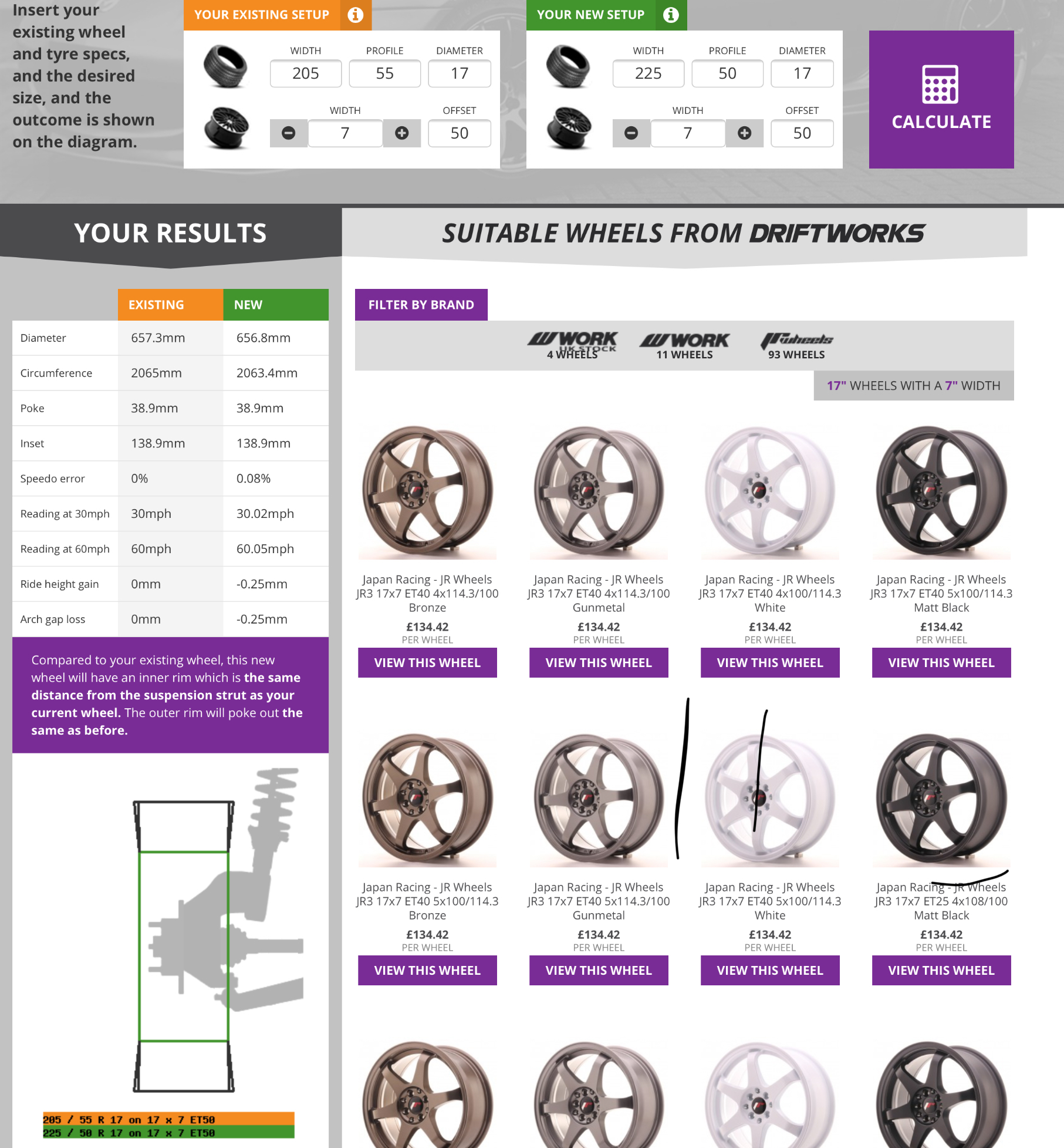

Here is the screen shot comparing the 205/55 to 225/50 on the stock 17”x7” et50 wheels
anyone switch from run-flats to regular tires? was the ride a big improvement?-7da4efdf-f60c-481a-ae06-a149ab8f5b9e.jpeg

Quote: Here is the screen shot comparing the 205/55 to 225/50 on the stock 17”x7” et50 wheels
so,,,what do you do about the bolt pattern?. stock is 5x120
Reply 0
