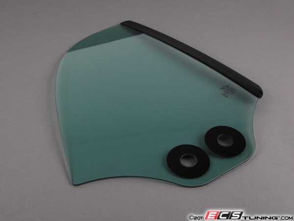

Here is a diagram for the rear window.
Rear right glass. Diagram #1 part number 51377111022
