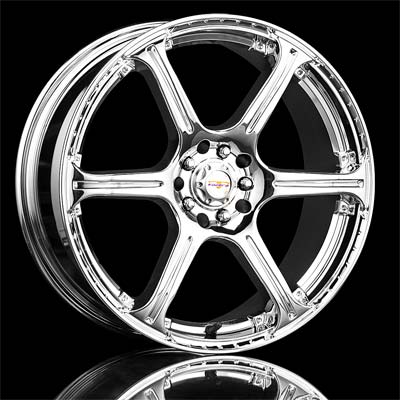

What do you think of these Wheels
I went to tire rack and these Wheels came up as a possibility what do you all think and what is the ride like on 18s

Someone please correct me if wrong, but the wheel in the picture has a 5 lug pattern that wouldn't be compatible with the MINI's 4 lug.
However if they are compatible with the MINI, do you have any more specs on the wheels?
IMO, they are a good looking set of wheels, but it would be nice to know the width and offset because 18'' wheels are more prone to rubbing...
And of course they will most likely offer a slightly harsher ride compared to a smaller wheel with more tire sidewall cushioning, but there are countless threads related to that...

Here is more info on these wheels
Finish Shown: Chrome Plated
Other Available Finishes:
Silver Painted
Size Selected: 18x7.5
Price: $259 (each)
Estimated Availability: In Stock
Recommended Tire Size: 215/35-18
Wheel Offset: +45mm
** Lightweight: 22.9 lbs. **
Additional Specs
Bolt Pattern: 4-100
Finish Warranty: 1 Year
Country of Origin: South Korea
Construction Type: LP Cast/Shot Peened

As long as the bolt pattern is 4-100, they will fit with no problems.

chrome always looks heavy...
