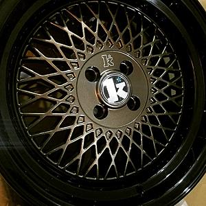

Compared to OEM 16x6.5" et48 wheels the new wheels are 14mm further from the inner suspension and poke out 52mm more.
