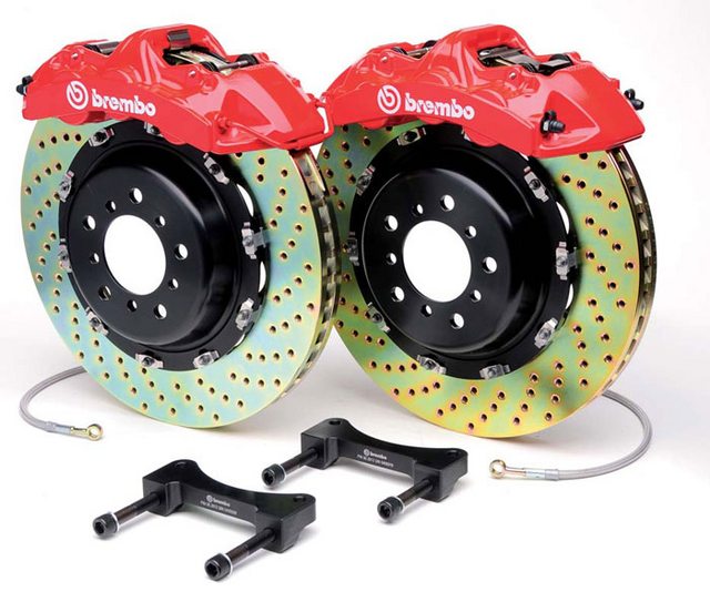

Can you make them look like this? What is the advantage of the pretty plating?
Old Apr 26, 2014 | 11:55 AM
Saltysalt's Avatar
Saltysalt
Posts: 2,257
Likes: 15
From: Dover, NH
its a zinc coating, helps prevent rust
Old Apr 26, 2014 | 12:02 PM
JPMM's Avatar
JPMM
iTrader: (7)
Joined: Aug 2006
Posts: 2,796
Likes: 11
From: East IA
I thought zinc had a silver color?
