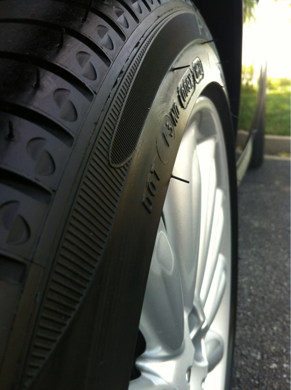

Lets see how this works from my iPhone.
I recent went ahead and purchased Michelin Primacy HP in the 215/45 size. These were takeoff tires from my friends Subaru BRZ. Some of my coworkers call this the "Prius" tire. I'm told Toyota didn't want too much grip in their new underpowered FR sports car. Anyhow.
Tires look great, all the good things you hear about the ride quality over the run-flats without the squish soft feel. They have a nice sidewalk profile, with a bead saver like profile near the bead.
I still haven't figured out if the added tire height is causing false vehicle speed. But I've discovered on this site like many of you that Mini has a speedometer correction factor. Using GPS app I'm still showing that my car is 2mph slower than what the speedometer is displaying. I've tired a few different apps, either it's my phone or the car. With taller tires I thought it may have gone the other way.
