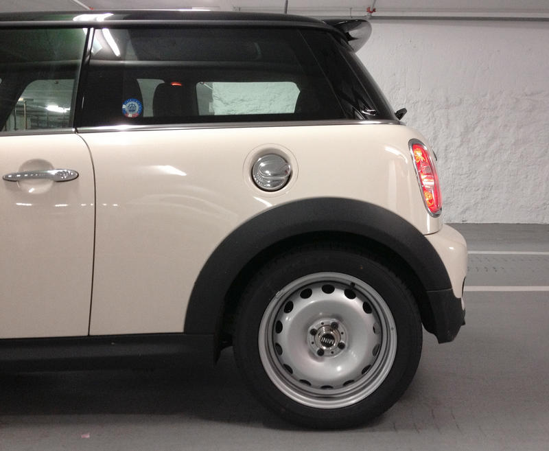

Also, I've uploaded some quick iphone snaps of how these 16" steel wheels look on a Cooper S. You can also see how close the brake caliper is to the wheel.

I noticed that the Mini OEM steelies appear quite bulbous to accommodate the the brake calipers.. does that mean steelies from jegs.com would not fit?

I have 16x6" steelies (from an Opel) with my R53 JCW brakes and they fit fine. Any 16" should fit with stock R53 brakes, most 15" too. My tire size is 205/50-16. I guess you can go taller if the car is not not lowered. And 215 wide fitment depends on the ET of the wheel of course.

Where can I find those exact wheels in the photos?
I like those rims a lot more than any I’ve been able to locate. Could you possibly provide a link to where I could find those?

Hello Josh, Just saw this.These ones? 36116764346
https://www.ecstuning.com/Search/Sit...h/36116764346/
