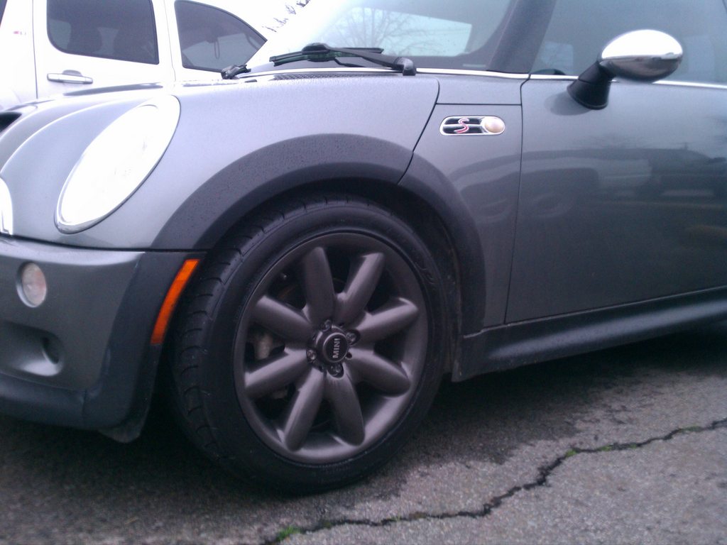

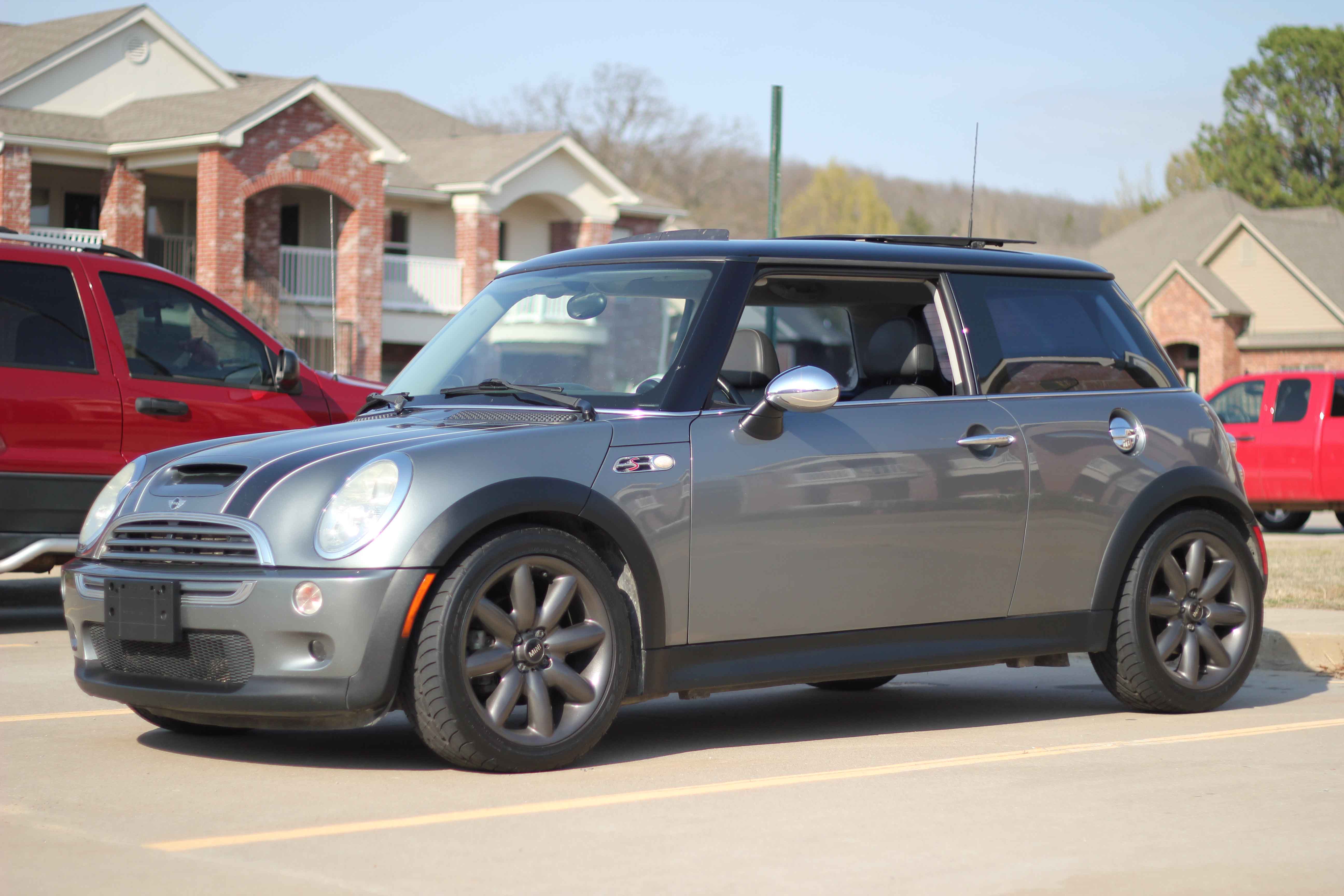

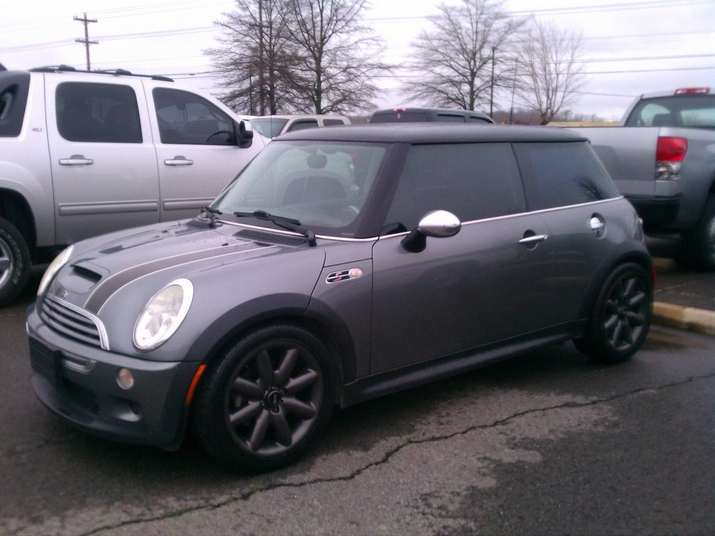

Quick cellphone pics of the rims back on the mini, I'll upload 'professional' pictures tomorrow:
Overall, took me six-seven hours, mainly because I could only do two wheels at a time. Not enough jack stands :P

Added a few crappy cell phone pictures. Will upload some professionalesque photos tomorrow
