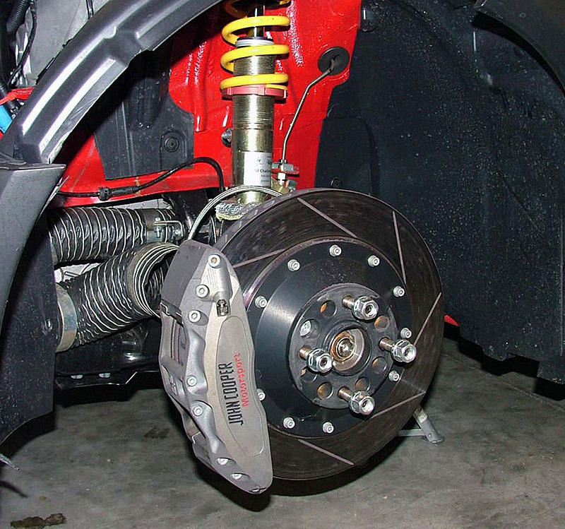

Here are the MINI Motorsport German MINI Challenge series spec brake air ducts, notice the 2 silicone tubes.
Attached Thumbnails What is the best wheel/tire size for STX Autocross-55_1600.jpg
