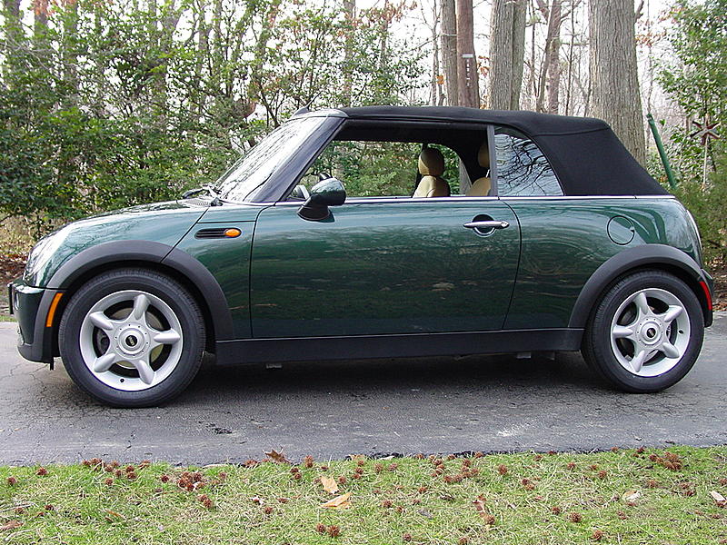

No problems with 205/55/16's on my MCC
I'm running the 205/55/16 Michelin Pilot HX MXM-4 and really like that size and tire combination. They are stiffer and better handling than the 15" Conti's I use in winter and smoother riding than the OEM 195/55/16 Goodyear runflats. Also the plus size helps fill out the wheelwell while still looking low profile for a look I like. No clearance or other issue with the added 4/10" in height. I have stock wheels so don't know about that part. The thumbnails show my MCC with the 205's on. Good luck.
Attached Thumbnails 16 x 7 x 35mm w/ 205/55/16-dsc00466.jpg   16 x 7 x 35mm w/ 205/55/16-dsc00473.jpg   16 x 7 x 35mm w/ 205/55/16-dsc00464.jpg

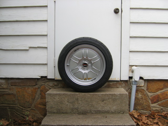

I just sent you a PM. Would you mind sending and/or posting pictures of your wheel/tire combo? They don't have to be installed on the car. I am mostly interested in seeing what the sidewall looks like in the 50 size. I am leaning towards the same exact tires as well !!
Come on warm weather!!! Can try and post pics with wheels standing next to car tomorrow or next day. Pretty crappy weather today.
Attached Thumbnails 16 x 7 x 35mm w/ 205/55/16-img_1471.jpg   16 x 7 x 35mm w/ 205/55/16-img_1472.jpg

Where did you get your center caps from? Enkei caps are on the expensive side.
As far as 205/50-16 tires go, I purchased a set of Hankook R-S2s during Discount Tire's big sale. I also have this tire on my Monster Miata, and love them.
I bought them with the wheel / tire combo from Tire Rack. They were kind of expensive. Maybe I should have looked around, but I have them now and I like them.
