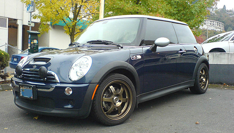

Pictures as promised, the tires are 205-45-16's Yokohama avs es100's. I plan to later move to a 215-50 size. The care feel soo much lighter!

Extremely nice wheels - I can see what SandToast meant about the Volks being very "caliper friendly"!
