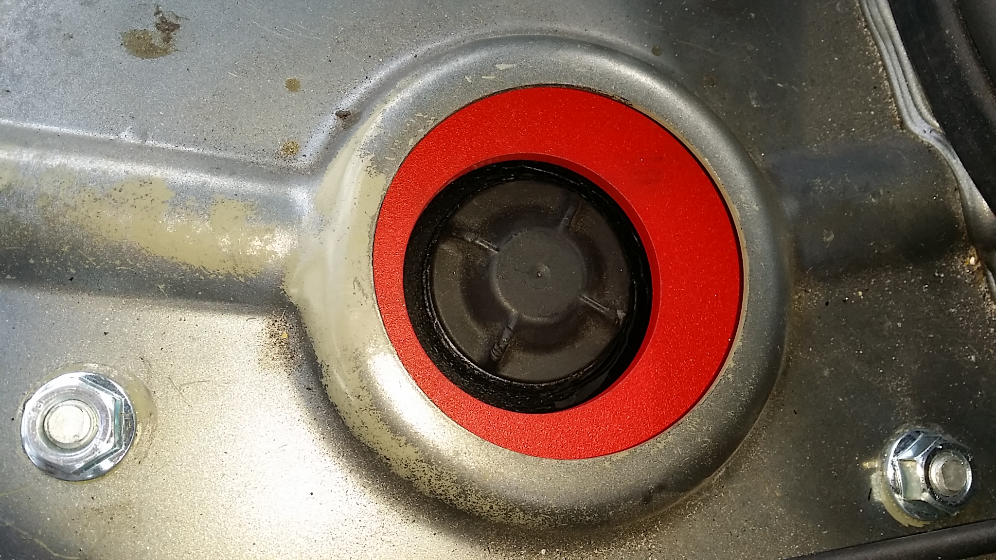

03 MCS .The front mounts where both broken and the right one looked the worst . It was protruding quit a bit further than the left one was
I installed new KYB mounts along with the Madness mini strut tower reinforcement plates .
Everything went together just fine ,however after a few days of driving I can see that the right stut is again quite a bit higher thru the mount than the left side. It looked fine when I installed it!!!
It looks like it broke again although the reinforcement plates make it a bit hard to see .

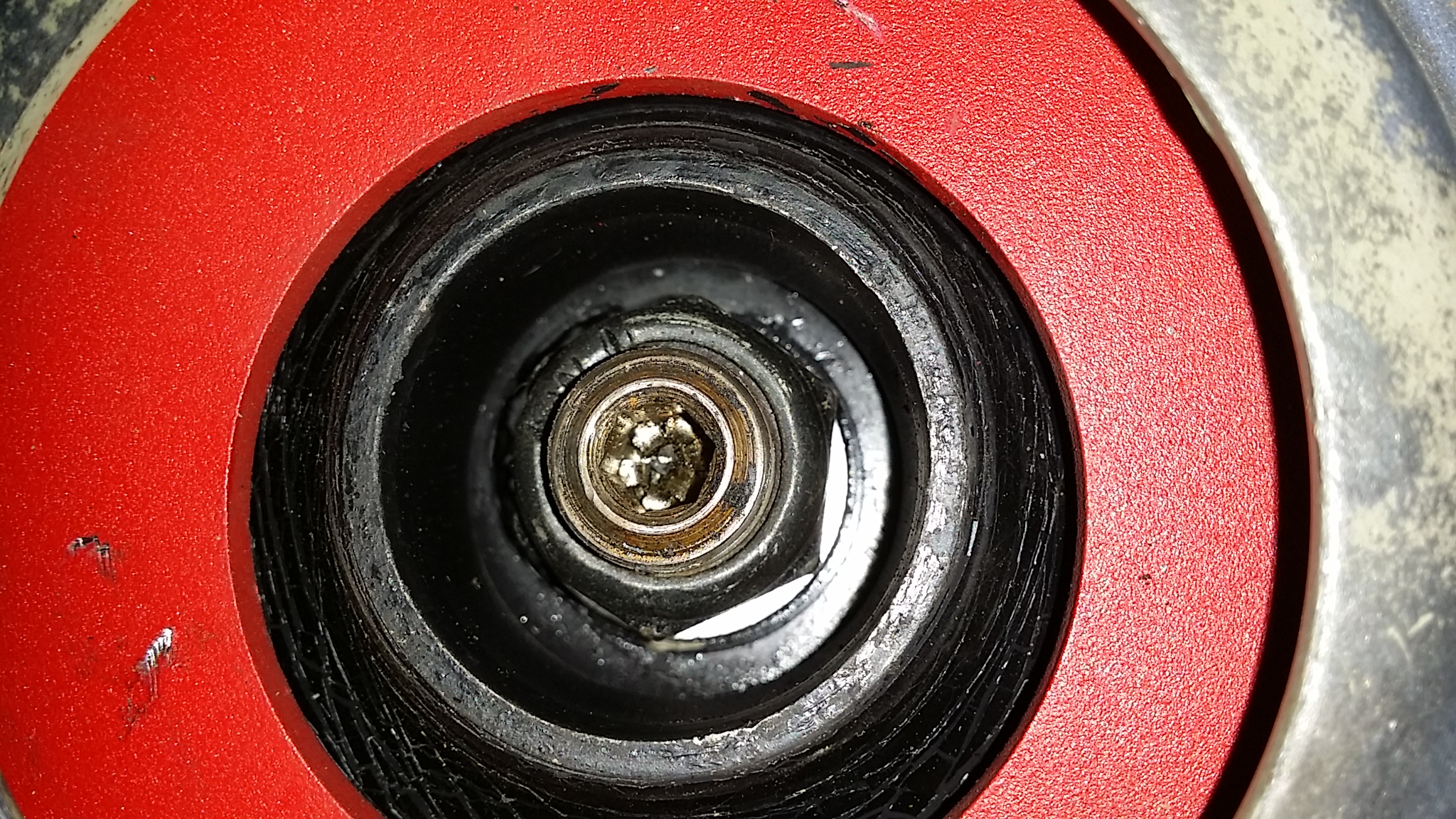

View into top of strut mounts . What happen to the bearing on the right mount? Obviously failed the big question is why . Just a defective mount ?

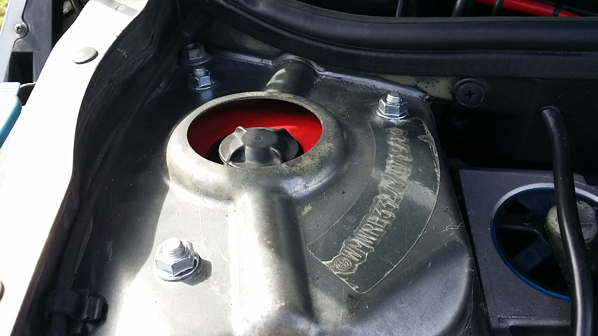

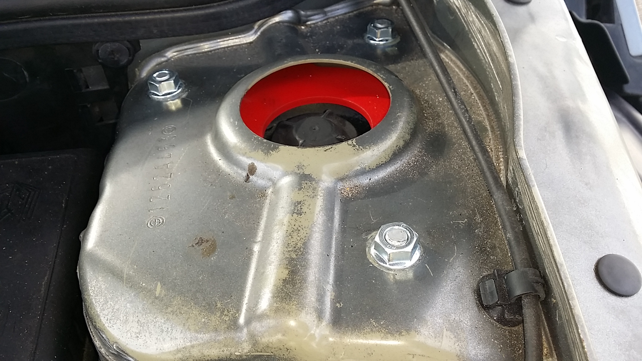

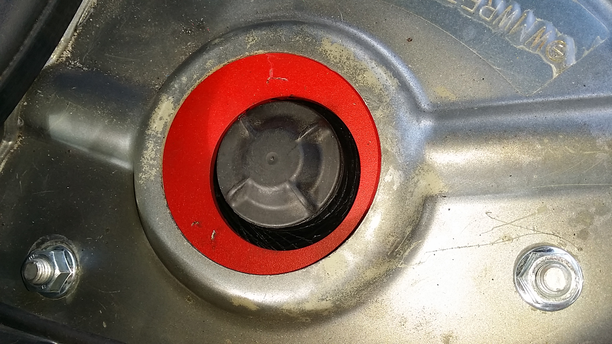

So I just replaced the right strut mount that appeared bad and upon inspection looked ok even though it was about 3/8 of an inch higher than the other side . I also have the madness reinforcement plates installed
I also changed the swaybar end links and made sure the strut top hat wasnt deformed and the spring is oriented correctly .
when the car was still off the ground both sides where even . After driving a short distance the right side looks to be about 1/8 of an inch higher than the left .
The car drives straight with no issues .There are no other suspension problems that I can see as the previous owner had just about everything replaced
Am I worrying about a non issue ? Is this normal ?
By the way it turns out one mount had open bearings and one is sealed thats why they looked different inside . I called KYB and they said some are sealed and some are open and thats the way the stock ones are also
