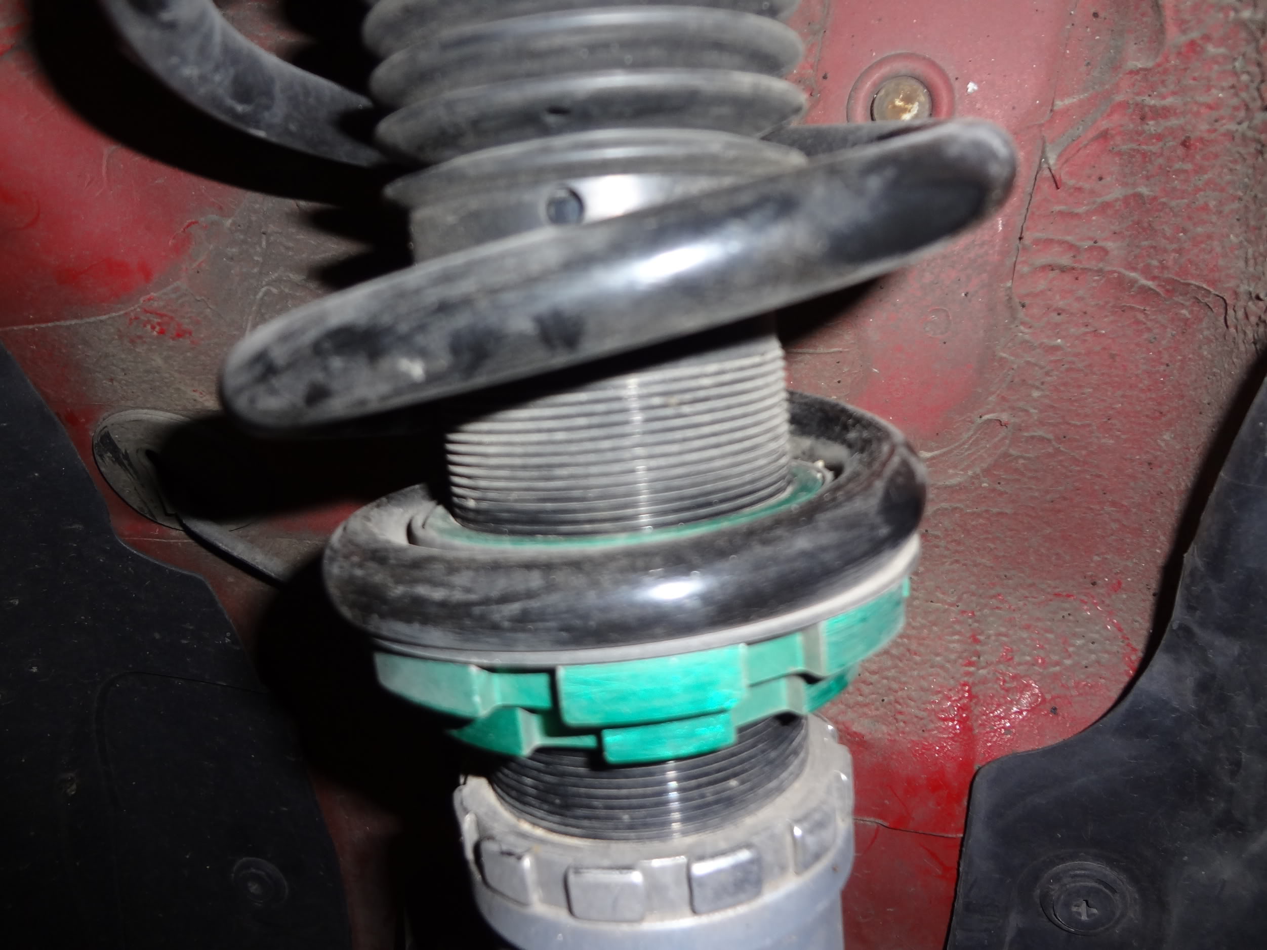

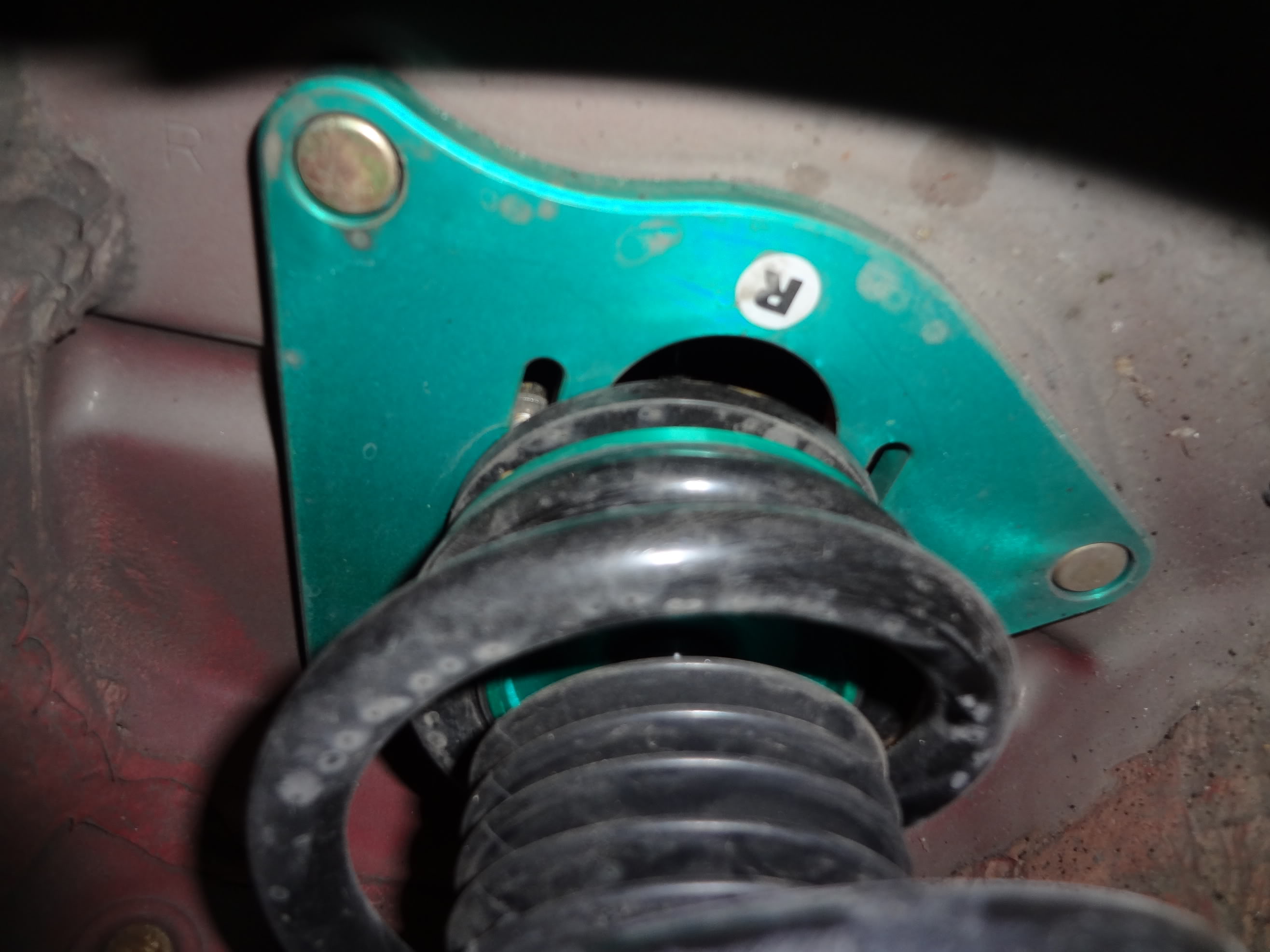

Old Jun 17, 2011 | 05:38 PM
Act_04's Avatar
Act_04
Joined: Dec 2008
Posts: 525

I'm not seeing an issue, but I took some pictures. Maybe a keen eye out there can notice something I can't.
I wish I had a lift so I could put it up, take off the rim, and turn the wheel left and right to inspect in full view.
Old Jun 18, 2011 | 04:21 AM
N2MINI's Avatar
N2MINI
Joined: Feb 2007
Posts: 1,521
Likes: 17

In short spray the heck out of the perches top and bottom with some WD-40 for a quick fix test. The WD-40 won't last but so long, but you'll know if that fixes what you hear.
Tighten that top bolt they mention as well and you should be good to go..
Worked for me...

not sure if anyone mentioned it, but did you check the preload? If you overtighten preload, you will get some creaky sounds when turning.
Old Aug 28, 2011 | 02:15 PM
meb58's Avatar
meb58
Posts: 33
Make sure that the springs are snug between the upper and lower perch while the suspension is at full droop.
The Megan perch is a pillow ball, right? If so there shouldn't be any binding whatsoever; the spring and damper spin in unison.
Also, make sure that the four allen screws/nuts are properly torqued...if you are okay with the camber setting use red locktite.
Do you have stock swaybar endlinks? Make sure these are in good shape. If either ball joint end on the endlink is worn you will hear odd noises...clicking/light clunking.
Make sure the ball joints are in good shape as well as the LCA bushings
Make sure the the pinch bolt in the knuckle is torqued properly as well.
