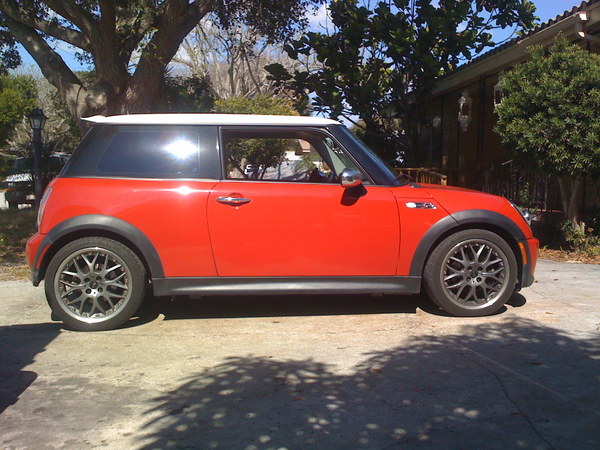

Here are my before and after pictures going from stock to H-Sport Springs and H-Sport rear control arms.

perfect man. exactly the picture i was looking for? so did the springs settle in at all when this pic was takin? and also, are the control arms really necessary... is the neg camber that bad? thanks for the pic and info.

Both pictures were taken the same exact day. I bought the springs used, so I don't know if that is why the drop was so dramatic right away. I haven't noticed any additional drop since then. I also installed the control arms and new tires the same day so I don't know how bad the rear tires would have worn without them. I read that I would need them, and didn't want to take a chance since I was spending money on brand new tires.

your definitely gunna want some control arms. just as an example, i lowered mine on m7 coilovers, the rears look close to ponderas, and my camber was a -2.8 i believe before straighten in out with the control arms. my fronts droped a good bit and its only at -1. keep in mind though stock rear camber is like -1.53. so it increased just over a degree. while that might not seem like much, look at the additional wear you already have on the inside of the tires from the stock neg camber.

Agreed, you'll definetly want some rear Hsport camber links otherwise you'll be eating through those rear tires.
