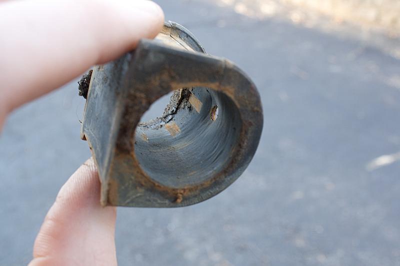

I "trimmed" the bushings two weeks ago and the rattle is gone (as expected). Thanks for the suggestion!
In case anybody is curious what the wear looks like, I took a few pics. The rear sway bar and bushings were originally installed on my first R53, so a rough estimate would be that they had 40-50k New England driving miles and a few track days and an autocross or two between two MINIs. The bushings had grease grooves which over time have been completely worn down as you can see from the pics, so I'll probably have to grease these more to prevent squeaking.
