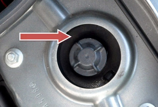

If I'm only looking to stop the cracking/bending the strut mount. Has anyone had that problem after installing the IE fixed plates? I know they are built on a similar stock design. I just want to not replace a mount every 3 months. but budget doesn't allow for anything other then stock or something like the IE fixed (sub $250)
Thoughts, opinions, feelings.......

Sorry - i will show you what it is that keeps cracking/bending
And I had added the MiniMadness Plates. Those are not bending! They are VERY strong. Its the part that the arrow is pointing to that is my failure point. So if the IE fixed plates don't have that as a weak point - then i'm sold!
Thank you
Thank you
