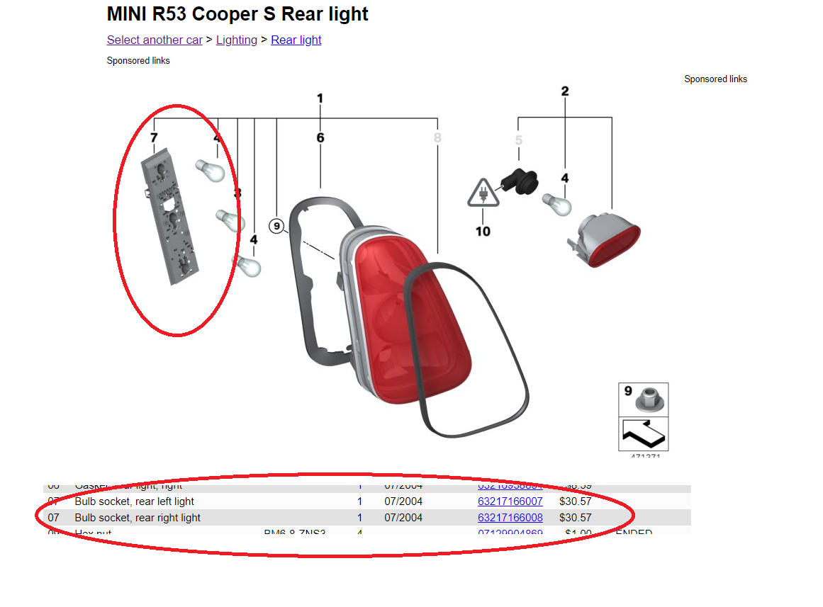

the backplane that holds all 3 bulbs should be available for $30

Thanks all; for inspiration (the DIY idea has merit, and I should have already called my salvage yard or at least checked inventory online); for the tech info (rear light diagram - i had no idea how that hard-to-reach spot was put together); and also the 411 on the plastic (I kind of suspected, and I agree about the climate effects).
I'd like to know the source of the diagram, so I can explore it a little deeper (my headlamps actually have issues of their own, for another time).

https://www.realoem.com/

The 'trick' is to take the entire unit out. Take off the 10mm nut on the stud & there are 2 spring clips on the outside edge - #9 on the pic above. A wooden ruler may help to press them.
Then you have un-obstructed access - more important you can clean & wax the area around the opening to prevent rust. A little grease on the clips will help re-assembly.
