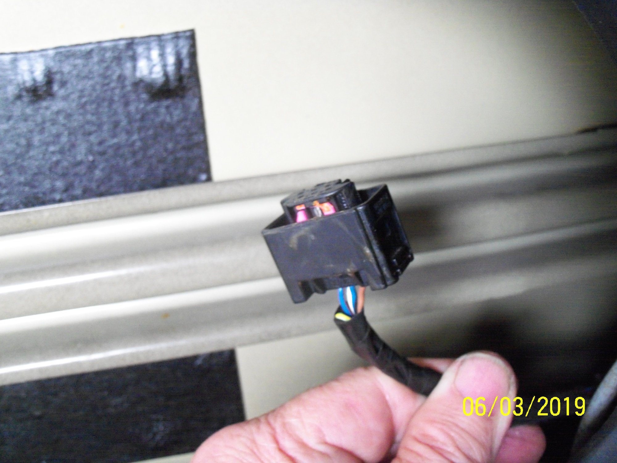

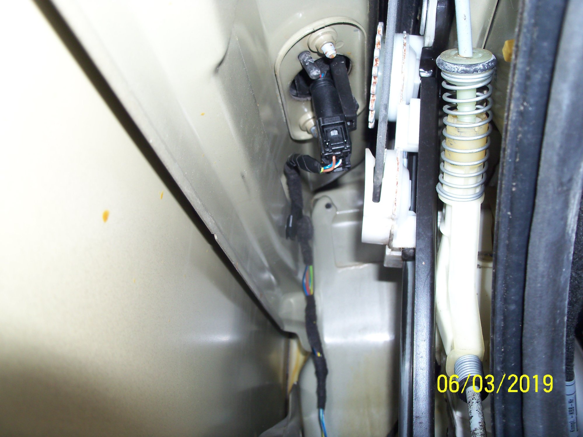

OPERATION HEATED DOOR MIRROR DISABLE IS A COMPLETE SUCCESS!!
I tried to remove the glass from the mirror, it was not coming off.....things were creaking and cracking, but the mirror was still attached....not gonna mess with it anymore
So I pulled the door cards, reached up and pulled the electrical connector from the bottom of the mirror, released the plastic latches to separate the connector into the two pieces, slide the wire catch slide out, remove the heated power wire inside the connector, it's green with a yellow stripe, put the electrical connector back together, taped up the power mirror wire to the harness, install connector back onto mirror, re-install door card. Repeat for other door.
Heated power mirrors are now totally disabled for as long as I own the car. If I decide to sell the car, I will give the next owner the option of having me put the one wire back into the connector, or leave it as is. I will also do this to my '04 R53 as well
Bryan (quick pictures below)

You can access the same connector by removing the mirrors, a bit less work.
