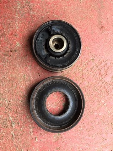

Before you go any further with this, you need to see if the harmonic balancer on the front of the crank is good. The two pieces attach with vucanized rubber core, which always goes bad.
you will not get a resolution to these codes until this is fixed (if it is bad)

Took my JCW to Helix in Philly.. they had the car for 2 weeks, found a misaligned pulley (looks like I didn't get the harmonic balancer seated completely when I changed it)and changed the drive belt, also replaced the cam sensor.. I just replaced this a week ago but then said it was a defective unit and replaced it again.. $500 and 2 weeks later they said the car was running great.. took it home and she did run good.. for 3 days.. then on my way to work, hit 5500RPM in 4th gear and sent the car into limp mode and dash lights came on.. finally got to work and check the codes... same P1688 and P0107 as before I took it into shop..
