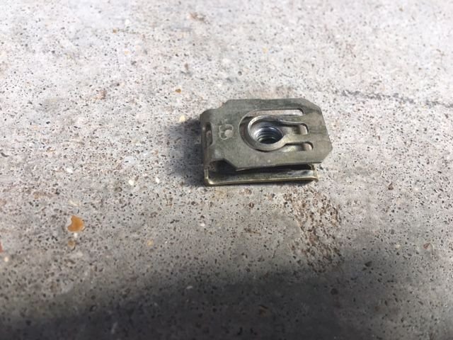

@ECSTuning ...Got my parts in and replaced the lower spoiler without too much difficulty! Thank you for the help. I did find the "Body Nuts 64500630991 to be the wrong ones I was looking for although they were required/needed to attach the two ends of the spoiler to the left and right side trim made of the same material as the spoiler. I now have an ample supply of these (bought 10). The nuts I was looking for were actually like this one...I have one and need two more. They attach the spoiler to the Core Support Front Panel...which sadly I'm going to have to replace in the future as well since the left and right contact points are damaged...although I may be able to repair it if I plastic weld an insert.
Here is the picture of the nut I need...
Old 05-08-2017, 06:48 AM
ECSTuning is online now
Join Date: Jan 2013
Location: Wadsworth, Ohio
Posts: 34,787
Received 1,965 Likes on 1,765 Posts
Welcome.
Yep sorry this is the core support bottom one. The other one is needed also when i did mine.
07131496622
https://www.ecstuning.com/b-genuine-mini-parts/body-nut-priced-each/07131496622/
