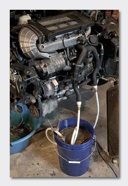

Took the radiator off yesterday to try and clean it. I plugged the ends, brought it inside and stood it up next to my wood stove for an hour to warm it up hoping that the heat would help to loosen up the funk within.
When I brought it back outside, I poured boiling water into the top port, where it just sat, never working through to the bottom.
Im guessing the radiator is toast. This is what concerns me; that when I button everything back up, there are other components, such as the heater core, or the new oil cooler I'll be installing, that are, or will get, just as blocked up.
I plan on several cycles of flushing the system with a water/detergent mixture once the engine is re-started. I'm hoping the pressure and heat of the system will "power through" what's left elsewhere.
At at this point, I'm contemplating changing out or scrubbing clean by hand, as many contaminated components as I can get to, i.e., hoses, coolant expansion tank, just to remove more of the gunk manually.

It might be worth your time to connect the top hose and see if you can get a water hose clamped to it so you can actually get some water pressure pushed through the radiator.
Old 03-22-2017, 04:35 AM
MVPeters's Avatar
MVPeters
MVPeters is offline
Join Date: Dec 2013
Location: Northern MA, USA
Posts: 775
Received 145 Likes on 122 Posts
You can get a very cheap - $10 or less - Radiator Flush kit from any parts store.
It's a T-piece for one of the heater hoses; connect a garden hose & back-flush the whole system for as long as you like.

I took a plastic fitting for filling water balloons, screwed it onto the end of the hose, and just duct-taped the living crap out of it so it would seal onto the upper radiator opening. Ran it through the top hose for 5 minutes, then in the bottom hose for 5 minutes, then back in the top hose.
The trick is just getting a good seal, but with a little ingenuity you'll have it cleaned out fine!

Funny that you posted as I was flushing the radiator outside.
I picked up a brass garden hose adapter threaded into a PVC fitting that was perfect for the I.D. of the radiator hose (1-1/4"), connected it, and turned on the water. Took about 15-seconds for the water to fight it's way through, but it did.
I'm hoping that over time, the heat of the coolant will loosen what's stuck to the walls of the hose, and I presume, the interior of the engine.

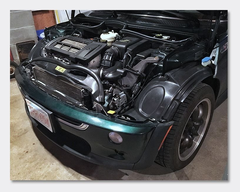

After I identified a failure in the oil cooler following pressure testing the unit (posts above), and while awaiting a replacement, I decided then and there to simultaneously tackle a few other projects I was going to do once spring arrived. Since the oil cooler was off the housing, and since the filter cap was also off the housing (as I drained the oil), it would be the perfect time to remove the now conveniently downsized housing and change out the housing to block gasket which had been leaking for a while. It was a bit of a project, it being my first time removing it - but once I removed the three 13mm bolts, two from the top, one from the bottom, it came out like a puzzle with some twisting and turning through the passenger side wheel well.
I then moved onto the timing cover and related components, first removing the serpentine belt, the original pre-facelift style crank pulley, idler pulley, belt tensioner, then the timing cover itself.
After cleaning the cover, I replaced the timing cover gasket, a leaky crankshaft seal, the two internal oil seals, and also replaced the centrally located M6x30 bolt (07131485184, the one with the o-ring seal in the head). I then installed a new serpentine belt, a new post-facelift style crank pulley (new old stock OEM purchased for $60), a new idler pulley, and new belt tensioner.
I learned from trying to remove the oil filter housing, that a magnetic 13mm socket would be an ideal implement to have available. I didn't have one, so removal was more of a pain than it should have been. I the picked one up, as I wasn't going to attempt re-installation without it. Once I had it, I installed the housing with new gasket in a fraction of the time that it took to remove it.
After I connected the new oil cooler to the housing, but before connecting the coolant hoses, I installed a plastic nipple between the two water hoses to bypass the cooler, as next on the list was connecting a submersible water pump (the MINI dialysis machine) in a bucket pumping fresh water (with a small amount of detergent) to a radiator hose, and circulating clean water through as much of the system that I could reach before returning, via the other radiator hose, to the bucket. I certainly did not want to plug up the new cooler with the mess in the lines, thus the bypass. The muck floated to thew top of the bucket, and only took three buckets to get the loose stuff out.
At the conclusion of the step above, I began the ritual of reassembling the car to the point of the radiator/ac condenser assembly mounted, connected and operational. I then began what would be two days of very short-lived (5-minutes long) fresh water flushes, running the car until the thermostat opened (releasing more filth from within the head)...

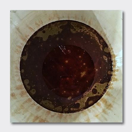

...then turning it off as soon as the water temp reached 204°F as not to get to boiling. I then took the lower radiator hose off, opened up the bleeder screw, then expansion tank cap, and drained the filth out before reconnecting for the next flush. With a cold engine, it ran for about 5-6 minutes before getting into the 'danger zone,' but with subsequent flushes, the engine was still warm, so I had even less time. Flush after flush, allowing about 45-min. of cooling-down time in-between, continued for a couple days/nights until the water finally came out clear, with no sign of oil.
Once I reached the clear-water point, and after the last drain, I proceeded to introduce actual coolant to the system, ran the car for about 15-minutes, then took the car on a 20-minute drive. When I returned, I waited about a half-hour for the engine to cool down, then I opened the expansion tank, expecting to see muck-free coolant, only to be shocked by a tank full of the same brown stuff!
I immediately thought that now, after all this work, I had a head gasket failure...
The next morning, I called a local, well-respected foreign car mechanic, and gave him the synopsis of what I had just gone through from start to finish. While admitting that yes, it could indeed be the head gasket, he said that while the short-lived flushes did help, what would 'really' dislodge the gunk within would be sustained driving of the car, with the heat on, coolant at a sustained 200°F +/-, and that the muck now in the expansion tank was likely to have floated to the very top of the system (the expansion tank) after the first sustained run/drive. He suggested removing the expansion tank, including the contents inside (unbolted, removed hoses, put finger in bottom nipple of tank), dumping it, cleaning it, then re-installing and filling halfway with fresh coolant, then driving again repeating the process until hopefully, all the old muck had been cycled through, floating to the expansion tank and discarded until eliminated.
Well that process (3-times) seems to have done the trick, and I'm happy to report that (knock on wood) I have clear coolant and all is well with the MINI again.

Originally Posted by Zsm
While it doesn't appear to be a common failure, it sure does make a mess of things. I saw this earlier when searching for things to watch out for on our then newly acquired R53.
https://www.northamericanmotoring.co...acks-this.html
That thread was the inspiration for the "MINI dialysis" setup I used. From the photos in that post it looks like the pump be used had the pressure of a fire hydrant!
I was much more conservative, using a 1/4 horsepower submersible sump pump.
