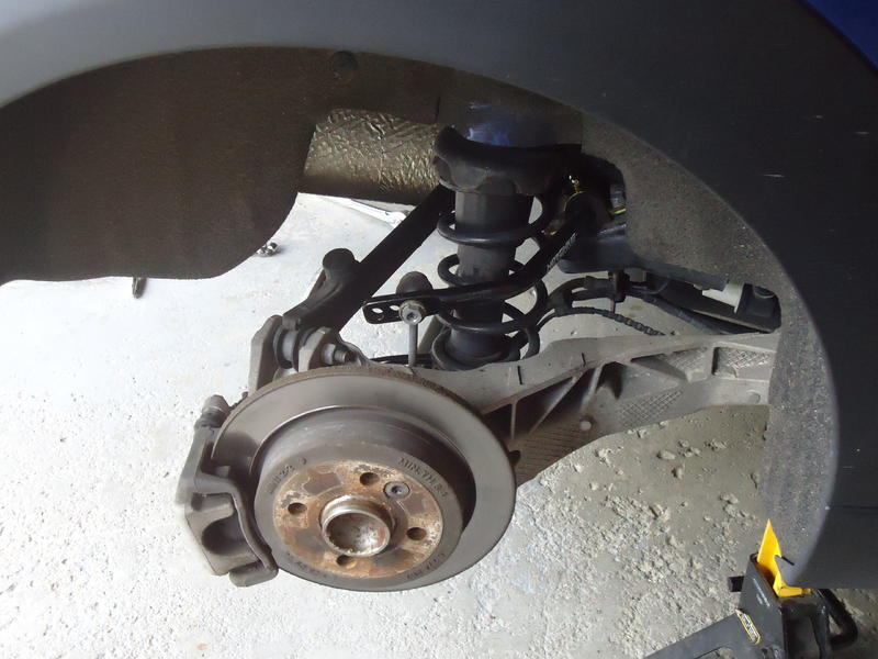

Hi all,
I've been running my 2008 Cooper S in D-stock this year. About 6 weeks ago, I installed a H-Sport rear bar as the rules allow in stock class. The bar was set to the tightest setting.
At subsequent events I have noticed that I am more inclined to spin out. It seems to happen at the slightest of inputs. Yesterday for instance I noticed that shifting into second caused a slight wiggle in the rear. Initially I made the assumption that it was all due to tire pressure but I have yet to find the ideal pressure for my tires (Michelin Sport Pilots (215/45/17) so that the car does not feel very loose in the back during autocross. Tires have about a year and a half worth of driving on them so I don't think they are the culprit. Suspension other than the rear sway is stock.
I, maybe wrongly made the assumption that the middle of the three settings was closest to stock? Perhaps I need to change my driving habits slightly to compensate for the bar. Just curious to hear some opinions and thoughts.
Attached Thumbnails H-Sport rear sway bar install - looseness in back-dsc00426.jpg

That is the 19mm right? The softest setting is just a bit better than stock IIRC. I don't know the percentages but I know all settings are stiffer than stock.

I recently put the 25mm hollow bar on my car for auto-x. I couple of things that might help:
As you said, you have it on the stiffest setting. I'm not sure what the size of your stock bar was, but even the softest setting might be stiffer than stock. You might try one of the softer settings if adjusting tire pressure doesn't help.
The convention while running a stock rear bar for auto-x is to increase the rear pressure enough to remove grip from the rear tires in order to reduce understeer. With a stiffer rear swaybar, you have the advantage of not needing to run the rear pressure as high because the stiffer rear swaybar is loading the rear tires more heavily in turns as compared to the stock rear ar. As a result, you can lower the rear tire pressures to a level that will give more grip. As an example, pre 25mm hollow bar on my car I had the rear pressure at ~45 psi. Afterward, I've been able to lower the rear pressure to ~36psi and still have what I consider a well balanced car. That's just an example of my non-sport suspension car. But generally, the lower you can get the rear pressure while still maintaining the balance you want and not have the tires roll over on the sidewall too much the better. Long story short, try lowering the rear pressure to increase rear grip and keep from spinning out.

I did play around with my pressures quite a bit yesterday but nothing seemed to really help. It's possible that I had them both to low and too high. In any event I never found that happy medium. If the softest setting is in fact still stiffer than stock, I'd be inclined to change it to that setting for this weekend and work from there.

Sounds like tire pressure alone isn't going to eliminate the oversteer. The amount of grip your tires have (along with alignment, course conditions, ect) will also dictate what setting on the rear bar you will like best. Someone that has the same rear bar but different tires may like the stiffest setting the best. Putting it to the softest setting and going from there sounds like a good idea to me.
On the tire pressure, I've found a couple psi can make a pretty big difference. If you made big changes each adjustment, perhaps you missed the sweet spot.

I would have to say most likely the answer would be no. I'm relatively new to this and still learning how to properly drive a course. So it is possible that the setting I had it at was just too aggressive for my current driving level. In any event, the day did go much better with it set at the softest setting. I managed to take 9th pax of 140 and win my class. I was running 38 front 36 rear and while there was some play in back it was nothing like it had been the past couple of events.
