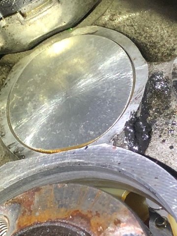

Fixed. The PCV breather was hosed. Replaced it and the valve covers with the updated design.
Also had one of the crank case journal plugs pushed partially out of position.
What a ****-Show.
