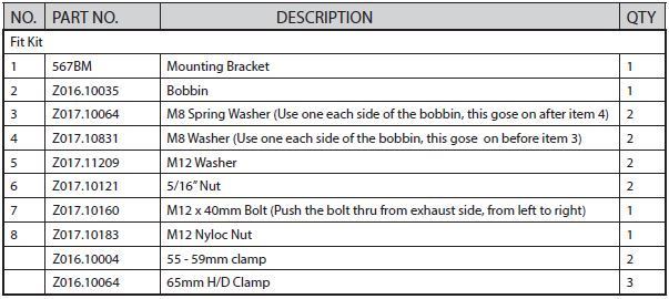

The Milltek exhaust should have an additional hanger that bolts into the rear differential. It uses 2 L type brackets with a bushing in between. It should be on page 2 of the install directions. If this is installed and you are still having contact with the heat shields I would contact Milltek directly, they are very friendly and quick to respond.
EDIT - Apologies, I confused this with the Scorpion exhaust. Perhaps you can try going to your local hardware store and replicating what scorpion does. I plan on doing the same if I have issues.
