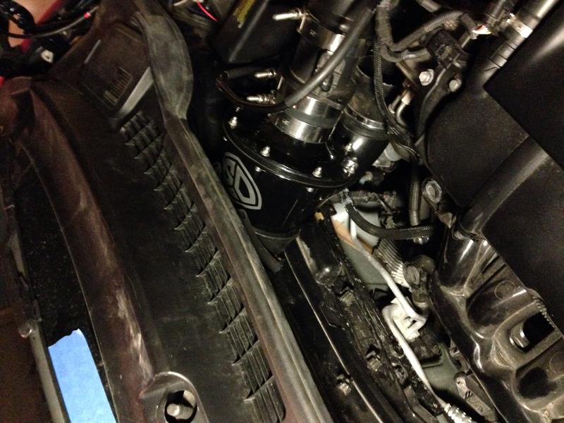

Just checking to see if anyone has tried to put a DOS v1 intake into a countryman.
I know they make/made a v2 but want to hear about the v1 being fitted.

Well I got it in my Countryman. Need to fab a cleaner trim piece and new OEM intake hose, but this install is very doable with a few extra parts. I am not sure how much movement is needed.
I had a nice fit but made it larger to allow for some engine twist.
I'll pick up some parts tomorrow but it seem fine now. I look forward to see how the temp compare to my previous CAI.
I'll post more this weekend nice it is all purdy

Wow. The DOS intake is a loud intake. Plenty of turbo noises
Need to run some additional test but it seems to run cooler then my previous open filter setup.
Still seem to have a buildup if heat after restarting the car after a drive. Not sure if that is normal or due to the install.
I ordered a few bits to seal up the OEM tube connection and firewall.
I am not sure why they added a OEM connection to the filter as it doesn't seem to be needed.
I have a FMIC and my temps driving are maybe 1F-2F higher cruzing around town.
Highway it is 0F more.
After I restart the car after a drive the IAT is 20F more. This is what I need to look into.
It cools down quickly but am not sure if this is "heat soak" I keep reading.
Cheers

FYI, The OEM intake hose works with out too much effort. From Mini the hose is oval shaped.
I reshaped it to be round and the DOS intake slides right in.
At first glance it looks like it would never fit but it reforms to a nice circle.

Yes. When I had my DOS V1 intake I inserted a 4" long piece of 3" diameter (I think) polished aluminum at the end of that ovalish OEM intake hose. It helped to round it out and made clamping the silicone coupler much easier so you didn't have to worry about the OEM hose crimping from tightening the clamp.
Looks great man. If you don't mind me asking. What did you use to seal around the cone end of the intake that sits in the bulkhead? Looks like you have an extended piece on there in the pic.

Thanks for the tip in the OEM intake hose. I need to try that and see if it improves the install.
I did use a rubber adapter. It is snug fit (no clamp) and is about 3"-4" long. This is just enough to extend into the bulkhead.
I grabbed one from work and can see where they got it. I saw it a few weeks back and snagged it to try out.
I have some small gaps around this adapter but nothing major. I doubt much engine bay heat is getting sucked in. It is still much easier for the air to come from the bulkhead side or the OEM intake tube.
I do have a solution to fill the gap and seal off the DOS intake at the bulkhead. I'll mock this up over the weekend.
Over all I am happy with the install. I need to get use to the sound. It is much louder then the CAI I previously had in there.
Once I figure things all out I might buy a new bulkhead and recut some cleaner holes I had to make a few tweaks in the hole location but it looks mostly fine.

When you say "adapter you snagged from work" are you talking about using that to mate with the cone end of the intake housing that goes into the bulkhead? Will the intake reach I to the bulkhead without this "adapter"? I'm curious as I've decided to build an intake similar to this now so any tips would be great. Hope you don't mind my questions. Thanks!!

TV, the adapter does attach to the intake end which goes into the bulkhead. I'll check tomorrow to see how big the gap is without the extra rubber piece.
I also have some parts coming in the mail which should help clean things up and drop the sound level down some :-)
Let me know if you have any other questions.
The hole I cut is lower thenI would if I was to recut again. Not too bad but off a bit.
