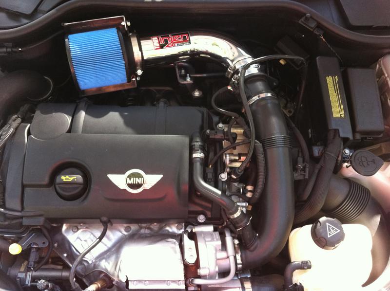

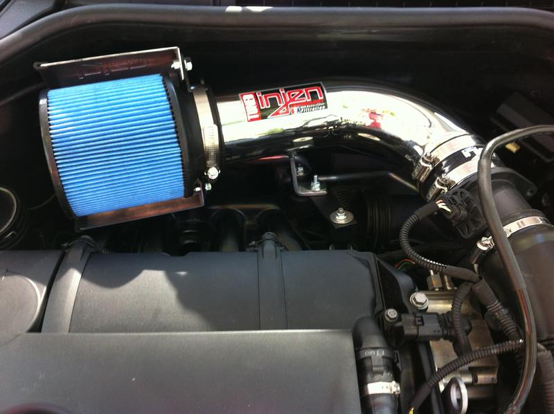

Just wanna share...Injen CAI installed on my 2011 MCS....what you guys think?

That's not really a cold air intake, but other than that, looks good!

It looks cool, but I'm worried about the outside air inlet. Its looking like the sheild is angled up aiming where a hood scoop would be, but we lack that. Your inlet tube is below and floating, so you'll be relying on the air collecting in that cavity.
I agree.
Is there a way you can turn your heat shield 180 degree?

x2, and based on the embossed logo on the heat shield that is facing the wrong way, I believe that injen's install sheet would confirm this. (But then you couldn't see the fancy blue filter ). But it looks good!

This is a MCS...not a CMS, so there wood be a scoop feeding the intake, correct!?

I think that's a typo, otherwise the thread was started in the wrong forum.
