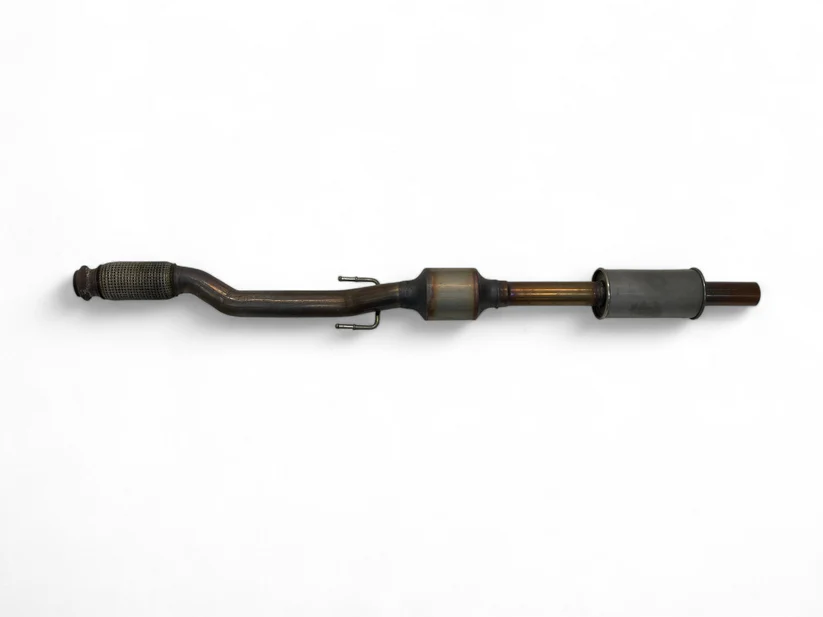

No, nope, wrong. The secondary cat is NOT fake or empty or a "dummy" cat.
Take a look at this picture of OEM stock mid pipe:
In this picture, the left side is where it clamps to the down pipe. (For the OEM system, the primary catalytic converter is in the down pipe. The cat in the down pipe is monitored for engine operation by the two O2 sensors.) In the picture above, exhaust flows from left to right. The right end in this picture connects on to the rear muffler. Again, moving from left to right, the components are as follows: flex pipe, secondary cat, resonator. The resonator is a flow through device, and is "empty" when looking through it. The secondary cat is NOT empty, but has catalyst materials inside, just like the primary cat in the down pipe. If your secondary cat is "empty," someone did something to it - either replaced it or hollowed it out.
oh shoot, I think the secondary cat must of been cut out, It must be the flex pipe off that I took off. What is the function of this piece?

The flex pipe section allows for movement of the exhaust and to prevent any cracking.
