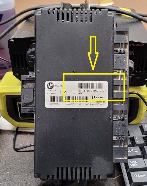

As long as the serial/part number matches your old one, NO PROGRAMMING is needed. However if you can't find the exact same one with the serial/part number on E-bay, then programming is needed which any import repair shop that has a thousand dollar scan tool can program the FRM module for a small nominal fee. As for getting it out, it's quite easy as you need to remove the kick panel from the left footwell right by the hood latch release and disconnect 3 harnesses..... Let me know the end result as I am curious to find out.
This is the serial/part number you need to look for in order to avoid programming
