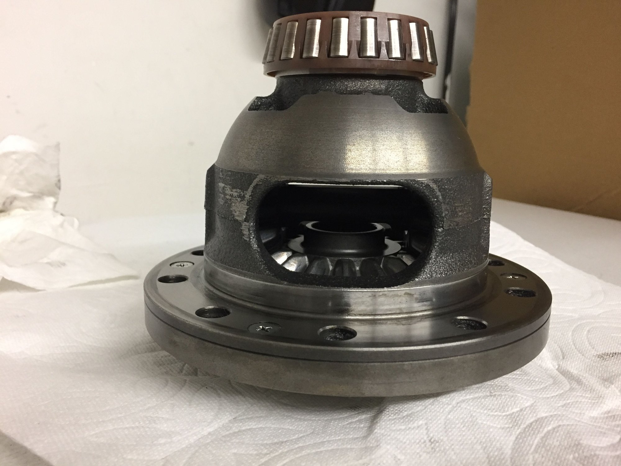

Differential Pics
Here are some pics of the differential. If you have a moment to assist me to identify this part that would be terrific. LSD or Open?

This is a open diff, came out of my 05 r53, I replaced it with a OEM lsd
https://photos.smugmug.com/2018/2018...2252664-X4.jpg

Thanks. Looks a bit different than the one I pulled out of the trans. Well, the fight will be on when I take this to MINI. BTW what are the numbers on the reverse side? It's an R53 however, the part could have changed.
I'll let Mini prove to me that what I extracted is an LSD. Love the acronym. It meant something different when Mini's were mini.

That is actually the factory 25% LSD. It looks like an open diff, but it is the actual factory LSD.
I would replace with a Quaife as it works much better.
