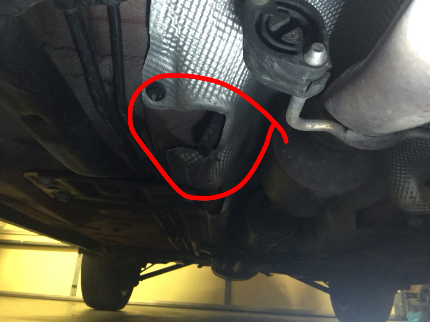

Anybody know what this is??
This Is a little rubber piece under the passenger side of the car by the heat shield, there's a slot in it that looks like something went into it. Thanks!

I believe that is the A/C condensate vent/drain tube.

Yep.
Plug the slot if you want water filling up the heater/ac housing
and sloshing into the passenger compartment in the summer.

Okay, good. I noticed my heat shield was bent right next to that and got worried
