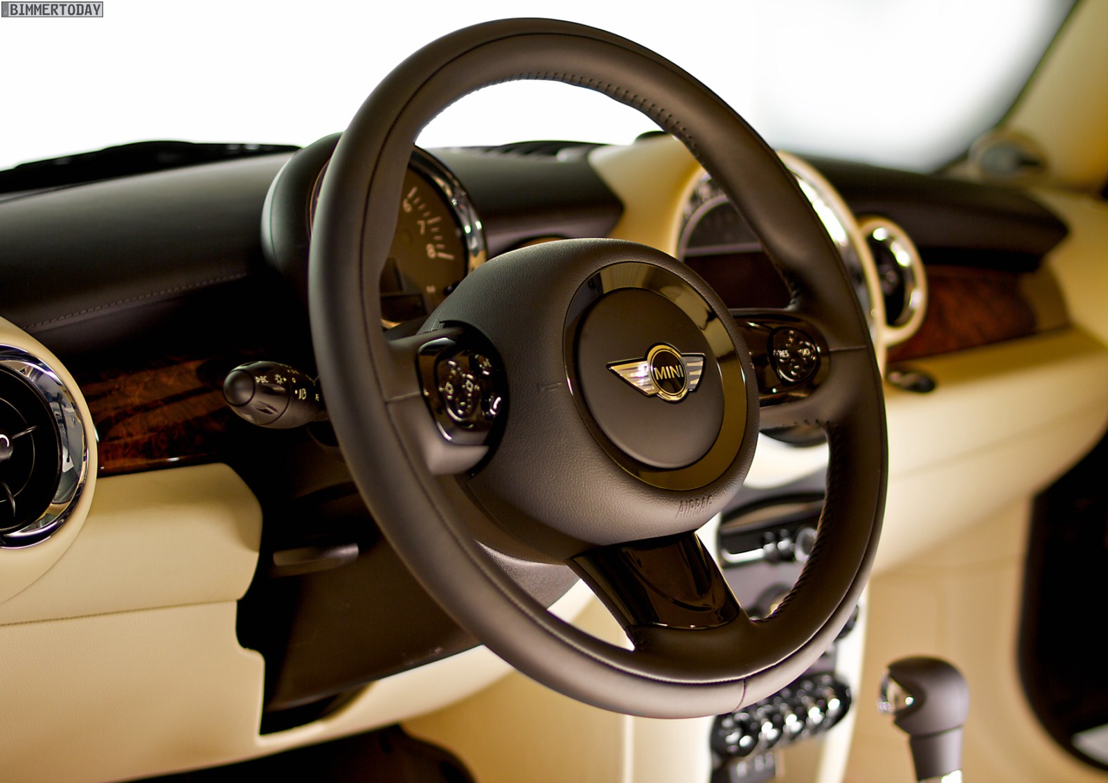

Driver's Airbag
Can someone tell me how to get the airbag off. I see the youtube video's and it should pop off. I have tried flathead, phillips and torque drivers and have only manage to pop part of the airbag loose. I don't want to pry to hard so I don't break anything. Thanks

For the R56+ airbags its from the bottom to press the tabs spring back and thus the airbag removal, don't forget to discount the battery before anything.
