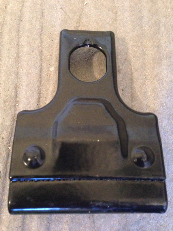

Here is what the bracket looks like.
Attached Thumbnails Installing Thule Roof Rack on R56-image-966698244.jpg   Installing Thule Roof Rack on R56-image-3457280428.jpg

So, just so I understand, are you saying the bracket hooks up under the plastic strip and then slides into the slot (that I have exposed)?
If that is the case, then my bracket is too wide for that.

I just measured everything. The bracket is exactly 7 cm wide, but the slot is just about 5.5 cm.
