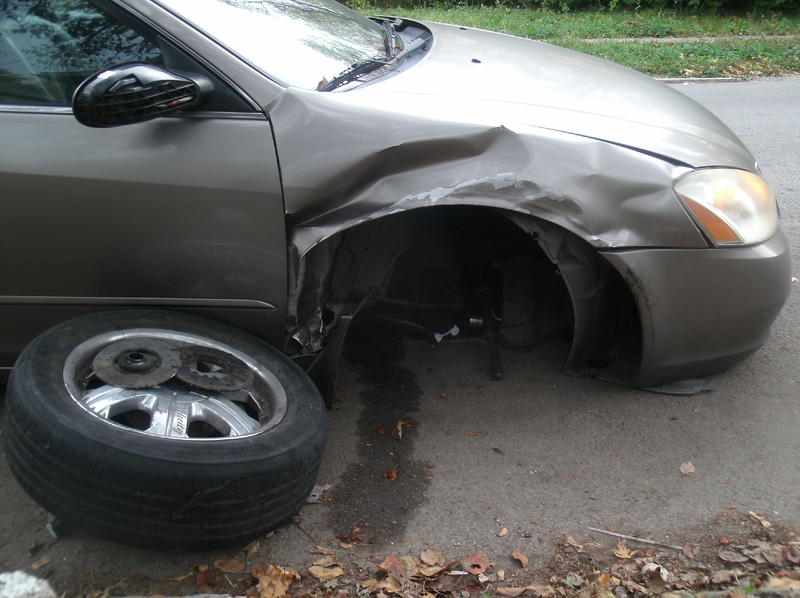

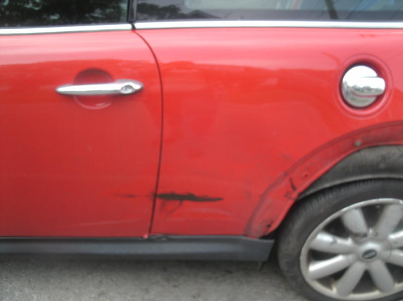

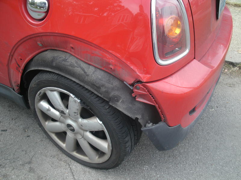

The silver car in the picture hit my parked 2007 Mini Cooper S. The above pictures are damage to both of our cars. They moved my Mini about 4 feet when they hit me. The cop estimated that they were going about 50 to 60 mps when they impacted my car. Do you think that my car is a total loss or do you think it can be repaired. Also, the insurance company is wanting to repair my car (if it can be repaired) with comparable parts. Do they even make comparable parts for Mini's? Any advise or opinions would be nice as I am a nervous wreck thinking that I might have to get rid of my Mini and drive the spare Kia Rio that has been sitting in my back yard.

Oh yeah that is her engine block on the ground.

I would figure that your 07 cooper S would need $7-8k damage to be considered a total loss. Looking at the picture, I doubt that is the case. It is a good sign that your door gap looks good, if it was not even (either the door sticking in/out compared to the quarter panel, or if the gap was smaller at the bottom than the top), it would indicate that the door was shifted compared to the body.
I would think that your rear control arm and strut assembly would be replaced. Same for the wheel and brake assy, after everything is inspected. It appears that the wheel was hit, so I would make sure that they also inspect the control arms and wheel bearin assy. Like others said, they would likely be replaced with used parts. Make sure that they do an alignment on the car to confirm that all is OK with the suspension.
Body work will not be too bad, straightening existing panels and repaint.

The adjuster just left and deemed the car a total loss. I am looking at 2005 Mini Cooper S to replace it.
