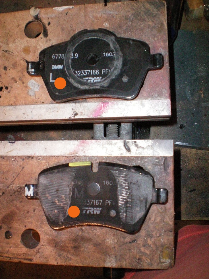

When I installed EBC yellows, I found that the front pads have little posts on them to enforce location - one goes on the inside of the rotor, one on the outside. If you install them swapped, the posts will interfere with the piston on one side and the pad holder part of the caliper on the other. You can install them swapped but then the pads will drag on the rotor when you put the caliper back on because they effectively make the pads too fat.
See the picture here: http://www.waymotorworks.com/ebc-yel...rake-pads.html , the pad on the front right with the posts toward the outside edges goes on the piston side.
So if you had trouble getting the caliper to fit back over the pads, check to make sure that you don't have the pads swapped.
I found this out the hard way, I got it right on the driver's side because of the pad wear sensor, but didn't realize it mattered on the passenger side until I couldn't get the caliper back over the pads.

ah
good memory on that one and it is true, the difference 'tween the inner and outer pad is subtle but MATTERS
and not unique to EBC pads. Here's the OE front pads from my 07-S which I took off for EBCs but held on to as spares

you can see the wear pattern from the piston and outer caliper ... the OE pads are also marked L and W forming a pair but I have no idea what L and W mean! Note the little black buttons along side the 'TRW' marking . . . note that if the 'inner' (top) pad were used on the 'bottom/outer' the buttons would be under the caliper contact area . . . this adds initial thickness which would probably be sufficient to make the pad hard to reassemble and bind. IF used for any length of time the pad would not be sitting flat.

I had both inners on one wheel and outers on the other. That's what made the wheel lock!
