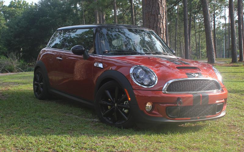

Had the JCW Suspension from Day of purchase
Enough drop for my taste. No vibrations, and perfect driving conditions in the
twisties

Roxspin what are you running?

Jcw
JCW complete suspension package. The one that comes w/the red springs...

Then you want the JCW kit. Pricey but just right for height and performance over stock and sport suspension...
