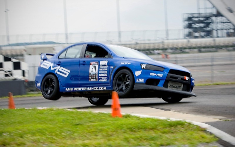

Try two wheelin.

FWD cars on stock suspension lift tires. It's just a fact of life.
The car that won GS this year at SCCA Solo Nationals.
Lots of RWD cars that generate lots of grip will lift the front tire on corner exit.
My wife driving a BSP car.
With modern tires and suspensions some cars are generating so much grip they are getting up on two wheels. DSP is getting to that point.
