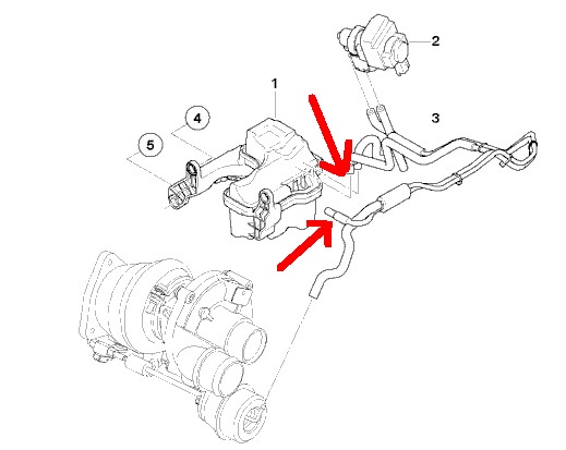

You most likely have a vacuum leak. I cleaned my valves and in the process one the the vacuum lines that was deteriorating came loose. Ill try to find a schematic of where.

There is a vacuum line that runs from the wastegate area to the reservoir under the intake manifold. There are short rubber lines on both ends and a hard line in the middle. The rubber lines are only a few inched long. Both sides of the rubber lines on my had gotten "gummy" and wouldn't stay on and I had no boost. Once I replaced the 2 small rubber ends everything worked fine.

I figured it out. I pulled off the front end and took off the head shielding. The gasket between the turbine housing and the down pipe had blown out. The gasket was catching the actuator! Thankfully the turbo seemed good with solid bearings and no shaft movement. The waste gate itself looked good and functioned smoothly with the actuator holding vacuum. The cat looked nice and clean as well.
It seems like it had been like this for awhile. The car was in a front end accident, whoever fixed it must have re-used the gasket when installing the new turbo. When I dropped the exhaust to lower the subframe the movement must have traveled up to the gasket. That has to be it!
