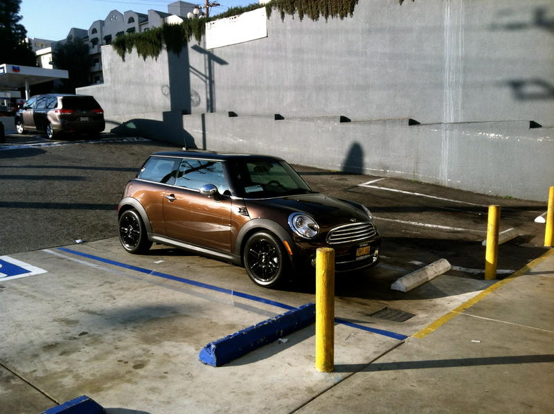

Thanks!
Thank you guys! I am sorry it took me a while to reply! Xmas break, you know!
I totally get what you all said. When at a red light, it does only move to the right but as I'm driving, I can tell the left headlamp moves as well and it makes perfect sense to avoid blinding people. I hear so many people hating us because of the intensity of the Xenon bulbs, I slightly feel better thinking we're not deliberately blinding them at the stop sign! haha
So far, I LOVE the car. It has this very impressive solidity feel to it, I just feel like I'm driving a tank and I am used to a MBenz SUV. I also feel like I'm driving from the inside of a cave with the anthracite headliner, it's such a cozy feel I seriously could move into my Cooper.
I'm seriously a happy camper!
