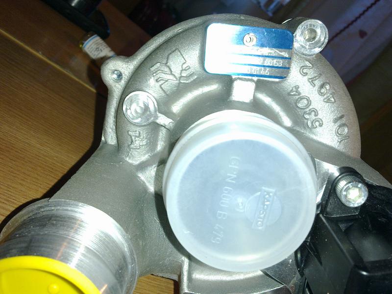

My turbocharger just came today (see the picture), now I am waiting for the Forge intercooler, and for the decat downpipe I will go for OBX (I saw one on Ebay).
