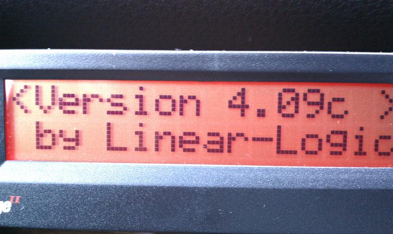

Yes, you must have the latest firmware. You can send the unit back to them and they will do the update....if you ask, they will also load all the new codes as well!

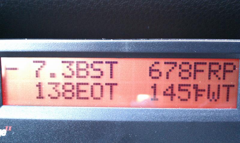

Just because I know you're gonna ask......
You can see the EOT and FRP shown...these are at idle for FRP. The EOT is after I've driven the car for a while and its been sitting for about 2 hours.
Attached Thumbnails ScanGaugeII in your MINI Cooper-imag0039.jpg   ScanGaugeII in your MINI Cooper-imag0040.jpg
