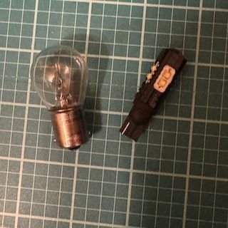

I thought I'd found the PERFECT backup light LED upgrade on Amazon. Filtered on my vehicle, and listing had specific application to R55 Clubman.
Except - it's not the right base at all. So, returning. Unless the bulb has another use somewhere else on the vehicle. (Vague descriptions says "backup light, license plate light, etc. etc.) That seems dubious, though, especially since I picked a super-bright one that probably would be out of place if there's somewhere else it fits.

But there's no "load resister" included and the bulb clearly doesn't fit the socket. The originals are P21, the listing mentions 921. I guess this is BA-15S base?

That bulb they sent you could MAYBE be used in the upper front fog light position, but may be too big to fit in the housing...
The reverse light is an 1156 bulb.

This is the bulb you need. Amazon is the wild west for MINI parts and fitment.
https://www.ecstuning.com/b-ziza-par...r55ledrevktkt/
