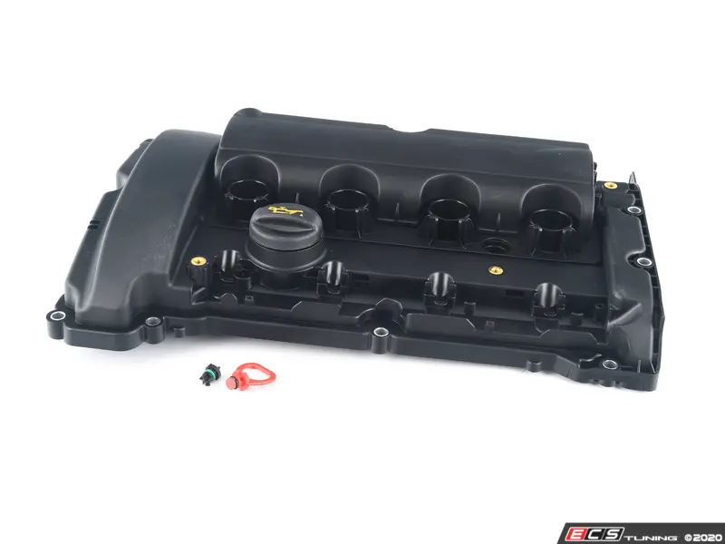

Nope, they are exposed and moisture gets on them in the center or if you wash the engine bay, water collects there. Use a blower to blow it out. I never really liked the design and since its off another car (PSA) i think it looks like it was never finished
PSA Peugeot
https://www.ecstuning.com/Search/Sit...h/11127646555/

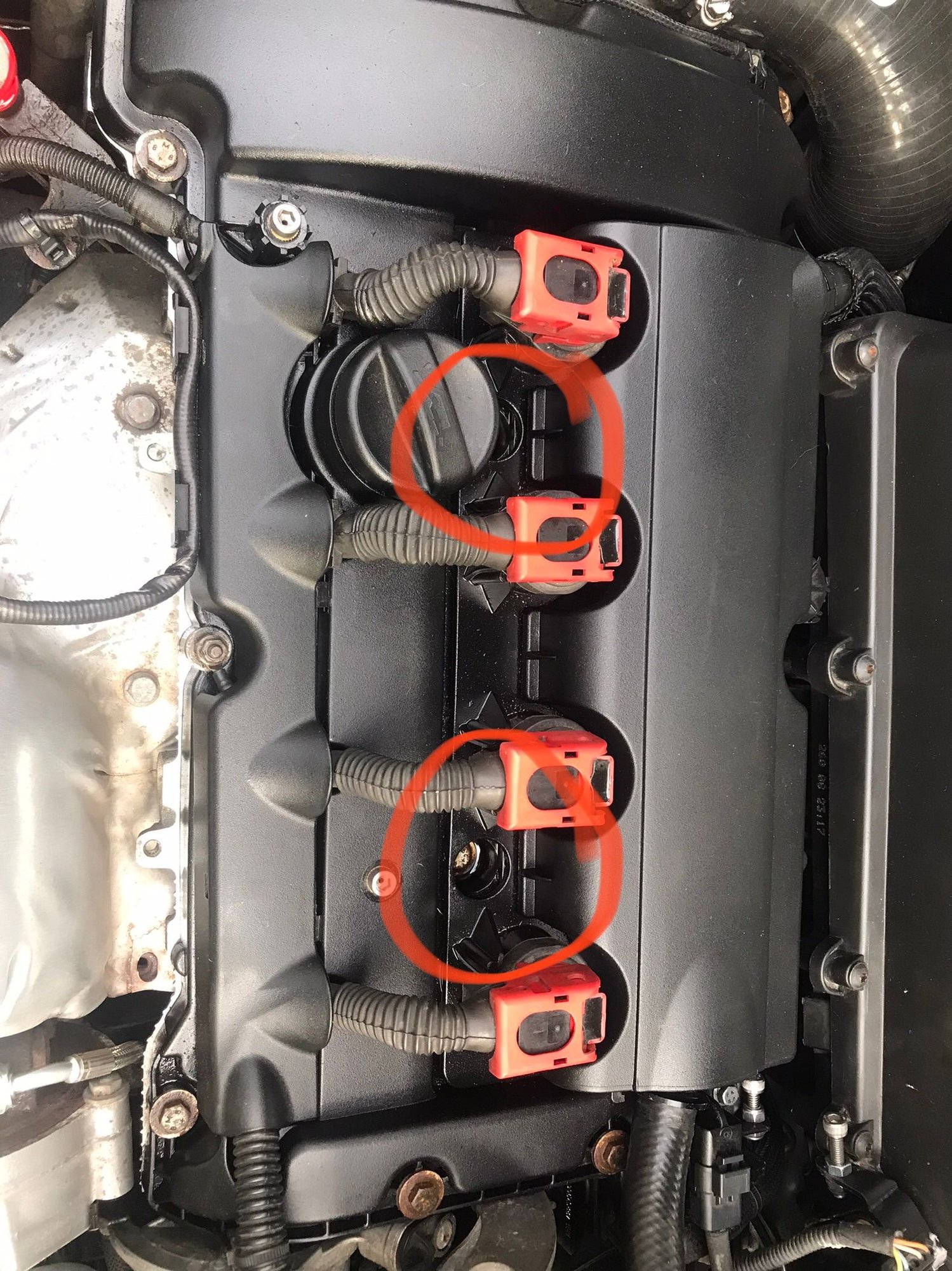

Yes I refer to the two bolts that are in the wells, between IGN coils 1/2 and 3/4
I like to wash engine bay and it drives me mad to have pools of water there.

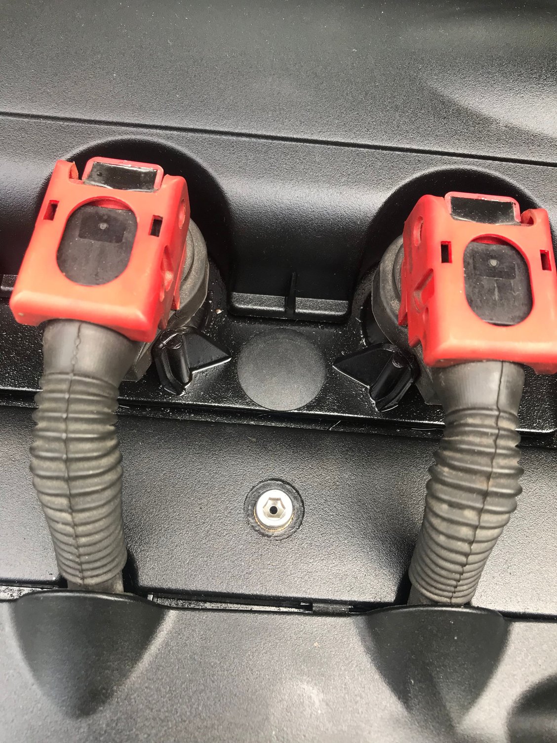

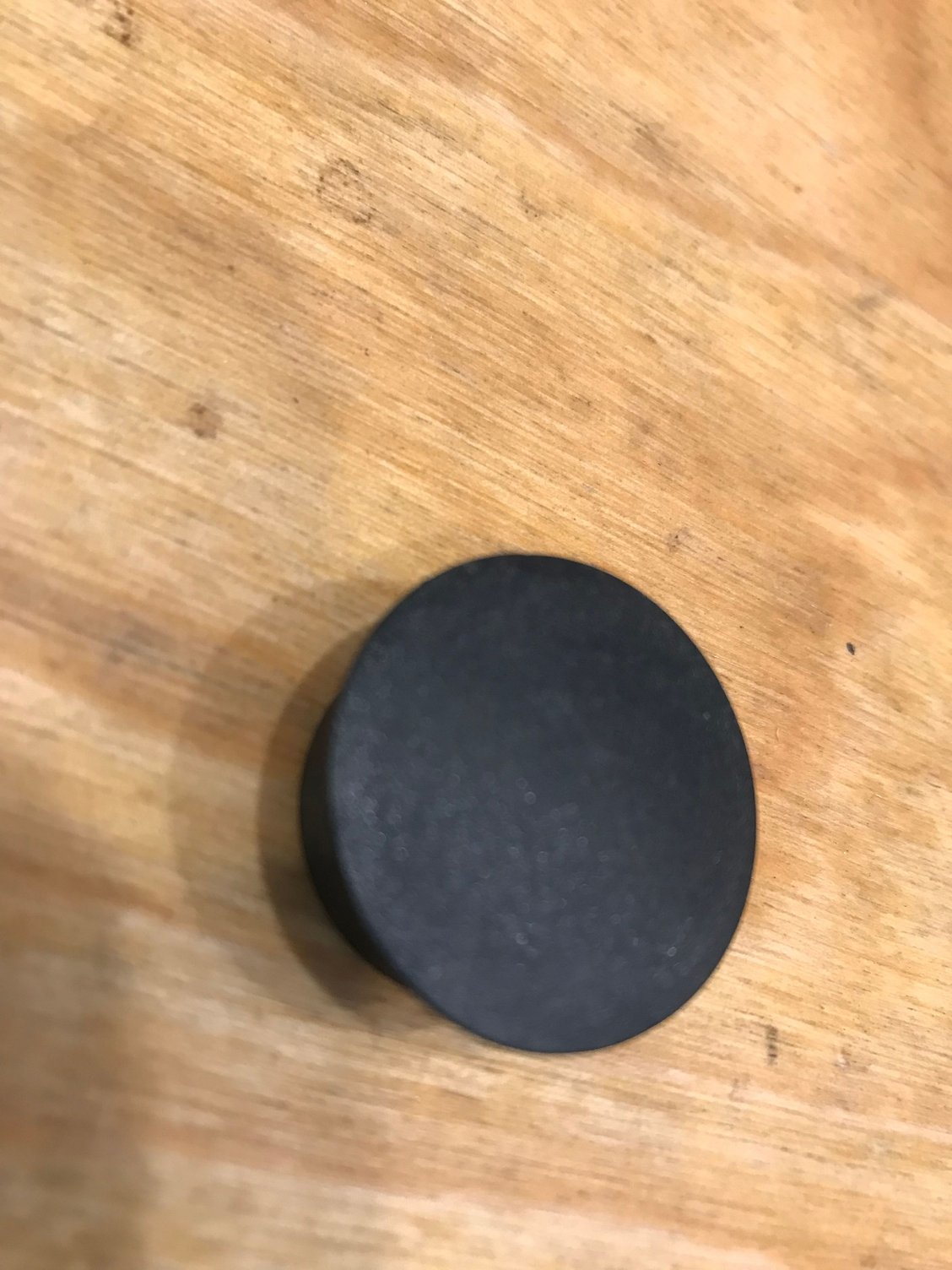

Well peeps , I found in my elec stash a black plastic knock out cover , 21.6 mm OD, tabs are about 23.8ish …. Fits right in… now I’ll find numbers so we can order … but any electrical wholesaler or American Home Depot etc … cheers !
outside of cover is 26mm plus … I’ll get a photo on valve cover

Nice! I didn’t think you were talking about those holes, but that looks MUCH better!

That's looks good a couple of times I had water 💦💦 settled in there

now THAT looks complete/good!!!
great find Bloodrider
but I just noticed, that even if we put caps on the holes, water will still enter becvause there is a large opening just beow that plasic :(

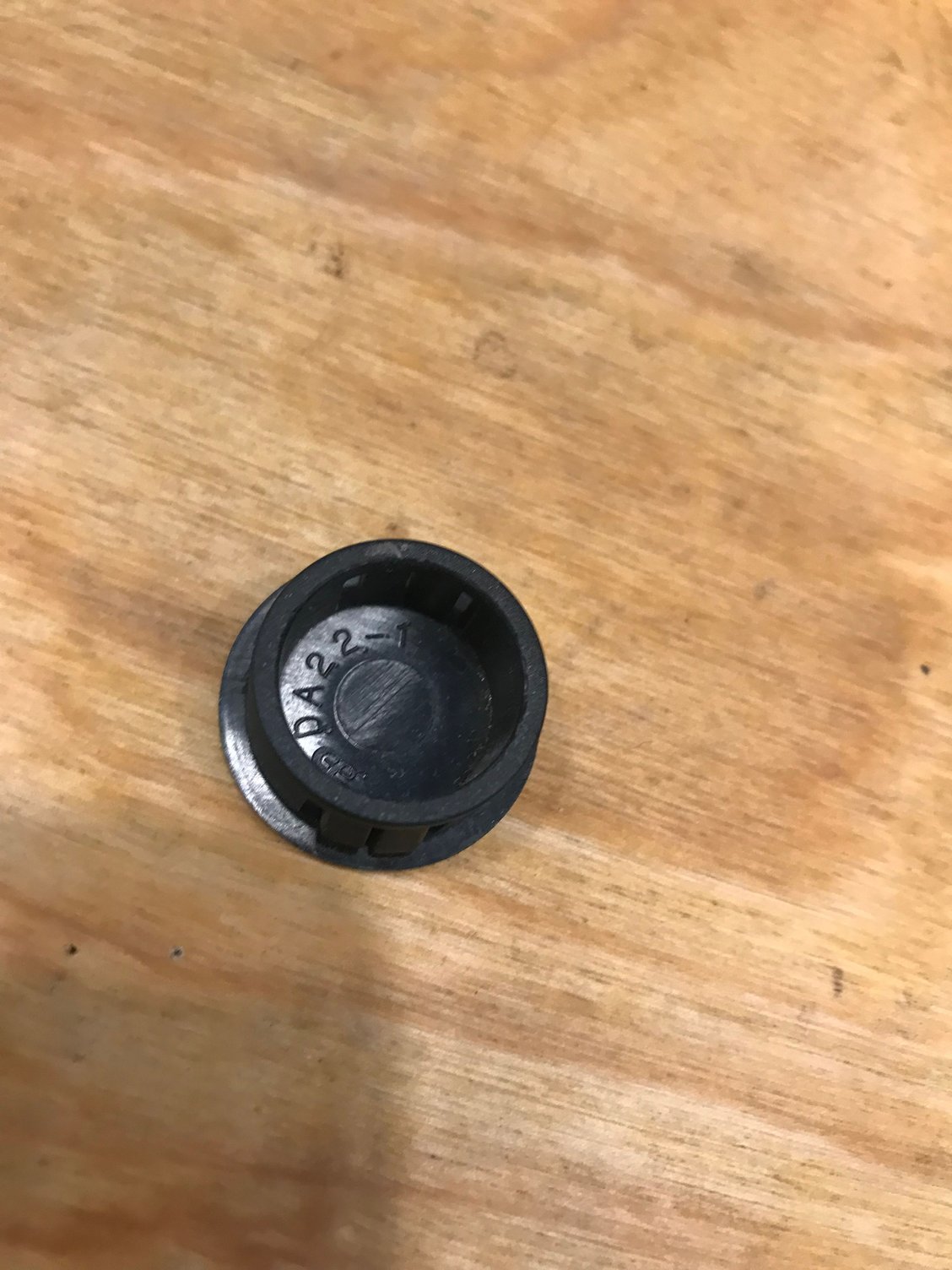

would you happen to know the brand of those electrical box plugs? I see a "number" on inside of plug but searching that shows me nothing sadly.

I just sent a link so you can find exactly what you need
I’m on the road and thought I’d help asap
cheers
Morris 22394 Morris Products 22394 Plastic Knockout Plug, Plastic, 1" Snap in Size (Pack of 10), Black

From looking at the pics you show, Bloodrider, and your dimensions, I believe that is a 22mm plug. Just like these.
