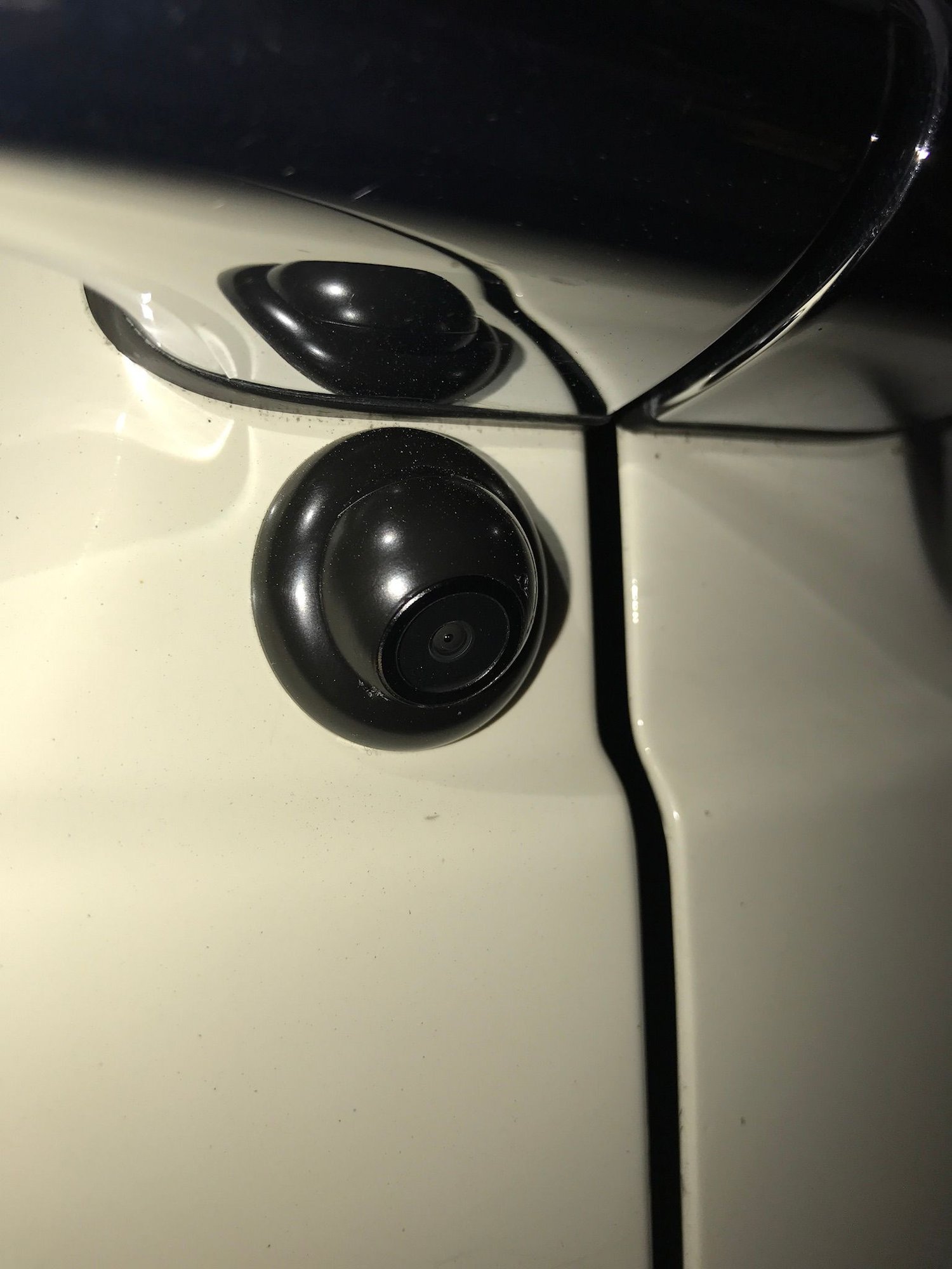

Well after having a back up camera and pretty much every vehicle I’ve owned lately whether it be FACTORY installed or I installed it could not stand not having one in the Clubman.
I was able to locate a small 3 1/2 inch monitor from Amazon along with a angle adjustable flush mount camera which installs right below the driver side handle which by the way is completely hollow below the handle nothing in the way.
Amazon Amazon
Monitor
Amazon Amazon
Camera
Worked out perfectly.

This is a very clean install/mod. Nice. How did you attach the screen to the overhead?

Just trimmed out the little vents to match the mount bracket that came with the screen and glued it in place.
One note you will need to add a relay to feed direct power from the battery and use the back up light as a trigger. Otherwise the canbus checking the backup lamp will burn out the camera. Learned that after I went thru 2 cameras.

This is an old Thread but how did you do the wiring? I have tried to do it, but the screen shows the picture for a moment, it's all wavy, then blanks out. I'm guessing it's because the power is coming from the lamp control module and it's not a steady signal.
This comment makes me suspect you're right and your power is coming from the lamp control while its testing, not triggered from the reverse lamp wire. Maybe adding a relay would be good way to get clean power triggered from the reverse light?
Does the screen interfere with the Bluetooth microphone (I assume that's what is in the little vents where the screen is mounted). I'd like to have this on my Clubman but was thinking of mounting the camera up near the 3rd brake light so my bike rack doesn't block it. I had to remove the parking sensor feed since they go off constantly when my rack is on.
