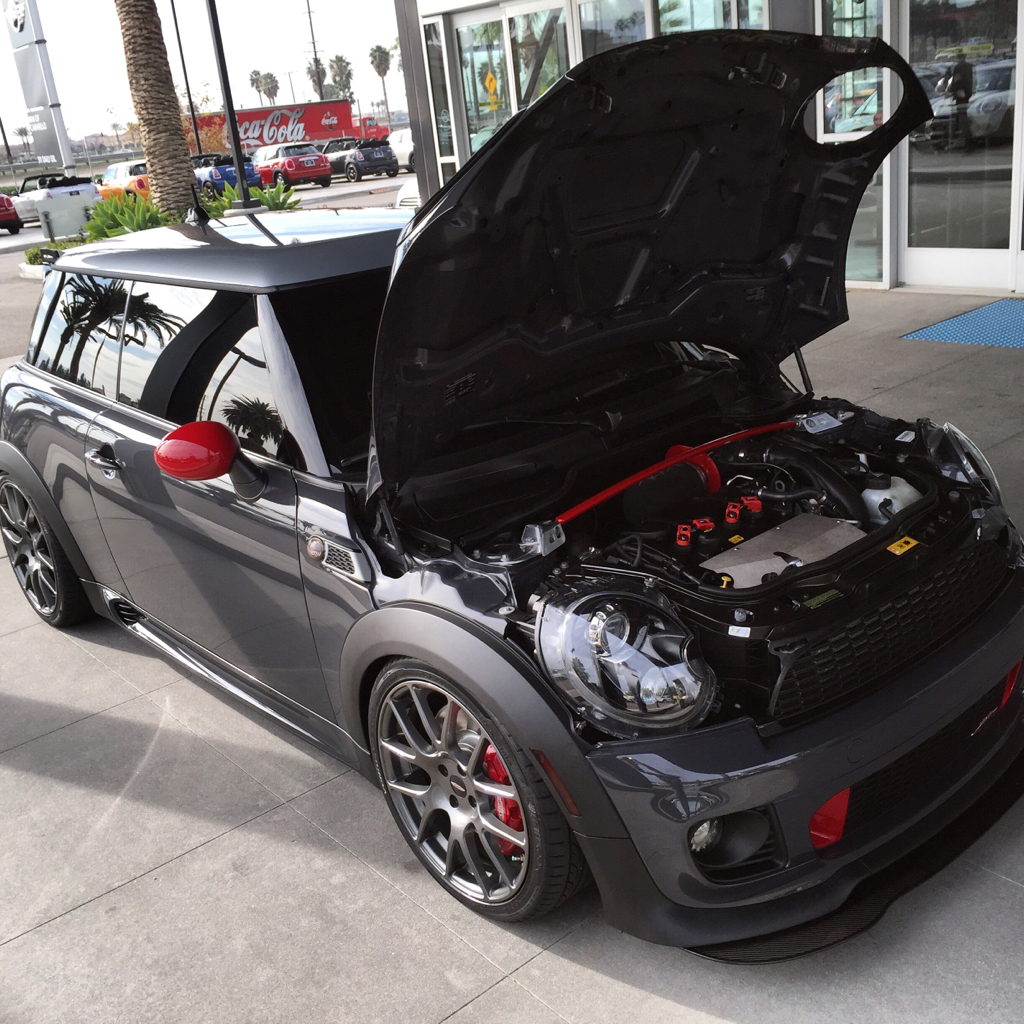

215/40/18 if you are on coilovers, you might be able to get away with 225's if you are just on a mild spring drop.
Mine with KW V3's on dropped coilovers 215/40/18 45et with 5mm spacers

Are those 8" wide?

Are those 8" wide?
7.5
